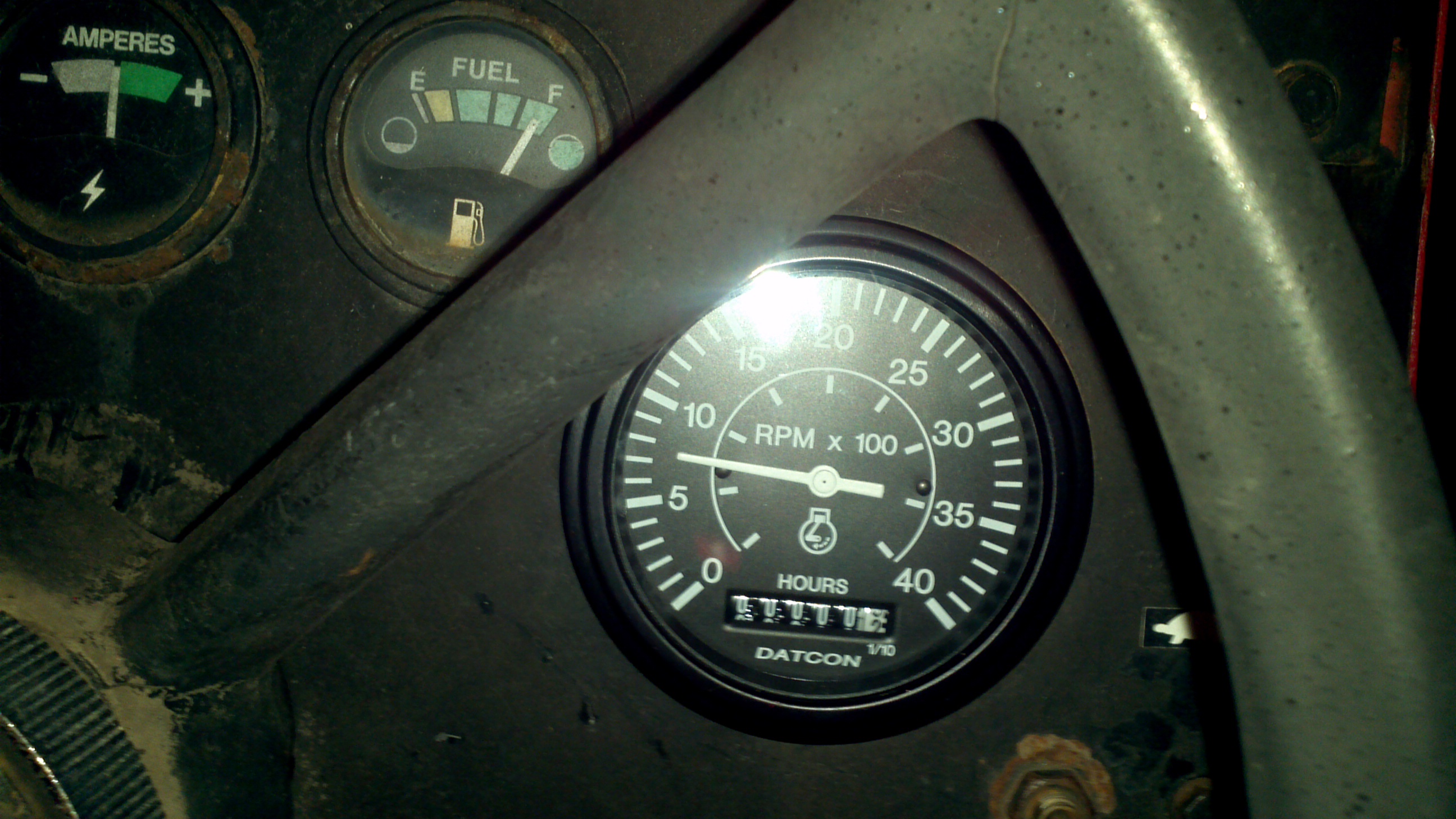

#9
It's been about two months, but I finally got around to posting some pics of my new electronic tach. I purchased a Datcon 4k (light and hours) for ~$40 from Ebay. It was pretty easy to install, but I had a heck of time getting a good reading. It was initially reading about 4 times the expected RPM. I replaced the distributor cap, coil, points, condenser with no luck. On a whim I pulled the plugs and noticed they were fouled pretty bad. Sure enough when I replaced them I started getting accurate RPM. I'm guessing the fouling was causing dual sparks based on the tach readings. On a side note the tractor now starts much easier & stronger. My next step is to pull the carb and give it a thorough cleaning as the Massey likes to run with a little choke always.
/ MF 230 Tachometer Help #10
ScottView attachment 297067
Scott, what size tach is this. I'm referring to the hole size in your dash. This sounds like an easy solution for those who's mechanical tachs have failed. What was supplied for the hookup? Looks great. Does it also come with a chrome exterior finish ring?

#11
Thanks! It's a standard 3-3/8" tach. My previous tach was also 3-3/8" so it was a drop in replacement for me. I really wanted a 3k tach w/hour meter, but I couldn't find any reasonably priced that were pulse driven which also had an hour meter . Most low rev engines are diesels so it was more common to find alternator signal (W) driven tach. It was very easy to install and connect. One positive wire to the ignition (I spliced onto a wire just behind my key switch). One negative wire to the ground. One signal wire to the negative terminal of the ignition coil. It also has an internal dash light which I connected to my light switch. Assuming you have everything set up (wires, solder iron, splicing connections, dash access, etc) I think this is ~1hr total job....but then again it took me a month to get it right! :)
It comes with the tach, mounting bracket, and instructions. It' pretty much a DATCON TACHOMETER 0-4K HOUR METER 16 PULSE. I found one on EBAY with a chrome ring. I purchased mine from another seller, but these things seem to be all over ebay. Good luck!!
