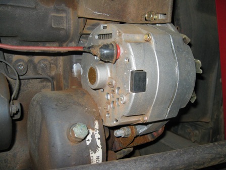

Hello,
The charge light (looks like a lightening bolt) indicator on the dash just started blinking.
When you first start the tractor, it comes on and stays on UNTIL you rev the throttle alittle then it goes off. Now, after alittle while the light will come back on and start blinking. It's never done this before. If I turn on the headlights or flashers or something, the light doesn't come on and start blinking.
What's the problem??
It has always started right up and the battery has never acted like it was weak or anything. I have a owner's manual and a parts manual but no service manual.
Thanks,
Travis

The only real trouble that I have had from my 231 was the charging system. Easy to fix with a one wire Delco alt. Best investment that could be made. Don't waste money rebuilding the factory one.

I wonder if the blinking could indicate overcharging when the battery is already fully charged?
   / MF 231 Electrical Help #7
Travis, I will find the model # and take a couple of pics for you. I also replaced the factory dummy light with a working gauge so I couls tell exactly whether it is charging or not.
and yes the factory one is from Poland. The charging system is just a weak link on the tractor. Once it is retro-fitted all problems go away.

Yeah, sound like the alternator is starting to give out. Grab the one Dirtroad is talking about for an easy/cheaper fix.

Here is what the one-wire setup looks like on mine:
It is not a direct bolt on, but it only takes very little fabrication and modification to make it work.
Sorry, there wern't any model #'s visable, but it is one of the smaller ones. You don't need anything bigger.

I went with the "NEW" option rather than a rebuilt or retrofitted. I think it was $75-$80. I would recomend going to your local alternator rebuilder and see what they have rather than NAPA.
