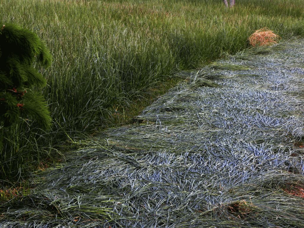

See the picture of my "test drive" of the MF31 sickle mower, subject of this thread. I guess by the looks of the results, the process was a success, and even in time to stick with my mowing schedule. Schedule is important since I irrigate on a schedule, so have to work in a cutting between irrigation sessions, and also avoid any forecast rain - this time of year, there's always a good chance of getting it rained on, or blown away by high winds.
I have to give credit where due. We're Christians, and there was a lot of prayer go into this refurbish project. In between my numerous mistakes and doubts, there were sprinkled a number of "coincidences" that resolved problems. Y'all know what a coincidence is, don't you? It's when God wants to remain anonymous!
I only did a couple of swipes today since I had to spend the rest of the day trimming around sprinkler risers with a string trimmer - couldn't see most of the risers since the grass was so tall. Tomorrow is the big day when I'll finish mowing.
Anyhow. I guess it's not the result in favor of Sodo since I won't be selling it to him for parts.:)
Thanks for all of the replies and encouragement.

Looks like it is working. how did it sound? Like it was working or chugging or did it cut real smooth? The results look good.
BTW - serrated sections will work fine for this type of grass. We always went by the rule that the more flexible the stem that you were cutting the more you needed serrated sections to hold the stem from sliding away from the section. Stiff stems like a wheat grass or wheat or alfalfa it was best to use smooth sections where you could sharpen them. Different people have different theories though so use whatever works for you!

Sounded great. One very slight bind when hand-turned that I couldn't find, but running, sounds pretty smooth.
