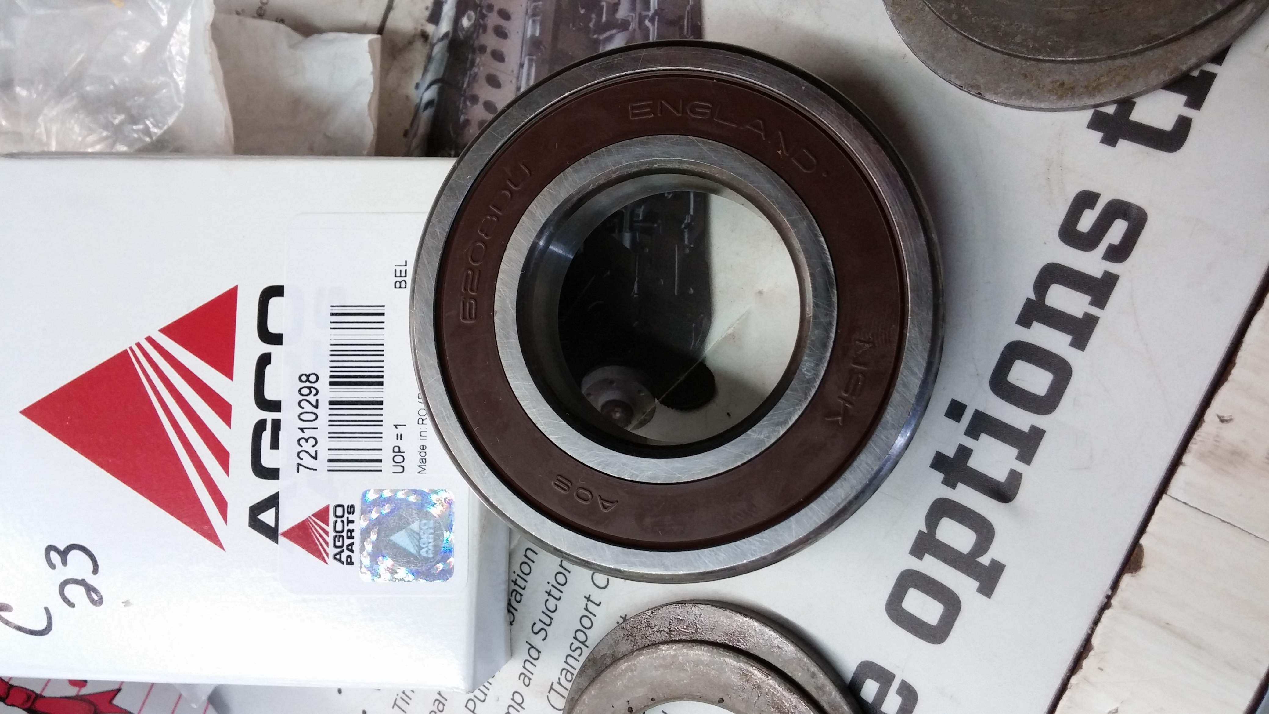

Replacement Bearing.jpgThe local Agco dealer had a replacement bearing in stock. $19.83. The new bearing is sealed and is narrower than the original one. When the new bearing is used a spacer is required on each side to center the bearing. My mower did not have the spacers so I suspect when the previous owner replaced it the bearing was not center and it had some side loading causing it's demise.

Those aren't really 'journals', they are simply bearing lands for a cartridge bearing. The spacers' main function would be to position (and maintain) the lube hole on the (narrow) bearing aligned with the zerk hole on the bearing cap. If the bearing cant get greased then that would cause the problem yer havin!
   / MF 31 Sickle Mower with Smoking Gearbox. Any diagnostic tips? #24
I see that now they've replaced it with a sealed roller bearing with spacers to fill the void left from the original design/bearing used. Looks like it may work much better.
Please show pics of assembled crank with new bearings before closing it up.

The old bearing came off fairly easily. I touched up the crank with some emery cloth, put on the first set of spacers, the bearing, and then the other set of spacers. This was all real easy, but I struggled with the snap ring. It was a real pain!
I began prepping the housing to receive the crank when I discovered what may have been a major factor in the bearing failure. The connecting rod had a 1/16"-1/8" high x 1/4" long burr on the face that mates up with the bearing. The burr was on the outer edge of the face so I bet when the rod cap was bolted up it was putting a twist or point load on the bearing. I filed the burr off, reinstalled the crank assembly, bolted everything together, lubed it, and took it out for a test mow.
After an hour and a half of cutting without any signs of excess heat I was satified the new bearing and spacers took care of the problem. Next project: replace a few sections on the cutter bar.
