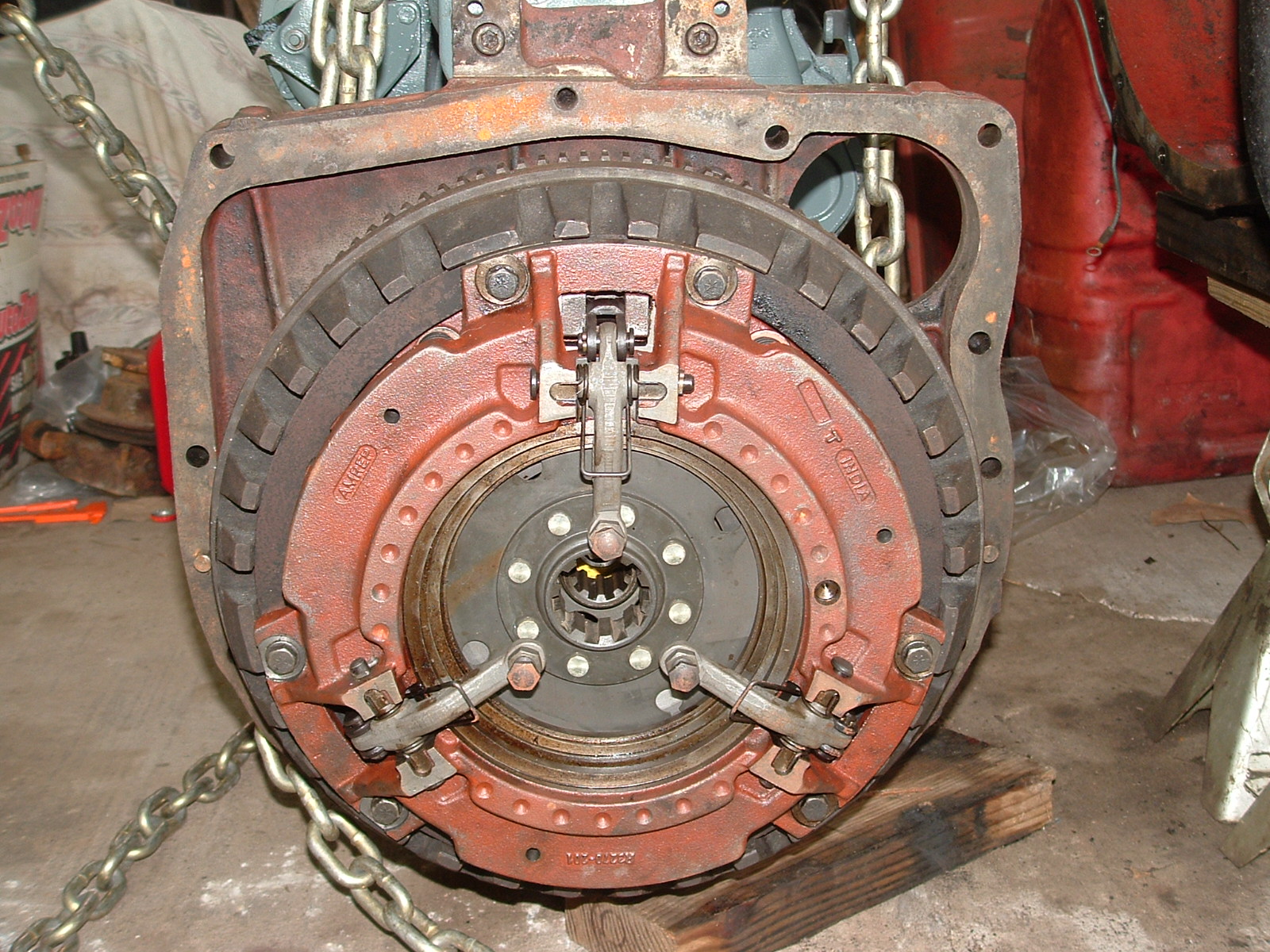

I put a new clutch in my 135 when I rebuilt the motor. I will have to look back and see where I bought it from. It was the dual clutch type. Also had the flywheel resurfaced. The original clutch was a spicer, and I wasnt to happy about getting the replacement in and seeing that it said "india" on it (see the pic). Oh well, it seems to work ok. If I recall it cost around 300.00 for the whole set including both discs, a throw bearing, and a 3.00 alignment tool lol. The reserface cost about 30.00. Like flusher said, I did the labor and saved money. Besides, I had already spent enough on the motor! Good Luck TB
