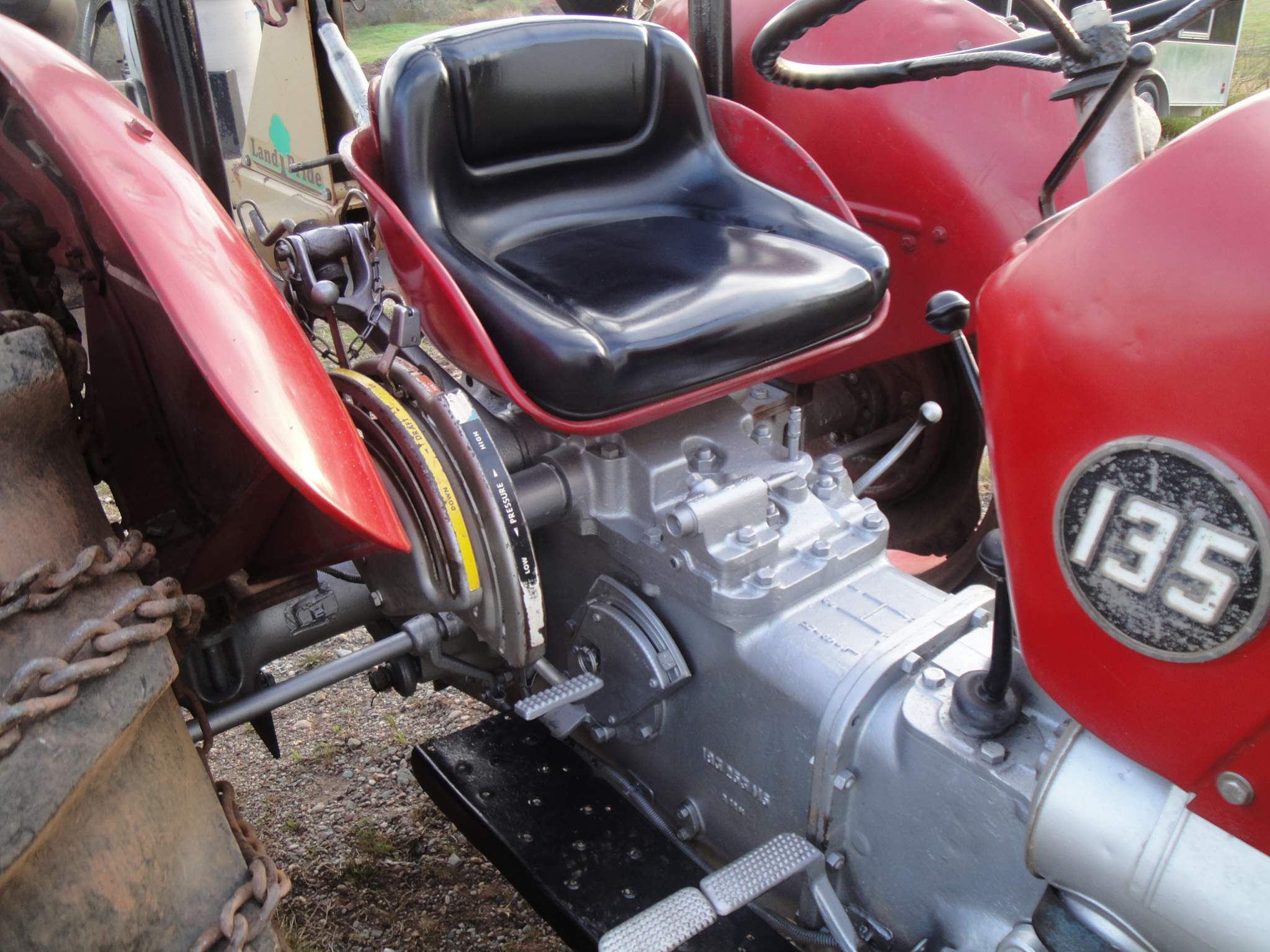

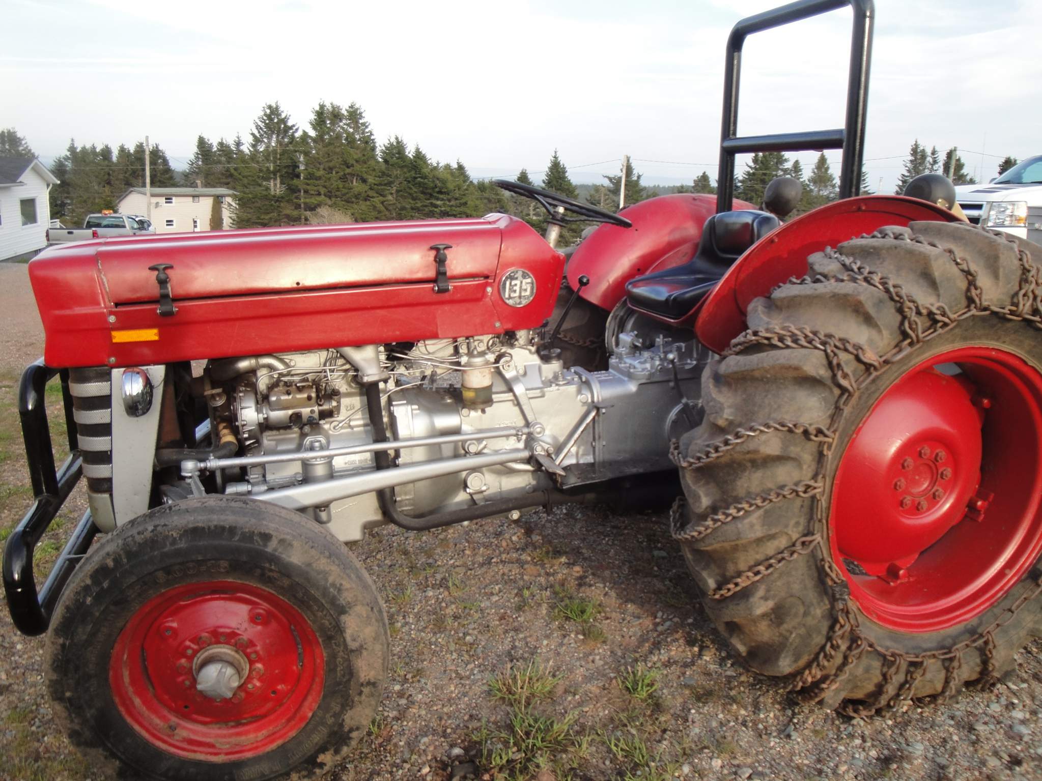

I have a MF 135 diesel and have basically rebuilt it over the past 10 years. When I first got the tractor the ring gear bolts came loose and broke the housing. I replaced the housing and bearings, etc.. at the same time. The good thing is you can still get parts for them and there are still lots of them around. They were very popular years ago and have still survived. I have replaced the hydraulic seals and needed to adjust the top link spring but that doesn't cost much. They are a strong little tractor and start good.
