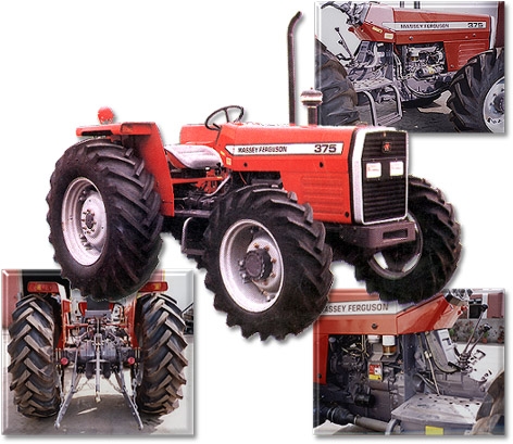

   / MF 375 #7
<A target="_blank" HREF=http://www.tractorbynet.com/forumfiles/41-197412-masseyFergusonMF375.jpg>try again memorialize MF375 pix...</A>
