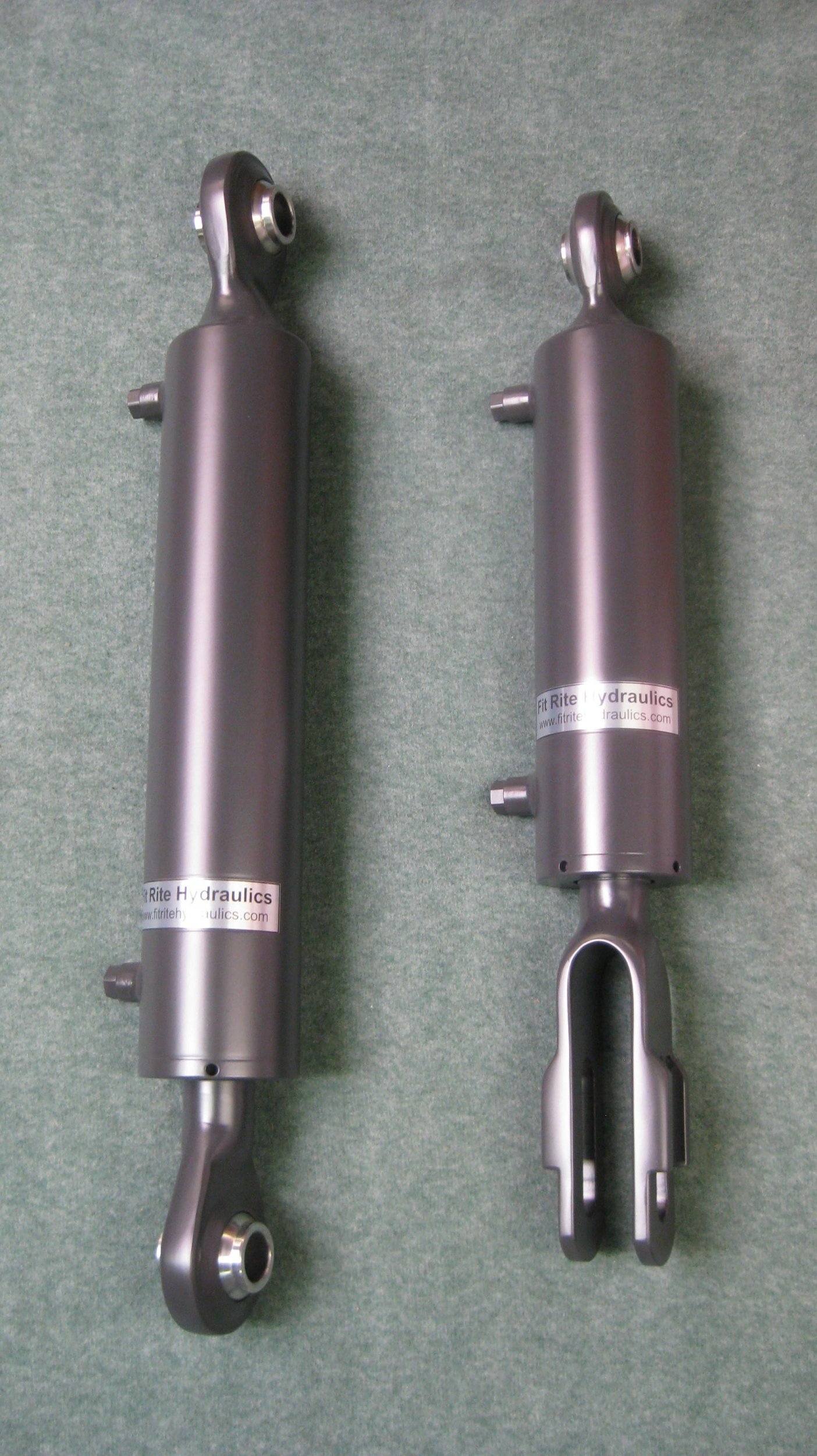

Something like these. Lead times are currently a minimum of 36 weeks.
3" dia cylinders with 1 1/2" dia rods.
I build these specifically for the Massey 47XX series tractors.
Here is the Fit Rite contact page if you would like a quote.

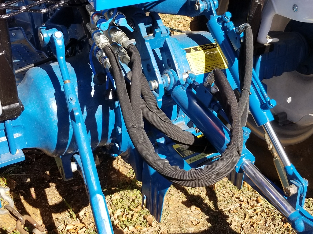

I got my T&T cylinders with hoses off Amazon. At about half the price of those above with no wait except shipping (less than a week). And mine came with the pilot locks. The blue paint is mine--They came black.
