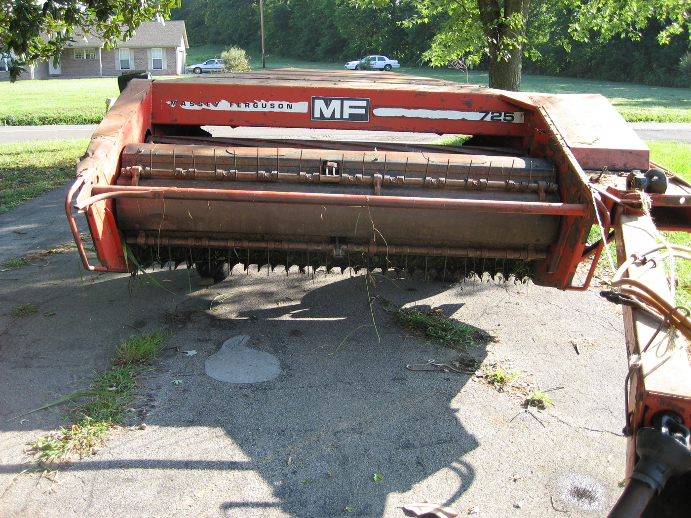

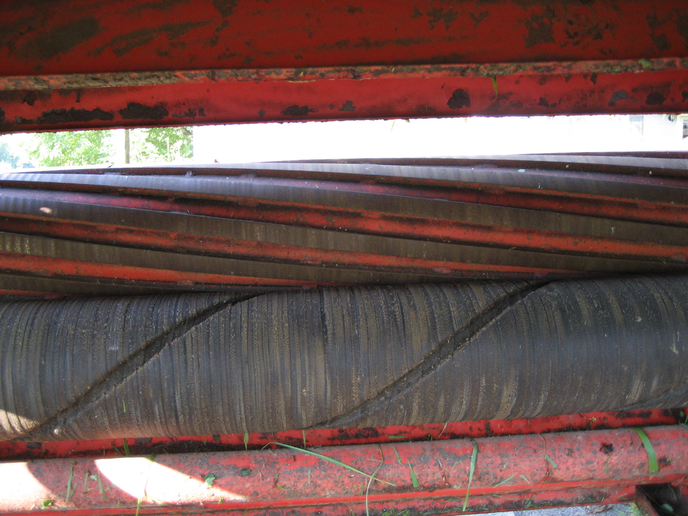

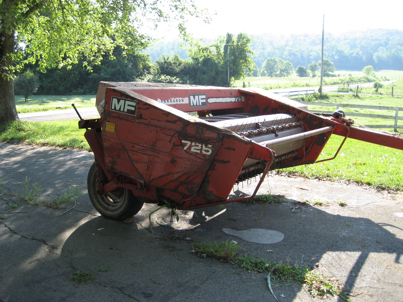

Had a chance to look over the mowers this w/e and what I saw looked OK. He had both out, ran them and mowed w/ one. Wet grass doesnt seem to bother this mower. It turns out the original owner (sellers father) was a Massey mechanic. So, I think theyre well maintained....at least to my eye. According to the seller parts are still available thru MF and Badger (original maker). I still need to verify that most wear parts can still be gotten. Both have suffered from mowing too close to immovable objects. :( These are belt driven and to my mind thats not all bad. Slippage will occur before they tear themselves apart. I think replacement belts are expensive though. The conditioning rollers are heavy duty! I think they might never wear out. One part I didnt like is the disappearing drive line (thru the draw bar). If that ever went bad I think repairs might be difficult and expensive. I would have preferred and exposed driveline. I have no idea how problem prone they might be after almost 30yrs.
Here are some pics...

from the pics that machine doesn't look 1/2 bad. granted it has its sheet metal flaws but the knife and rollers look in good shape. does the machine end of the drive line have an opening to gain access to the wobble box? if it does it looks like all you would need to do would be remove the u joint and pull the drive line out from the tongue side for any repairs or a new driveline. the drive belts can probably be had from napa by matching them to the ones currently on there. good luck, jim
