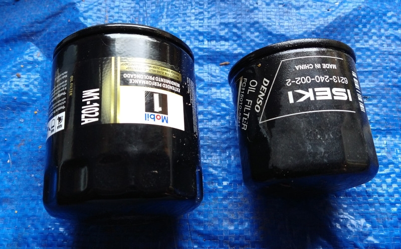

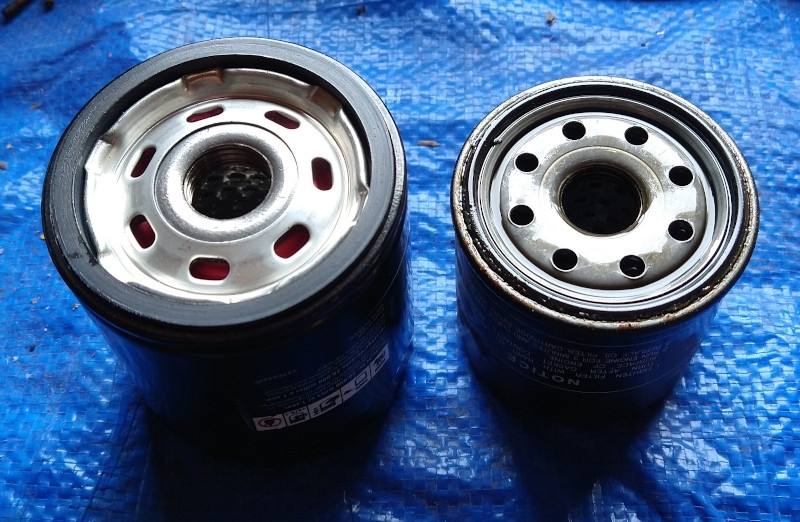

Bought a GC1725MB last year and was due for the 50 hour oil change this spring. From all my research on the web (because there's no bad information at all on the Interwebz, is there?!?) the "correct" replacement filter from Mobil was the M1-102 so I purchased one locally... and this is what I found compared to the original filter (Mobil1 on left, OEM on the right):

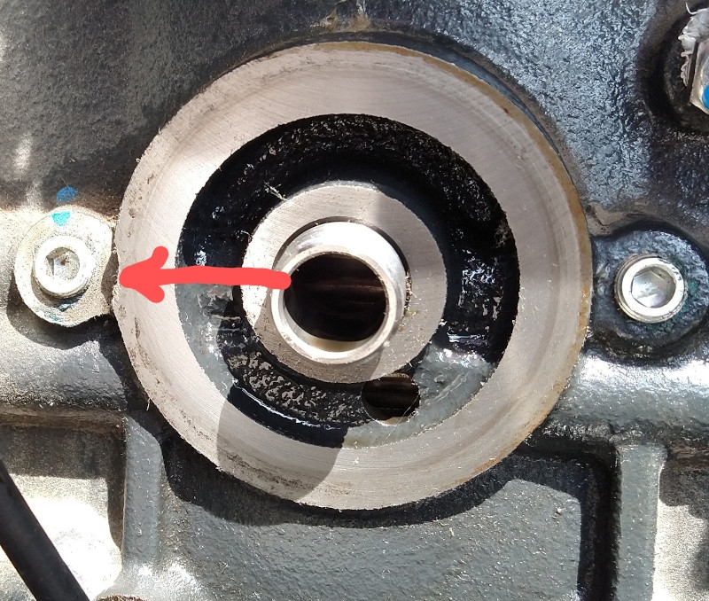

Now, the center "port" is the same size/thread so it seemed to mate well to my tractor, and it seemed to me that the seal was still mating well to the engine block. ( I wish I would have taken a better picture of where the dust/crud that had accumulated around the outside of the old filter - you can still see remnants where the outer ring is discolored, but I had already cleaned it up quite a bit. ) There is one spot that does concern me a little:
That spot looks like it could be a 'weak spot' where the filter gasket may not have 100% contact - but I used the filter anyway thinking the increased surface area of the filter material may be better for the engine if it mated well. I also wondered if the smaller filter was just a "starter" filter - kinda like ink cartridges that come with printers that are only half full. Thus far, I have not seen an oil leak or any other issues with using the larger filter... but I've been concerned. I'm a computer guy that owns a tractor - not a tractor guy that owns a computer. :)
Ideas? Thoughts? Did I do something boneheaded? I do hope this info helps other owners, though...
