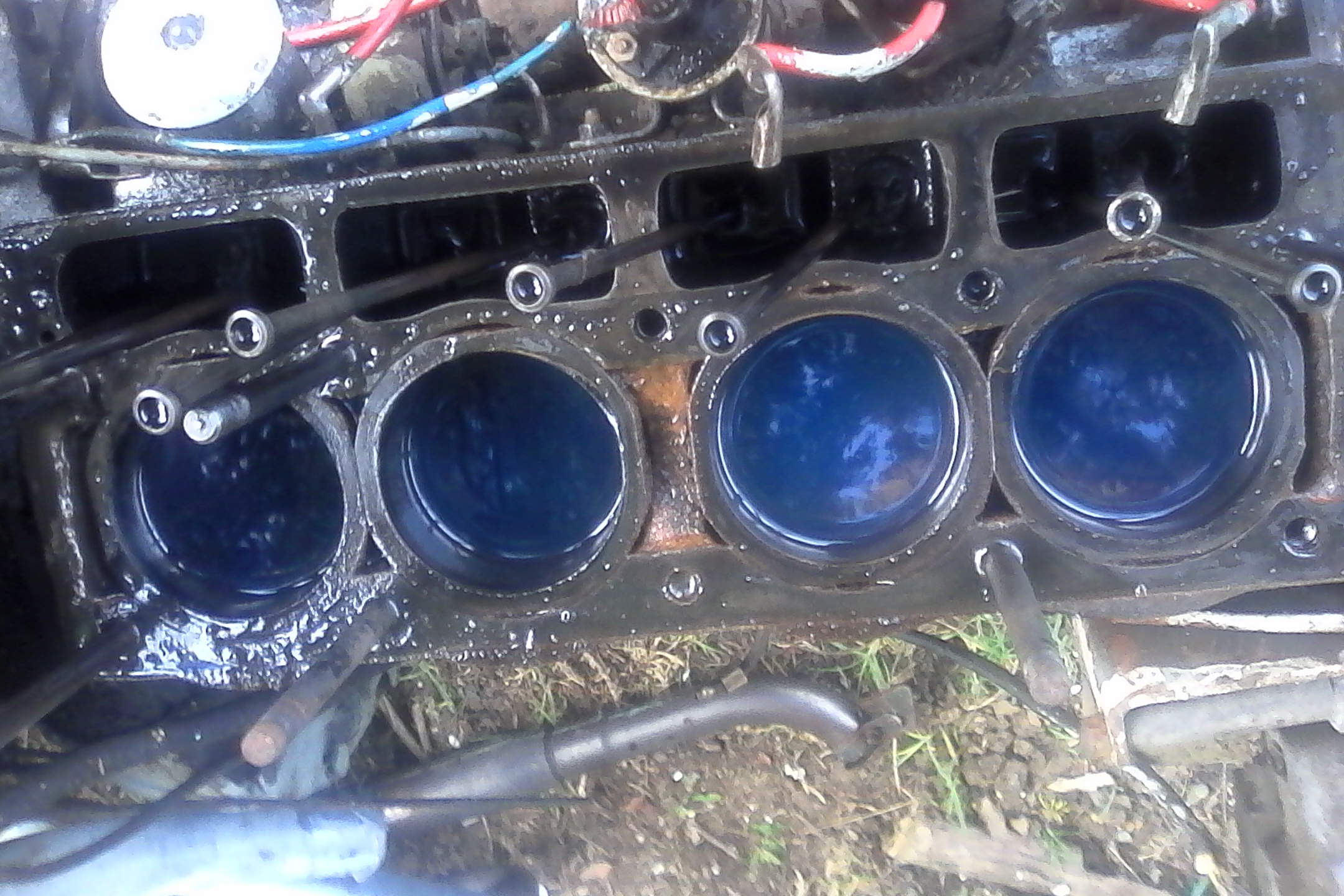

Well i got home a day earlier so straight back into it. Excellent tips thanks, i havent read those in any service manuals. I was planning on rotating the engine a few times but i probably wont now and if i do i wont venture into that without keeping those liners held down. If i had and the liner had risen i would of just pressed them back down without realising that id just done damage to a gasket at the bottom of the liner as i just didnt know such a thing existed. That would of being a notorious mess up.
First thing ive done is tilt the head and the problem cylinder definitely has the corresponding shoddy looking valve. Its like a yellow/orange colour and looks as though its top gone as its sitting further recessed in its seat. But i cant see how the top surface of the valve could of come off as it couldnt escape anywhere and its not in the cylinder. Any idea whats caused this or is it just wear and tear? It seems to be the exhaust valve. Also cylinder fours valve is going the same way so i plan to replace it too and i will do the petrol tip for looking for leaks on the other valves.
Heres the problem cylinders two and the normal cylinder threes valves
With the head sitting down the higher stem from the bad valve is clearly noticeable and i suppose that could be one way to check for a bad valve as well before removing the head
The valve in the fourth cylinder on the far left can be seen to be getting higher than the one in the same chamber next to it too. Whereas cylinder 1 and 3 valves are all level.
Oil pressure was fine a while ago but i didnt actually check that after she went poorly.

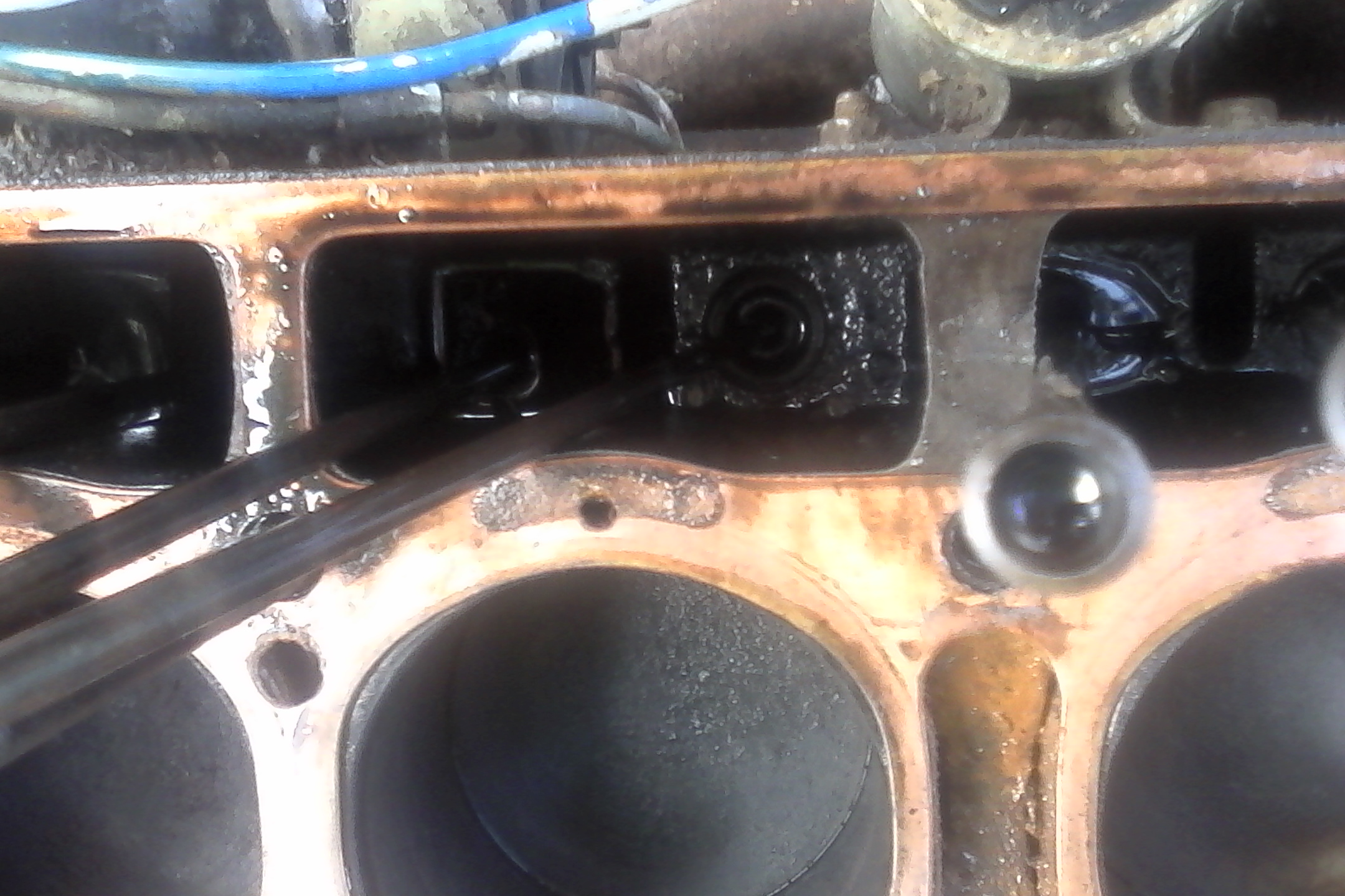

Things have further progressed- ive taken the two valves out that ,so far, are the ones i want to replace. I dont have a spring compressor so i did what i saw someone do on a video- I put a socket under the valve and placed the head on a flat surface and then i placed a socket on the spring and knocked it with a mallet which allowed the stem to travel up the inside of the socket as the spring went down and that resulted in the retainers falling out. I watched all that behind eye protection.
The seat for the fourth cylinder valve looks ok but there is a potential problem with cylinder twos seat. Hopefully in the photo it can be seen but if not there is a small trough on the top right side of where its being seating where i suppose combustion gases have being seeping through. Due to this valve being small for whatever reason (burnt out?) the seat is actually quite recessed inside the valve chamber and the actual outer seat where a bigger and i assumed new sized valve would seat is unscathed. So im not sure at all what to do with this, for starters perhaps i could wait til i get the new valve and then make a judgement call about its affect or build it up some with my welding electrode.
Or maybe the valves ok and its the seat thats recessed or maybe both?
Some opinion on this would be great. I will also check the head, as suggested, for levelness
I should add as an edit that ive compared the two valves ive removed and the one from the worst cylinder is definitely narrower than the one from the slightly worn cylinder four, so it appears some amount of valve shrinkage has occurred

As the seat and the valve wear, the valve moves deeper in the seat from the force of the spring. You will most likely need some machine work done on the head, in particularly the valve seat. I'm not that familiar with the Standard Motors, engine in the TEA-20 but most of these engines have replaceable seats. The seat looks damaged in your photo so it will probably need removal and replacement.

Jerry thanks for that. Ive rung up a few machine shops, $90NZ ($60US) per seat installed and they use a universal seat. The other option is a replacement head which ive being offered for about $100NZ with valves etc in situ which seemed very reasonable. Im going to clean her up this morning and maybe swap one of the good valves from another cylinder into her and try the petrol test.
I will also get a caliper reading on them to see just how much narrower this bad valve has become

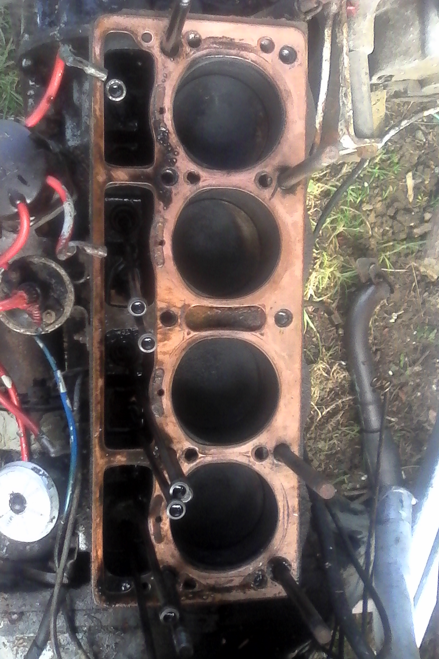

Ive being getting into to it and im up to the point where the decision on what remedy is to be done is next.
I removed all the valves using the socket technique, i cleaned them up and put the good ones all back in. To anyone else doing this in the future, getting them back in with their retainers without a spring compressor was easy. I just put a socket underneath the head again and pressed down the spring with the retainers sitting in the hole and they would slide down and lock in place, no tools needed.
Examining them the inlet and exhaust valves have the exact same height but their head diameter is different. The specs on new valves is:
Both stems are 7.83mm diameter and the inlet head is 27.95mm and the exhaust is 26.90mm.
I would of thought a bigger exhaust valve made more sense as that would enable better heat dispersal.
The exhaust valve on my damaged valve was 26.00mm and it was at least 0.5mm narrower than the next worse valve.
So this is where i come up with a possible solution as i cant weld it due to it being cast iron and that would also be hard to valve grind later.
Im not keen on paying the money for the new seat insert installation, so what ive tried is putting a used intake valve in the current bad exhaust seat. Its diameter is 27.75 so it sits a little raised of the exhaust seat but with the greater width it would seat over and above and outside the area with the trough and i would then just get a new intake valve for the one ive used in the exhaust seat.
So ive done this and ive done the petrol test and now all cylinders hold the petrol well including the problematic number 2 cylinder.
So the plan at this point is to get a headgasket set and a new intake valve and put her all back together.
Please let me know if theres anything really contraindicated to doing this as a shade tree mechanic type of repair?
I would like to do it to a precision finish but the budget just doesnt allow for it so if this does suffice i will be very pleased

I don't think an inlet valve will last 5 minutes if used as an exhaust. Exhaust valves are usually made of some exotic alloy, some were even sodium filled, to cope with the passage of exhaust gases around 900 deg C. Inlets have nice cool ambient air passing over them. Also seat angles may be different, which will mean you'll never be able to grind a seat by hand, let alone the different diameter...
I'd grind all the other valves in to get nice clean seats & check the valve spring heights - I'd be a bit suspicious if you can compress them easily by hand to get the collets back in. Springs should be cheap enough to replace as a matter of course.
There's no way out of it - that exhaust seat needs to be recut & the valve refaced or replaced. Must be someone nearby with a mill surely?

I've done a bit of research & the inlets & exhausts have the same seat angle 45 deg, so you're OK there. The valves are the same price too at about £5.40 over here - cheap as chips, so the exhausts may not be special stuff - again good news for you. Springs are £4 each- again nice & cheap.
If you think you can get that seat holding petrol OK, then what I would do is put a new exhaust valve in + a set of new springs & you should be good to go.

So shes back together and its now time for posting the findings. To recap compression beforehand 90,50,90,90. Cylinder two had a burnt up exhaust valve and seat which i replaced with a larger inlet valve and grinding it in with a highspeed drill, cylinder four had a worn valve too which i said I would replace but i didnt.
Compression afterwards 100,90, 100, 85
I think the engine was approximately the same temp when the before and after test was done. I think the improvements in 1 and 3 could be from the cleaning up of the valves, adjusting valve lash, using diesel to help soak and clean the rings up or also the new head gasket. The big jump in cylinder two im very pleased about. Cylinder four has interestingly dropped. I regret not putting an intake valve to replace the exhaust valve on that one too, perhaps me removing it to clean it has changed it from its bedded in seating position..
Whats left is for me to get a couple of water pump gaskets as shes leaking where i tried using the old ones and i also need to get new oil to replace that in there which has the diesel in it that im using as a flush.
The proper definitive test will be when i take her back out on the hills, so i will report back when i get her back out on her job list such as blading this track.
