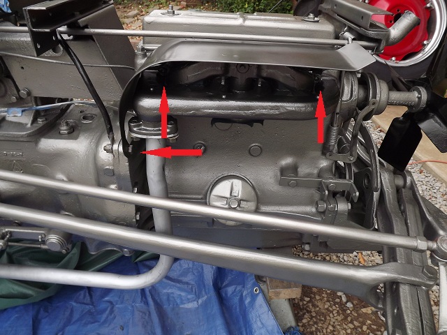

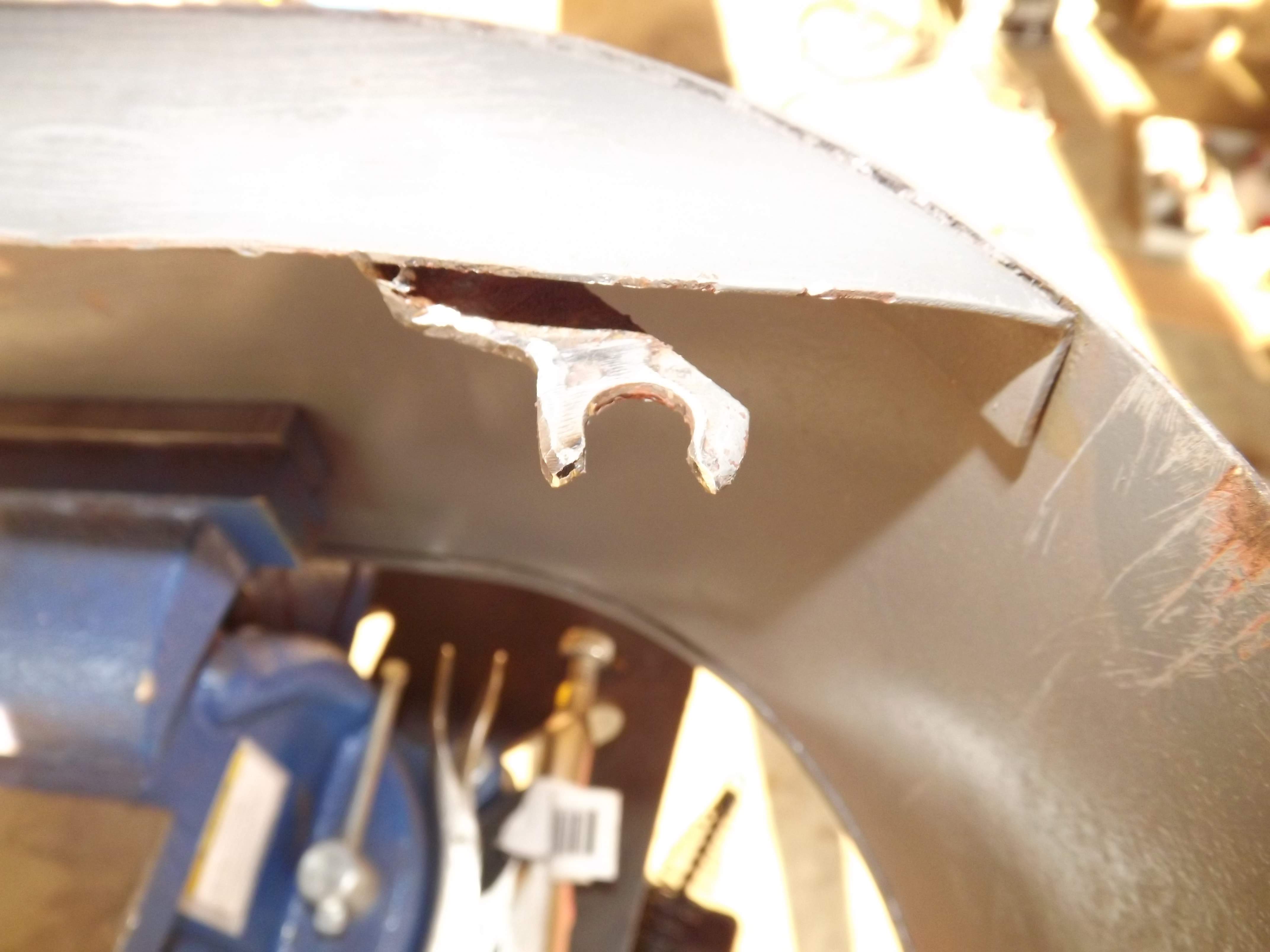

Does your exhaust manifold have a heat shield on it. The heat shield uses the same studs and mounts on the exhaust/intake manifold. It's a real b!tch to take off and put back on. So when a leak in the manifold occurs, it seems many throw the shield away. I bought one at a tractor salvage years and modified the bolt points to make it easy to remount. I found all my pictures on a thumb drive when I restored my 65 135.
As for the fuel line. It passes very close to a 500 degree source. I would invest in or have someone make you a new steel line. I bought a fuel/brake line bender at Harbour Freight and a tube flaring kit used off ebay and duplicated the fuel line path. I did the same as you did at first and caught h@ll about it here because of safety. The more I thought, they where right and went back with a metal line from the carb back to the sediment bowl.
