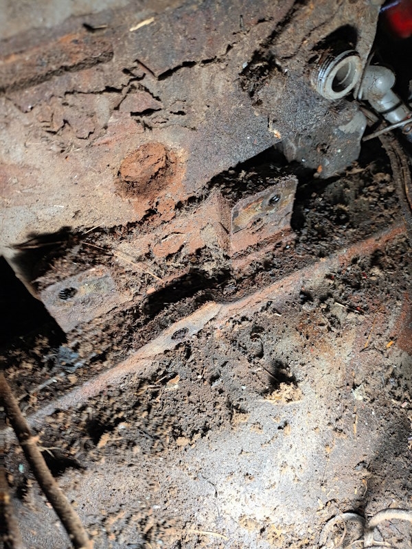

Hi,
This weekend the core plug at the back of the cylinder head on my 1968 MF135 decided to spring a large leak (Perkins AD3 152 engine).
Has anyone changed one of these before? Is it possible to replace with the cylinder head attached to the block?
In general I need to know how far to strip down to get good enough access to replace the core plug.
Thanks in advance

Apologies - I just had another look, its not in the cylinder head - its at the back of the block at the top.

I assume it's part #6 in this exploded view. https://parts.agcocorp.com/us/en/apbsearch?q=masseyferguson/651199/l&c=74 Part number is 731999M1. M-F dealer price is $5.37, aftermarket a couple bucks. OEM specs show's .891", other show a 7/8" plug. NAPA or any decent parts store should have it.
Hi, Thanks for the reply - yes that is the item.
However, My question was how much of a strip would I need to do to replace this? I have fuel tank off now and looking to remove the battery tray structure - then i think I may have just enough room?
If anyone can add anything to this then that would be great thanks.
   / MF135 Cylinder Head Rear Core Plug
Well I have answered my own question - Stripped out the battery tray and can now get at the core plug.
I would STRONGLY suggest that if you ever split the engine on a 135 then you change this plug as a precaution - as taking out the battery carrier is a hell of a job!
Anyway - I think the plug was ready for replacing looking at the photos below...... Opportunity to clean away the dirt as well.....

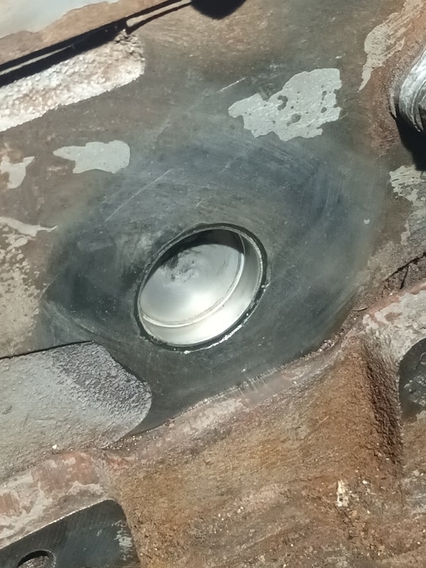

That's a little better.....
Changed all the other core plugs at the same time as they were all past their best.

Well, in my post above I said that I changed all the other core plugs as a precaution, well, I changed them all apart from the one just behind the injector pump (didn't fancy taking the pump off).
Yes, you guessed it - Fired her up today and that plug decided to start leaking - That will teach me to not do half a job! So my weekend job will be to remove the injector pump and replace that core plug - found a great video for pump timing and removal here:
From what I gather, I can remove the injector pump and put it beck without needing to time the pump as long as the engine is not turned while the pump is off. (please correct me if I'm wrong)
