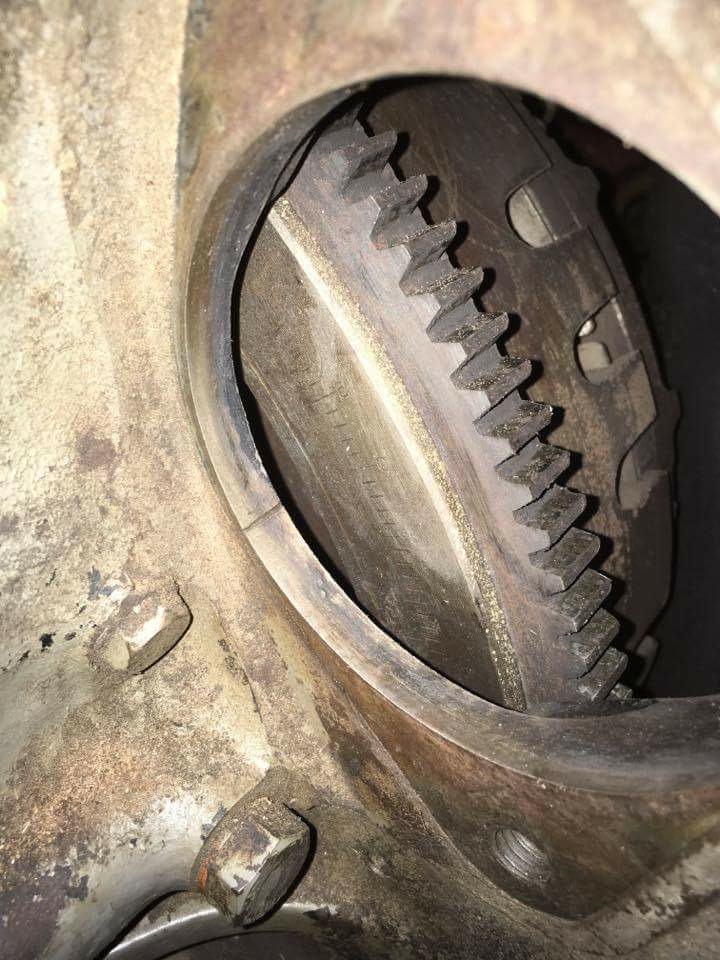

Have removed distributor and found that in one of its previous lives, this item has been seriously abused.
Heavy plier scoring to the shaft. And although the advance and ****** springs were intact, they weren't from this tractor, nor identical. The centrifugal weights had been forced so much by a screwdriver or jemmy. They were barely able to move without fouling.
New distributor, immediately cured.
On a different note.
The actual engine appears by design to be a continental Z145 engine (as best I can determine)
There are no markings on the block that give any ideas.
There are no timing marks either on the crankshaft pulley &/or timing case.
There is definitely no viewing "hole" below the starter motor as should be expected.
I removed the starter motor and could obviously easily view the flywheel with its relevant markings.
On the starter motor hole edge on the flywheel casing there is a machined groove. I static timed it to this.
Then with the starter back installed. The engine started first time. Runs very well.
No easy way to time the engine ignition without the starter motor out.... .?? !!
   / MF135 Petrol Engine problems
#14
Starter motor hole Marking, is clearly visible.
As is the timing marks on flywheel.
Does anyone else understand why this is so ?
   / MF135 Petrol Engine problems #15
G'day oz .
I did tell you how to time the engine WITHOUT removing the starter motor maybe you did not hear me!!!!!!!!!!!!
Hutch..
#16
Hi Hutch
Apologies. I did try, but must have made a boob. It ran like a bag of poo.
After setting up with starter out, on a static of 6degs b4tdc. and it ran.
I then redid it with your method and it ran also........
So I did make an initial mistake. Thanks M8.
I did listen Hutch :thumbsup:
