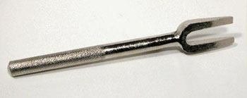

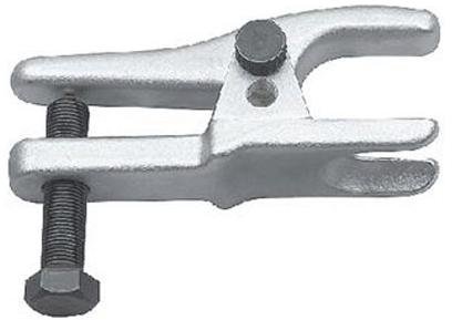

Or things like this 20060829-tie-rod.jpegTIE-ROD-AND-BALL-JOINT-PULLER-2.jpeg

I have managed to get 2x drag links out. I do have a pickle fork its just too small I bought it to use on a car.
