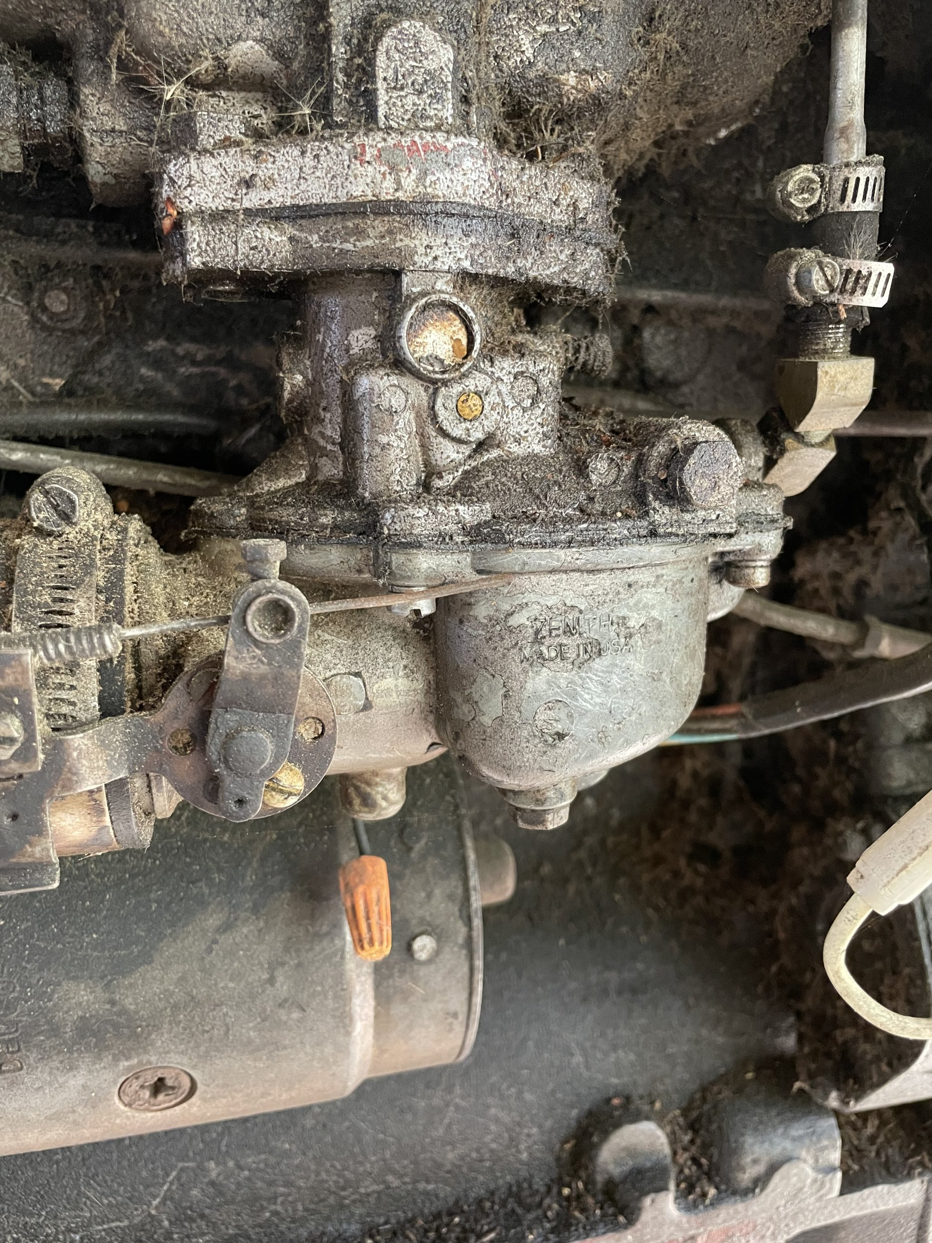

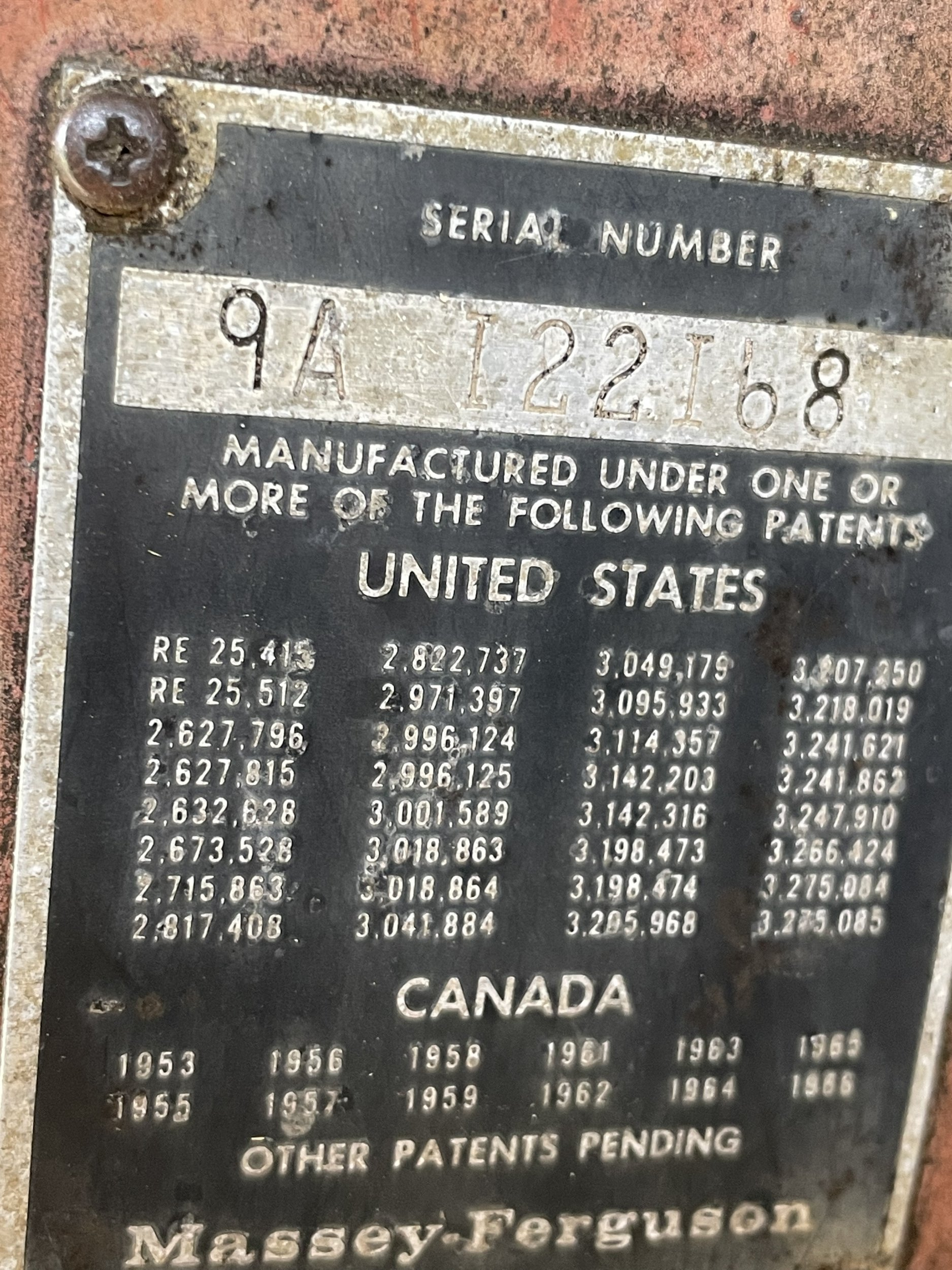

Hi all!
trying to help my husband find a piece that goes onto the bottom of the carburetor (fuel solenoid?). Not 100% sure of year. Attached is the serial # and the carburetor. Any help with year or part name would be most appreciated!

Could well be a shutoff solenoid. There's one on my 1970 135 with the Perkins.
Is it OEM, I don't know. but it's part of the carb, and works just fine...
My 135 has a Zenith 13338 carb which is one of the carbs they used.
That said, I don't see a solenoid in the above photo.

Focus... Holley needs the solenoid info, not the tank shutoff... :)
Holley, try looking up 520949M92
You'll have to confirm that's what you're looking for, but that's out of the AGCO partsbook site for a Zenith 13338 carb.
The solenoid system was optional apparently.
