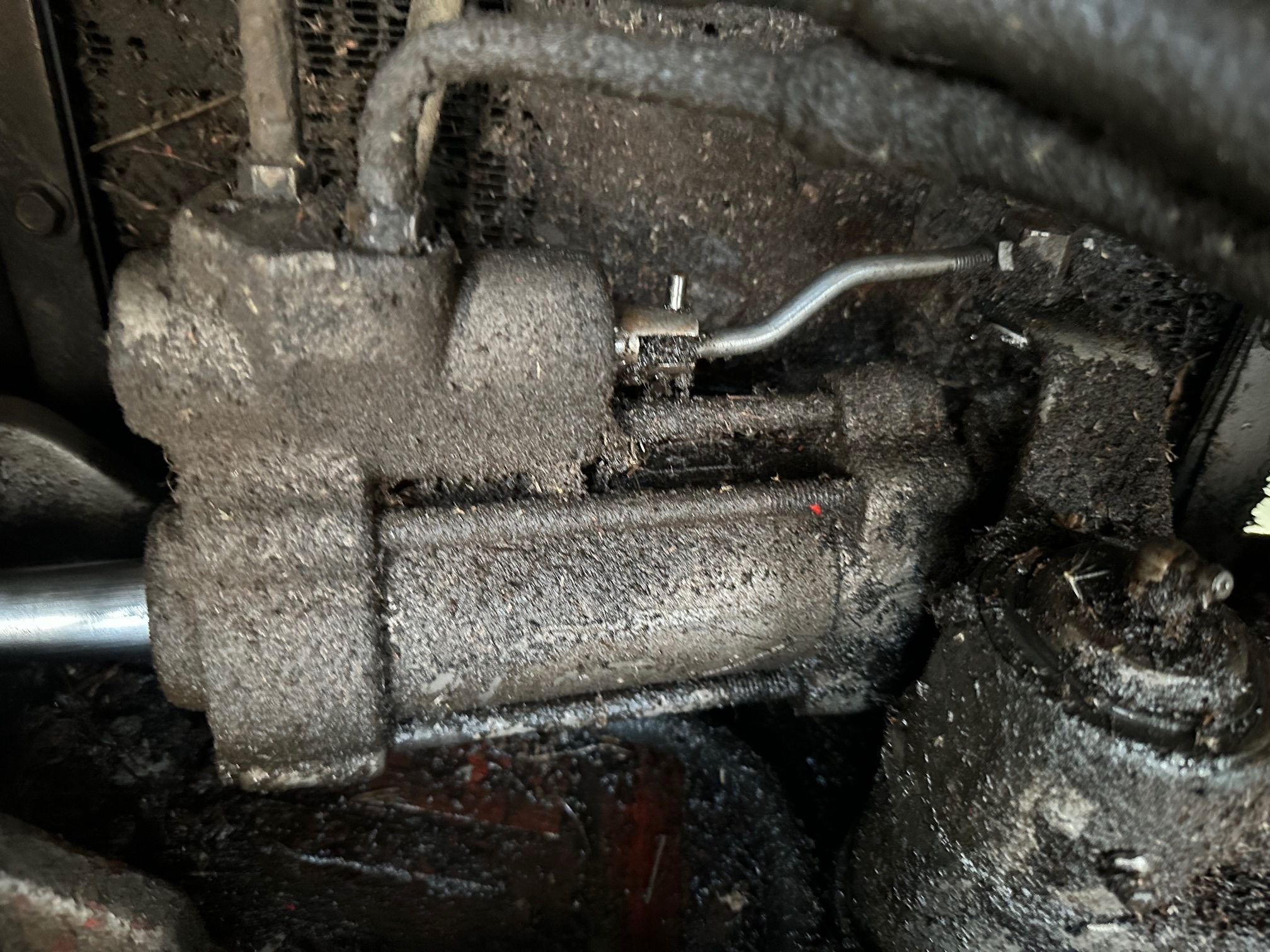

   / MF175 help
Hopefully this pic will show it. It is the little "Z" shaped piece on top of the cylinder. Most of the play is on the right side where it drops into the pitman arm. There is some where the roll pin attaches to the cylinder

   / MF175 help #6
Ah, gotcha now. As little play as possible, but determine how much is too much, when you turn the wheel left or right, is there a delay in the power steering responding. If you have to muscle the steering some before the power steering kicks in, then you have too much play in the actuator turnbuckle for one OR too much play in the major steering linkage. Most of these systems don't get greased and the main pivot arm and bushing develop a lot of play and slop around too much to make the steering work correctly.
   / MF175 help
Steering works great to the left. I have no power steering to the right, I have to muscle it.
   / MF175 help #8
Fine adjustment on the turnbuckle to even out. Then, evaluate if you need to replace parts. The adjustment is very sensitive
   / MF175 help #9
My father had 1 of these, the design of the hydraulic assist is such that the right side will never be as light as the left. A frustrating quirk of design.
Those tractors are from the dry disc brake era, so learn how to drive without brakes. If you have 1 functional brake , a trick is to engage the diff lock and rip the hand brake on as hard as you can to stop in a straight line. There is a knack to it.
Turnbuckle: disassemble and grease anually or they will seize solid.
Good Luck.
