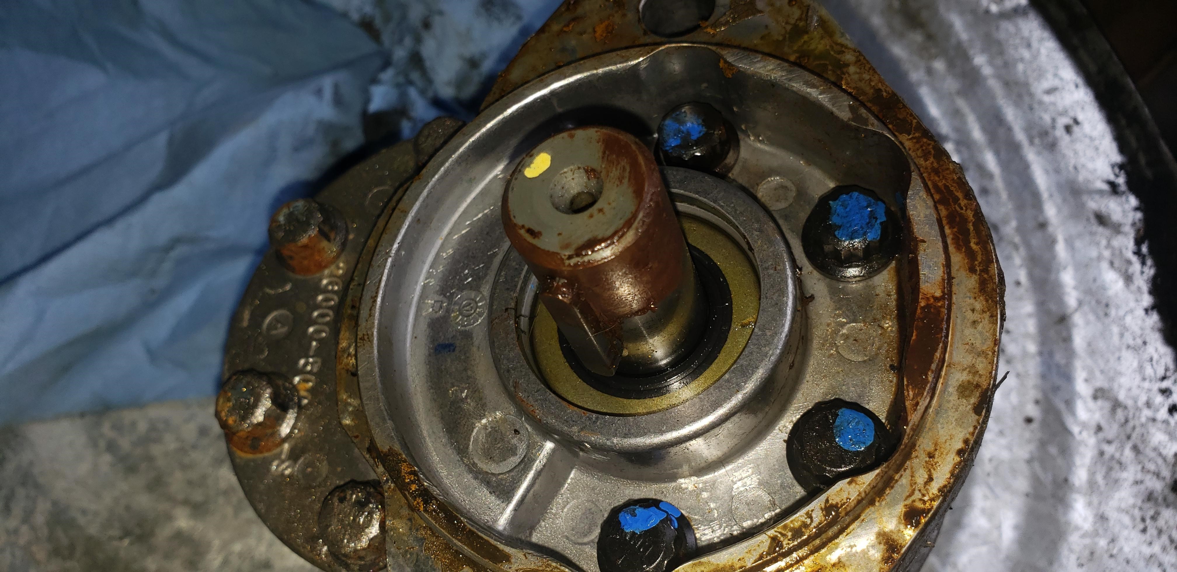

Most of these models had a front mounted pump. I'm betting your front pump failed at some time and the other owner used a pto pump. A front mounted pump is better in my opinion. You may need the pto for a different attachment. I don't think the pto pump is factory. Someone could have mounted the loader and backhoe from another tractor and mounted the rear pump.
Does your paint on the backhoe/loader match the tractor. Layers of paint can tell if something was addedl

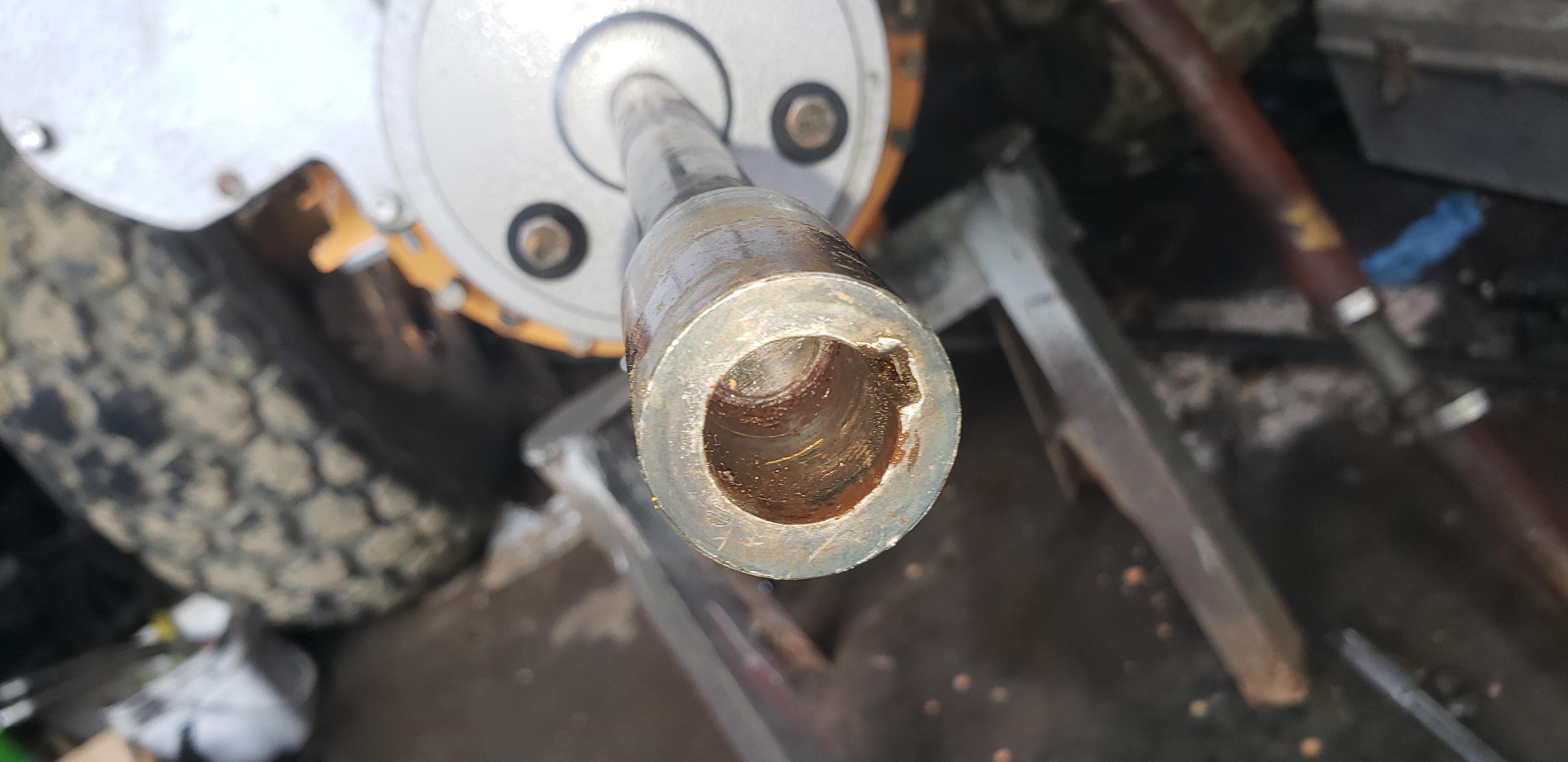

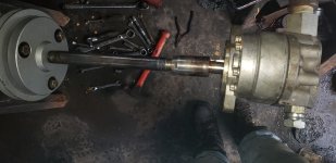

Below are what is needed for a front pump.
The round plate bolts to the flywheel pully and shaft goes through the axle pivot.. It mounts with flexing rubber bushings for minor misalignment.
The shaft goes though your hollow front axle pivot and the pump bolts to a flange on the axle.
Look and see if your front axle may have had a pump mounted.
