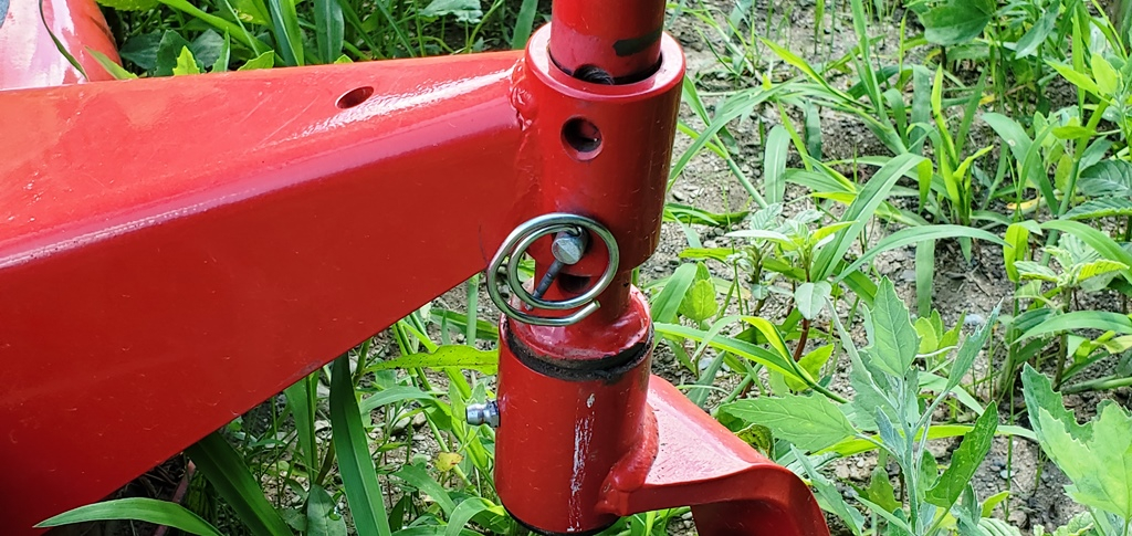

my MF2326 mid mount uses these and they come off hard.
massey part number 4260289M1 and should be around 4$ each.
same clip used the 2325. may fit yours.
Yup, that's mine too, and they yanked right a few times now when mowing next to cattails around my pond.
I do not see any way that one of those spring type concentric circular clips would ever comp off unintentionally. I've seen many over the last 3 or 4 decades and never saw one of those come off without human assistance.
   / mf2320 mower gauge wheel #15
Mine also has those spring-wound clip things. What a PITA to remove... but I've never lost one, either....

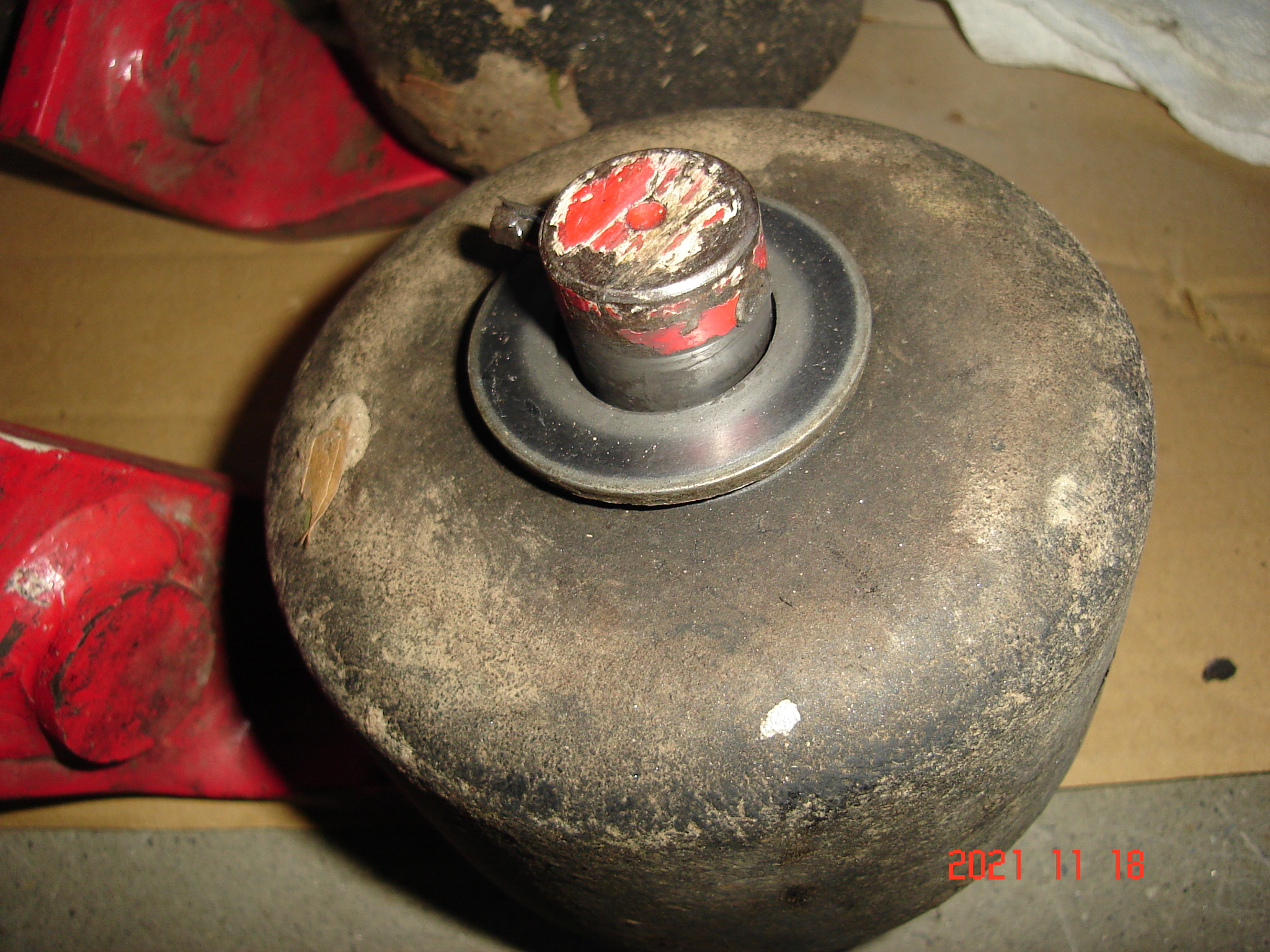

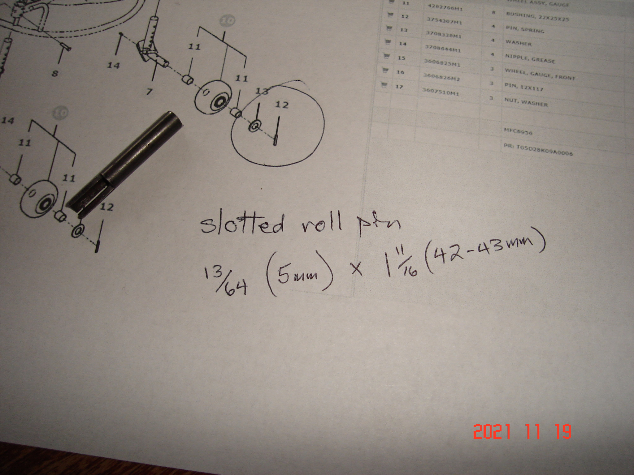

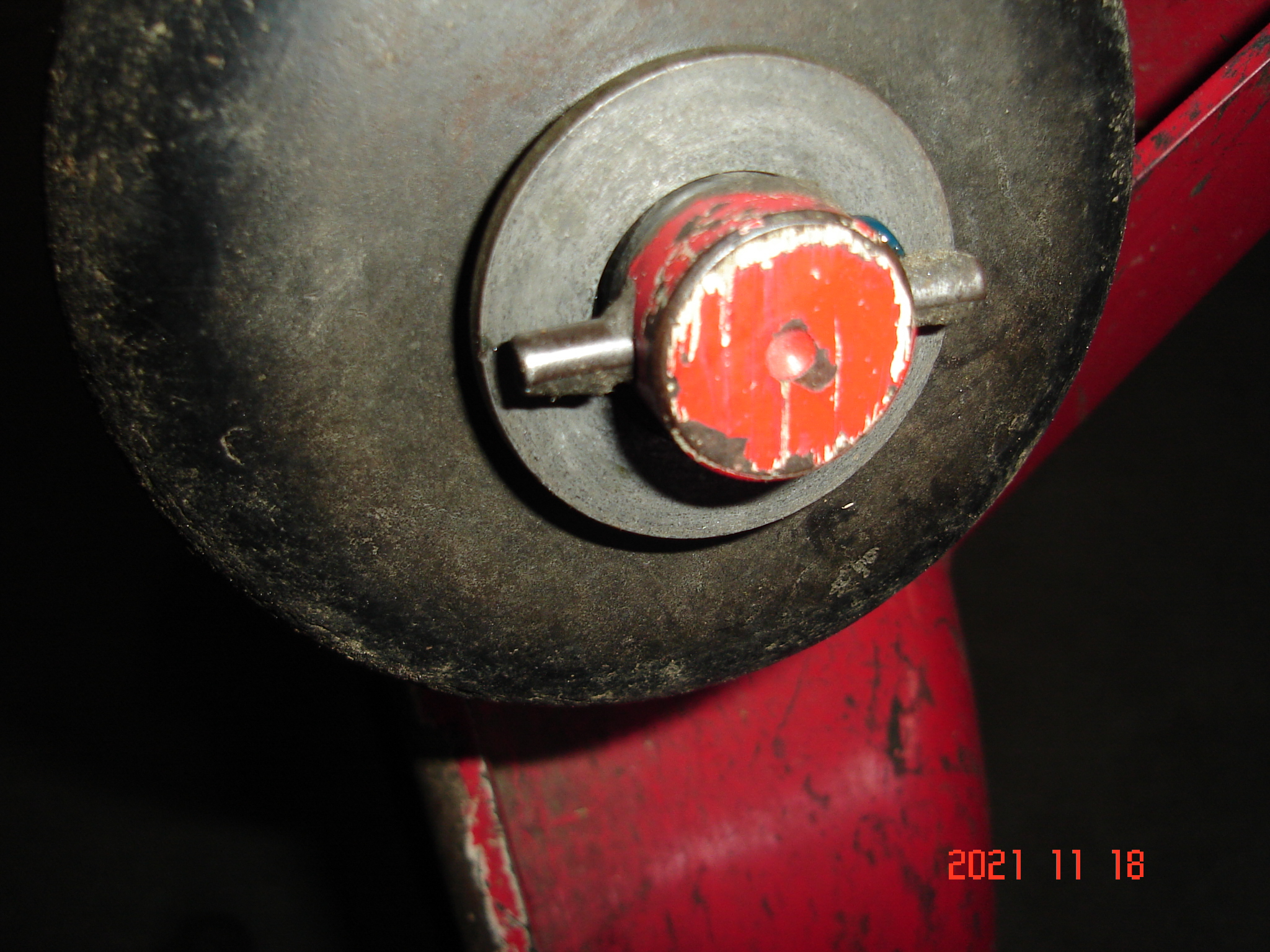

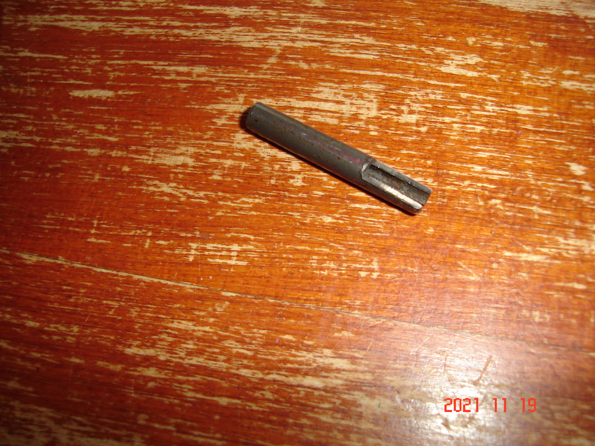

I had a different set of problems with my 2325 MMM. First, the snap ring at the base of one of the swivel wheels (front) apparently fell off(??), so the whole thing dropped down and the washer fell off and was lost. Had to drill out a large washer to get that to fit, but daughter's R&D outfit had a snap ring... so that was a fairly easy fix.
While putting the MMM up for the winter, I discovered that on the rear wheels, the slotted spring pin that holds the wheels onto the axles (all four wheels use this method) had been ground away by rubbing on the washer(s) over the years, no doubt because of the sandy nature of the backfill put in around the house when it was built.
Half of the pin was ground away, half-way through... but the lower section was completely gone. Turned the wheel over in my hand to get at the grease fitting... and one of the washers dropped right off! (WTH??) Then I saw the pins were worn away.
So-- if that ever happens: pins are metric, 5mm. Closest I could find locally was 3/16" (Tractor Supply), which worked, but the fit is not so tight. Have some 5mm x 40mm pins on order (Grainger).
Fist pic is front wheel, showing the pin the way it's supposed to look. Second pic is one of the rears -- note that the lower half of the pin is completely gone. Third pic is from MF parts diagram. Fourth pic is one of the 2 pins after it was removed & cleaned up.
View attachment 722130 View attachment 722131 View attachment 722132 View attachment 722133
Well you got the 5mm spring pins ordered already. I was gonna say, just hit ebay, I find stuff like that pretty cheap on ebay.
   / mf2320 mower gauge wheel #20
Got the pins from Grainger yesterday, and my assumption was correct, they need to be 5mm. Old new ones (3/16) came out very easily; suspect I could have pulled them out with a pair of needle-nose pliers so they probably wouldn't have lasted long. New 5mm pins definitely needed some force to tap them in. Good to go. BTW, pins were 5mm x 40 mm and I have extras (pack of 25) if anybody needs a couple.
