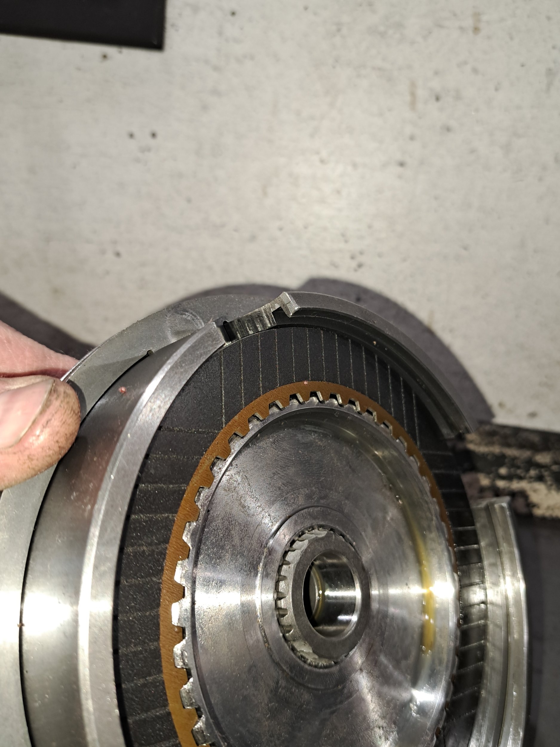

MF2606H
I have a 2016 2606H - 65 hp with 8x8 shuttle and independent PTO (55 hp). I love this tractor, but ... the PTO quit working 3 years ago and AGCO covered it under warranty (good on them). It just quit working AGAIN and they are going to have to split the tractor AGAIN. It is out of warranty so unless they take pity on me I have to pay this one.
Since the first time it quit I have only put about 500 hours on it, mostly "bush hogging " horse pastures and moving round bales. The first time they repaired it the only feedback was a broken thrust washer. They supposedly replaced the entire PTO clutch assembly.
I have slip clutches or shear pins on all my implements and don't abuse the tractor.
Can anyone offer advice as to the potential cause of the PTO failure and/or the interaction with the dealer. I do plan to go look at it once they split it. I can't afford to do this every 3 years with a $3k repair bill.

UPDATE - they split the tractor and removed the clutch assembly. The large snap ring that holds the end plate was gone (presumably chewed up and laying in the bottom) which allowed the clutch plates to move out. Several plates bent in the ensuing melee. The friction material appeared almost new and there was no evidence of high temperatures or burnt fluid. The head mechanic believes the primary failure is the snap ring came out of the channel and everything else is secondary, including the clutch housing frozen to the shaft. The splines didn't fail, the ends were chewed up. This theory makes sense based on two things (1) when it failed there was no loud bang, just an uneventful slow to a stop. (2) one corner on the clutch housing was bent on the corner which may have allowed the snap ring to exit the groove. See picture below.
Only torque loads can be imparted from the attached implement. That corner bend in the housing would come from an axial load, the only source would be pressure from the clutch valve. So is it a material issue, an assembly issue, or something (grit) caused an asymmetric load which bent the housing and liberated the snap ring? And why did it happen TWICE!!@#%%%&??
The AGCO service Rep evaluated the case. Their system for tracking issues doesn't show this as a problem and they could not offer an explanation as to why it failed. The dealer told me in his 40+ years he's only worked on two PTO failures- both mine. Great. It appears I am stuck with a $4900 repair bill and a decision - run the crap out of it while under the 6 month repair warranty or baby it and hope it lasts more than 3 years?

sorry I did not see this earlier but high pressure will cause that kind of explosion have seen on power shuttle transmissions many times valve sticks gives it 2000 psi instead of three hundred and boom boom so the should be replacing a pressure valve or manifold that runs pressure they do it intermittently so we just changed out manifold
