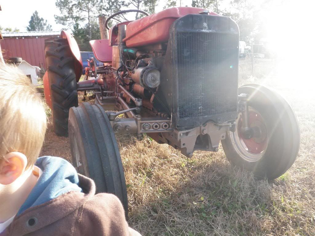

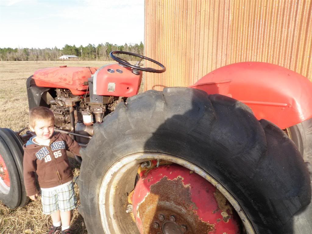

I got the tire off the rim last night... What a butt kicking experience that was hahah... I was wore out. I took the core out of the tube and ran over the tire with my dually to bust the bead loose. Was easy since once side was already off.. I then tried to work the second bead off first with a big pry bar, and finally worked it off using a wedgie for the porta power.
After that I cut the welds for two of the tabs to reweld them in the right spot, and then I was going to fab two more tabs... Now I dont know. I measured the rim to be like a 9" rim if I remember right(inside of bead to inside of bead), so the 10" tire shouldnt have been blowing off unless it was damaged. I notice that the rim does have a spot where the bead is bent a little outward so maybe thats the problem, but other than not wanting to part with the money for a new rim shell I cant think of too many reasons to try to salvage this one anymore..
Here is a pic of one side(with the little one posing)
And a crappy angle of the otherside. I dont know why anyone would set it up quite like this on purpose.. I have an inlinking that the guy got a used tire on a 4 tab shell, and just had a brain fart when he decided to weld on the hub when he welded it on the wrong side..
Well, I guess as an update its getting a new rim..
