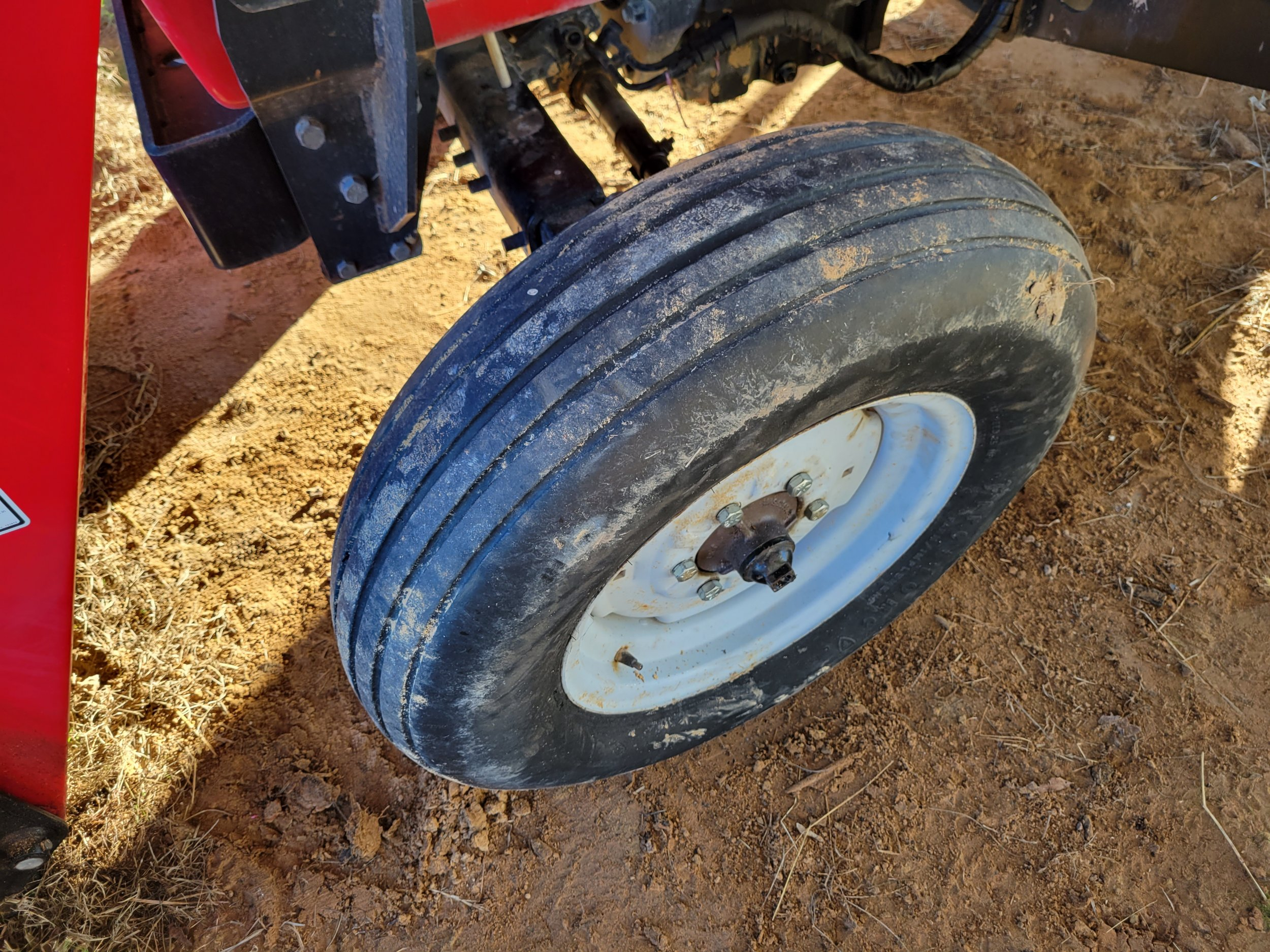

What was the outcome
What was the outcome?
Long story short I got the part from a salvage yard. Machine shop said they couldn't fix to close to the threads.
I have been busy just getting to replacing. Realized oreillys sold me the bearings without the races so wasn't able to finish the job but spindle went in np after lots of lubricant. Calling around tomorrow to see if I can get the races and get her fired up hopefully. I've been itching to get her out again plus I have round bales to move. Thanks to everyone who replied to my question. Happy New year from the lone star state.

Sorry to say buy your local machine shop sucks.
Glad you were able to find a replacement though

I was beginning to think I wouldn't be able to find one. A yard in Alabama contacted me. Southern tractor.
On the shop yeah I don't think they wanted the risk? They said if I could find one that was close in dimensions they could machine it for me to the exact size needed.

Fired right up after sitting over a month. Keeping my fingers crossed no more problems.

You would think being a 2005 this wouldn't be an issue. The bearings came apart and the hub wore out a section of the spindle where the front bearings go. I don't know if that could be successfully welded so that the bearings will roll smoothly over that area. I have tried google and all the yards that come up. I can check the one in PA. I even tried looking for a salvaged 431.I'm in TX. I've already spent considerable time calling yards etc. the ask agco yet is a resource worth checking out.
