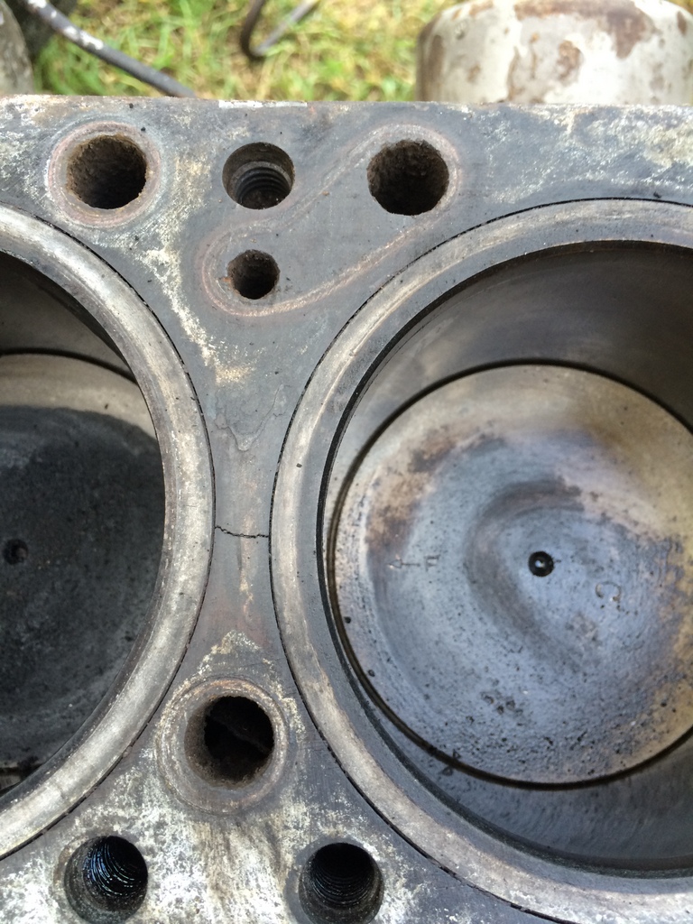

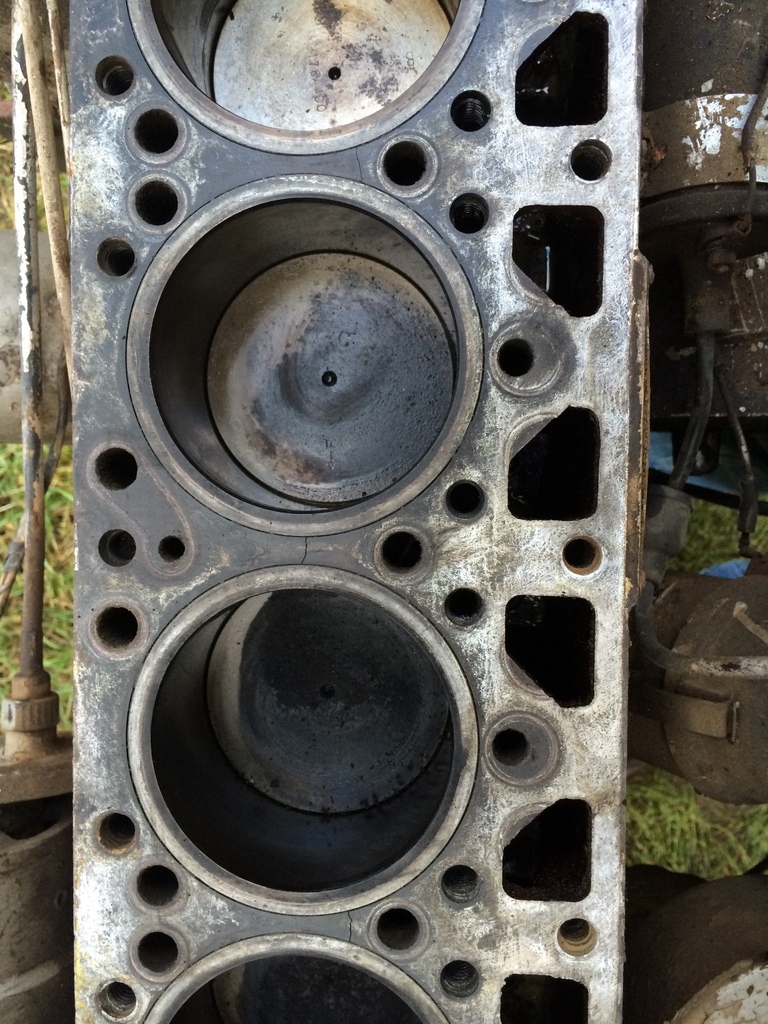

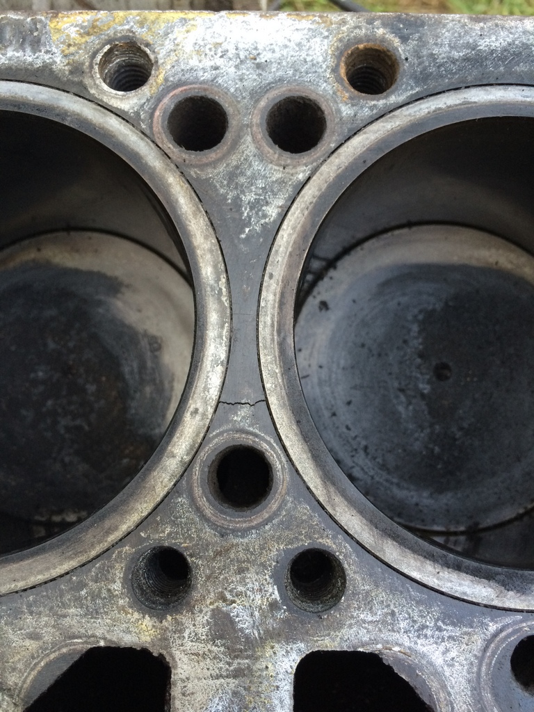

Well, finally had time to dig into the tractor this evening, got the head off and there are three cracks in the block, one between each cylinder. I am afraid she is beyond repair at this point unless there is some "easy" fix for this.
Bruce

Sorry to hear that. I suppose you could look for a used motor. May not be worth it and it is your call. I've heard JB Weld fixes, but IMO they're temporary at best
   / MF65 water in the oil #9
Those cracks look like someone put cold water into an overheated engine. i.e. they're not from freezing or from pre-detonation. Head is likely warped as well.
   / MF65 water in the oil #10
You mention it was "flooded". Was it running while driven into deep standing water?
