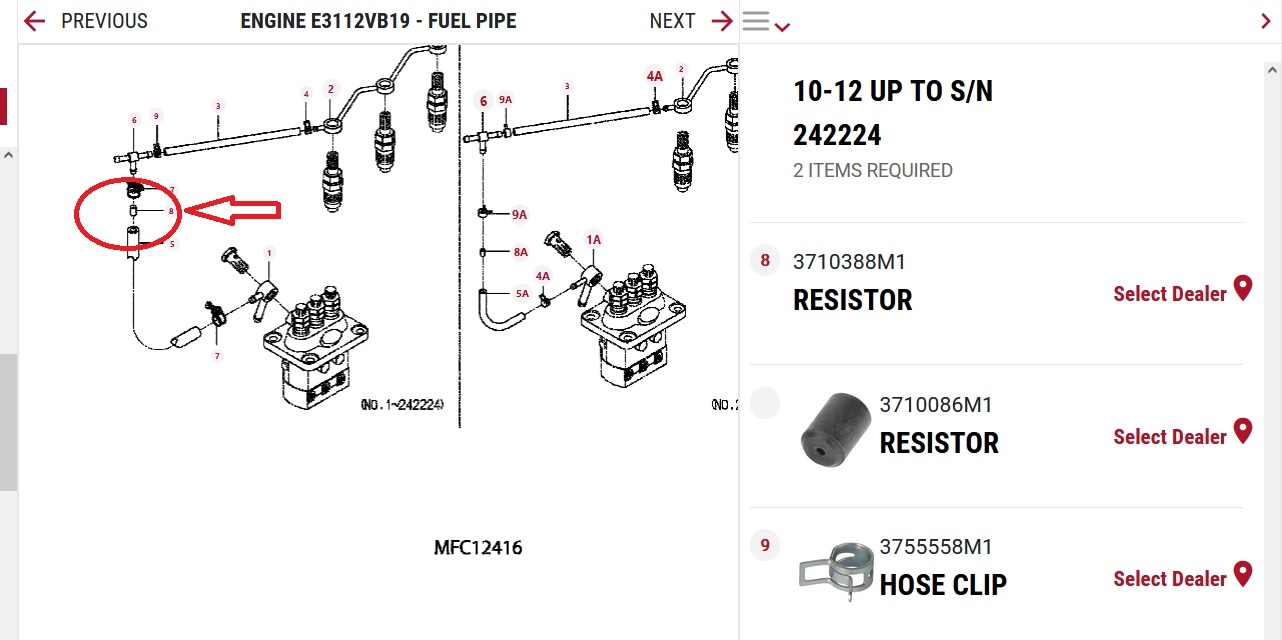

   / MFGC 2300 Diesel Fuel Line Leak #14
I have replaced that small section, was leaking on the backside. Be aware there is a restrictor in that section of hose that has to be removed and inserted into new piece.
Hi DMW,
Thank you so much for the diagram and reminder about the restrictor.
For the horizontal small section of braided hose (length of 70 MM or ~3 inches), can I replace with non-braided hose materials same as the vertical section with ID of 7MM (~1/4 inch ID)?
Mochi
   / MFGC 2300 Diesel Fuel Line Leak #15
Don't see why not, Mochi. And no, I did not change that section of fuel line, only the long one that goes down under the floor to the small electric fuel pump.

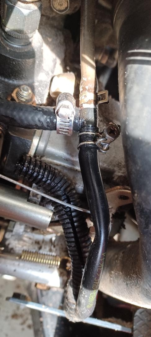

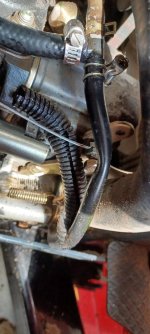

   / MFGC 2300 Diesel Fuel Line Leak #17
Hi Everyone,
This fuel hose connected to the tee leaks and tightening the factory clamp did not stop it. Then I discovered that the hose is collapse (see picture). What is the cause of the hose collapse?
Thanks!
Mochi

   / MFGC 2300 Diesel Fuel Line Leak #18
Hi Everyone,
Thanks!
Mochi
Try loosening the hose clamp and rotate the fuel line on the fitting to see if the collapse was caused by a twist in the line.
