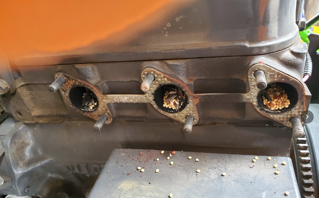

I shared this on the Kubota Forum, but I thought it would be beneficial to repost the picture here. This is from my Kubota ZD1211 mower. The engine would not turn over and I couldn't figure out why, since it ran perfectly when parked for the season.

Little rascals filled the exhaust tract on our combine engine with soybeans many years ago. Fortunately they filled it to overflowing so we spotted problem before trying to start it up.

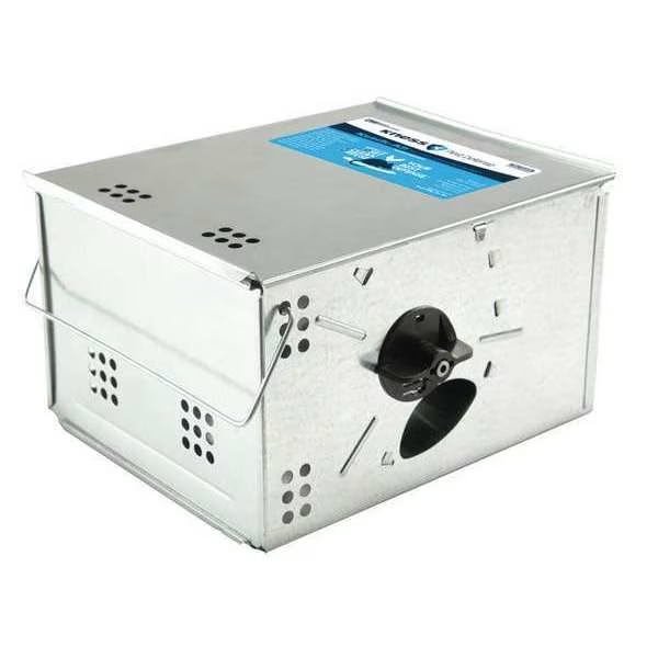

This worked for me, spend some $$ and get a bunch of these rotary traps. I have caught half dozen at one time.
/ Mice are not nice
This worked for me, spend some $$ and get a bunch of these rotary traps. I have caught half dozen at one time. View attachment 858675
Do you bait it? I notice they say you don't have to use bait.
I have two miniature dachshunds who have their nose in everything. The sticky traps work pretty good but I don't use them in the garage due to the dogs. This trap looks safer and more humane.
/ Mice are not nice #5
Used to but not lately. I give barn access to our outside cats and they take care of any impending issues. Only issue I have with that is, they like to sleep on the tractor hoods plus I have a couple bucket traps to get any stragglers.
