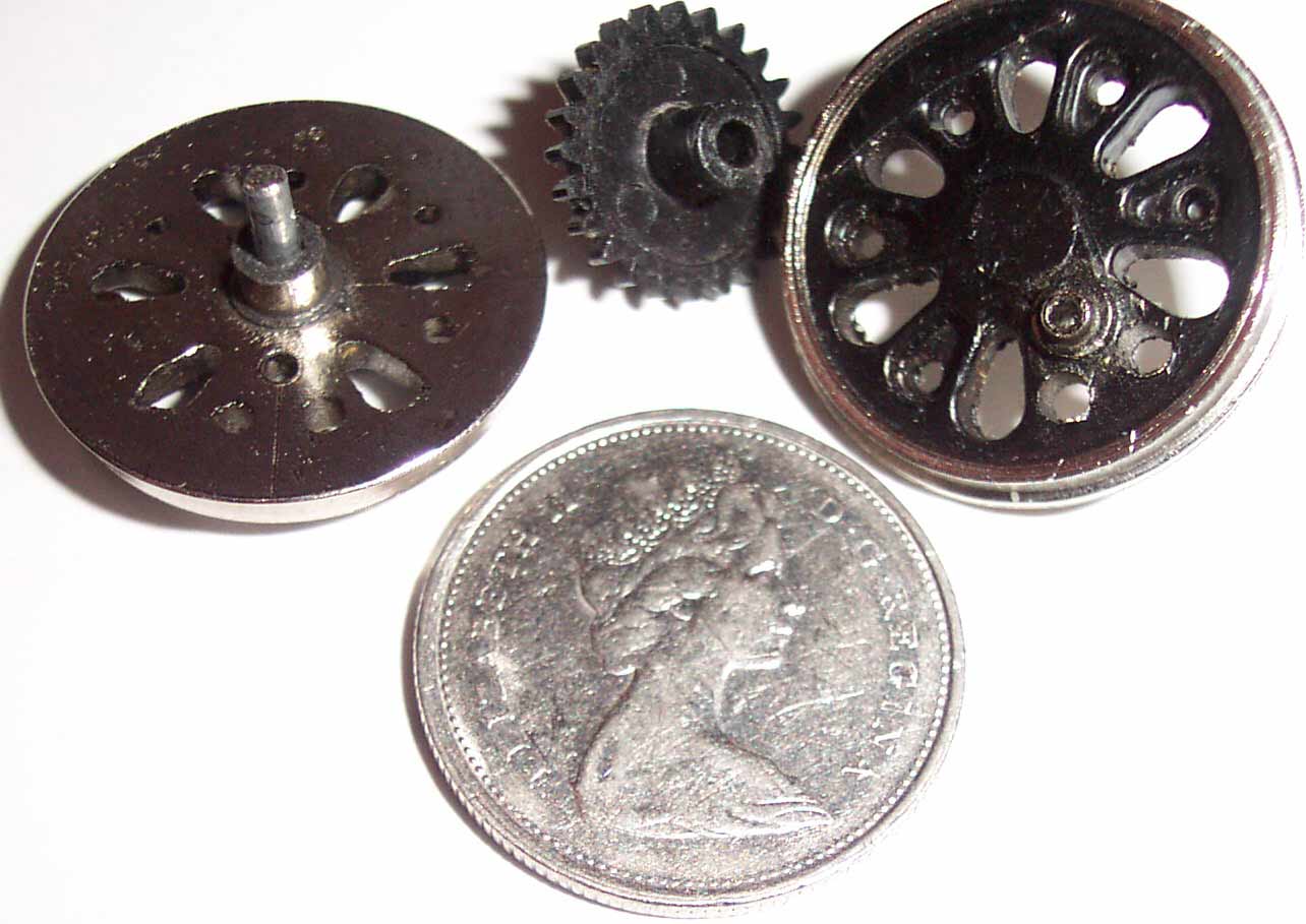

There are four drive axles on each engine but the probem only exists with one axle on each, the powered ones. The other three driven axles on each engine are in place and are properly quartered. The issue is to get a solid connection between the drive gears and the drive axles, properly quartered. The plastic gears were originally pressed onto the axle stubs but with use over the years, the axle stubs have came loose from the gears. I am attaching a picture of a dissassembled axle. I should have included this picture in the original post. The quarter is to show the realtive size. As I indicated earlier, the axle is 2mm in diameter. My intention is to cross drill the hubs and axles to fit a 0.5mm (not 1mm as I stated earlier) pin through the hubs and axles to lock them together. A spring pin or roll pin would be great but I don't think they are made in such a small size. At the time of final assembly, I will glue them as well. The suggestion of Locktite instead of ACC is one I hadn't thought of but will try. If you look closely at the driver on the left, you can see a quartering mark at approximately the 6 o'clock position. There are four quartering marks on the inside face of each driver. Close to the hub on that quartering mark is a small hole. That hole is opposite the dowel for the side irons on the outer face of the drivers as seen on the driver on the right. When assembled the dowels on the drivers must be offset from each other by 90 degrees.
To date I have contacted numerous machine shops and watchmakers and only one machinist said that he could do what I want. But he wants a $280 set-up fee, plus run-time. So I will keep searching.
Thanks for the many helpful suggestions. /forums/images/graemlins/smile.gif
