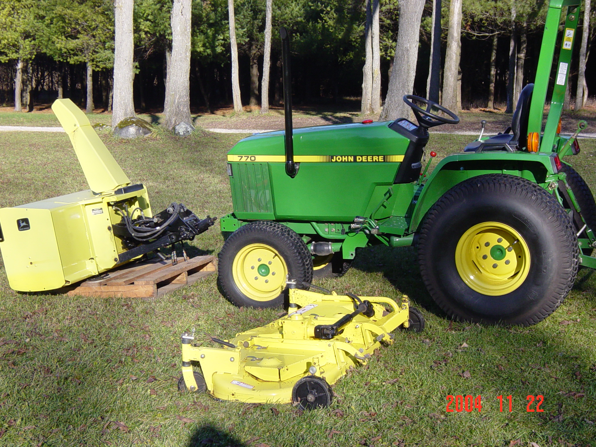

I sold my 770 with belly mower to a neighbor. It was hard to sell because everyone wanted a hydro, just as hydro compacts were becoming popular.
OK for long stretches. Lousy, because you should reduce RPMS to shift direction. And then only have two speed selections. Really only one, because the other speed requires a range change.
Yes. My 790 is the same way. But I'd live with that any day in order to get gear shift with mid mount mower.

Sorry, I'm confused. So get a belly mower for your 790 and you get what you want, no? A gearshift and a belly mower.
