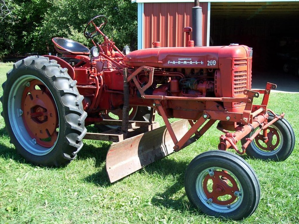

These old Farmall tractors are the only ones I've ever seen with a mid mount blade

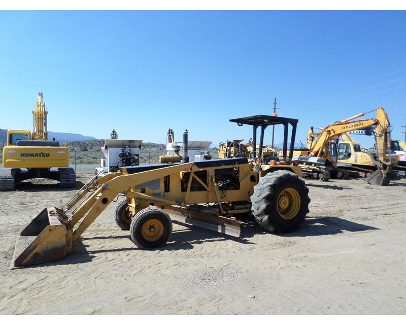

other than the industrial Athey grader.
