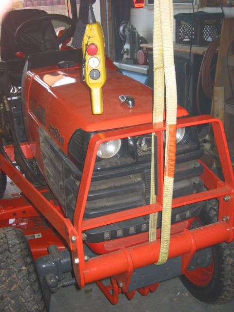

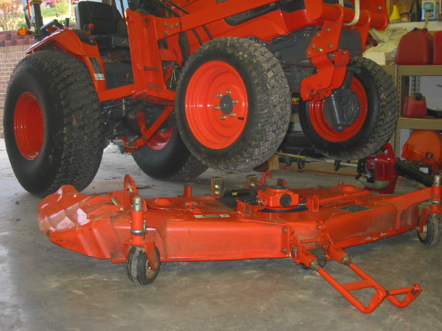

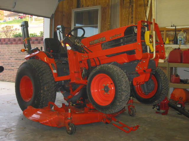

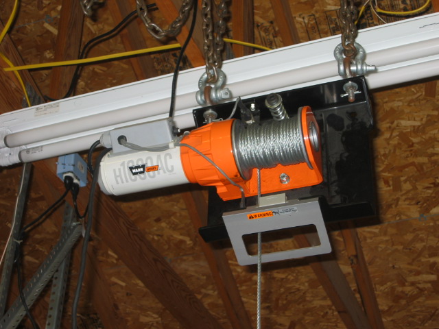

I use a chain hoist. Just unhook the mower and lift the front of the BX and roll the mower out. No turning mower wheels or trying to get it out the side of the tractor. Then let the tractor down and back it up and use the hoist to raise the mower deck for cleaning. It may not be the fastest way but I'm not having to struggle with this job at all. Putting the deck back on is also the very simple and easy. Got the hoist at a garage sale for ten dollars. My best find ever.
Same here. I use a Warn hoist to raise up the front of the B7800. Detach / reattach in less than 3 minutes each way. While I am at it, I also raise the deck with the hoist to remove / reinstall sharpened blades.
