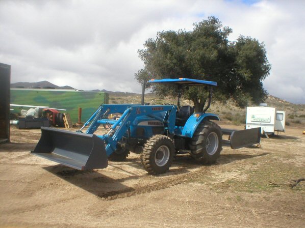

As you can see, the belly blades are available.:) But I would think that they are high $$$$. The other downfall I would think is that once you had that blade on, you would not want to be taking it off very often thus hindering in the versatility of your tractor.:(
On the other hand, if you want an implement that maintains roads very well, for less $$$$ and leaves your tractor with all of its versatility, A Road Boss Grader Blade fits the bill. There are many other grader blades that are similar, prices will vary. One of these blades would be about the next best thing to an actual belly blade in my opinion. Actually I have an 84" Road Boss that I maintain about 2 miles of road with and I am quite satisfied with it.:D
