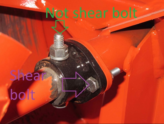

I'd take a close look at the fan shear pin again and put a wrench on it or just pull hard on the fan to see if it spins. Quite sure I had something like this occur many years ago. The shear bolt was painted over therefore adhered to the shaft on both sides. It sheared but both sides looked fine. There was enough drag internally that the fan still spun up with no load but immediately would slow and stop under load.
This is where I would stay, cheaper and easier to double/triple check all shear pins first.

Just a thought. When I was adjusting my skids on my blower , we’re supposed to get a bunch tonight,I looked at the the fan and wondered which of the two bolts you thought was the sheer bolt. It is not the one that passes through the shaft it is the smaller bolt that holds the joint together. Really don’t know how to explain it but look at both bolts near the shaft that connects the auger to the fan

I was talking to a friend the other day and he had just bought a 1 year old used blower from a guy because it didn't blow well. He got it home and looked it over and there was no shear pin in it. He said he didn't think there was one from the factory even because the hole had intact paint in it. He installed a shear pin and it was blowing snow 20' after that.

Just a thought. When I was adjusting my skids on my blower , we豎*e supposed to get a bunch tonight,I looked at the the fan and wondered which of the two bolts you thought was the sheer bolt. It is not the one that passes through the shaft it is the smaller bolt that holds the joint together. Really don遞 know how to explain it but look at both bolts near the shaft that connects the auger to the fan
See attached photo
Dave M7040
