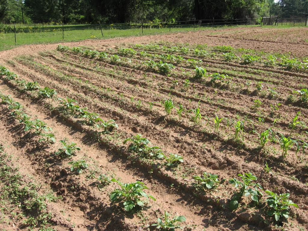

Wow I've learned a lot to. I'll have to feed mine more. The water is the only wildcard. I plant early sometimes because we get more rain. But the spuds are the only thing that survive the lack or water.
I also don't get all the vines yall mention. hmmm. Here is a pic from last year...a good rain year. The stuff was planted 3/11/2007, the picture was taken on 4/7/2007. The spuds are the near 2 rows. So I'm guessing it looks like hilling time?
The rest is corn, then peas. The very small corn in the upper part of row 3 and 4 was planted on 3/26/2007.
1st pic is 4/7 , second pic is the 3/26.

Your potatoes look ok for 5 weeks, and that would be a great time to hill. They look a little light, maybe lack of N.

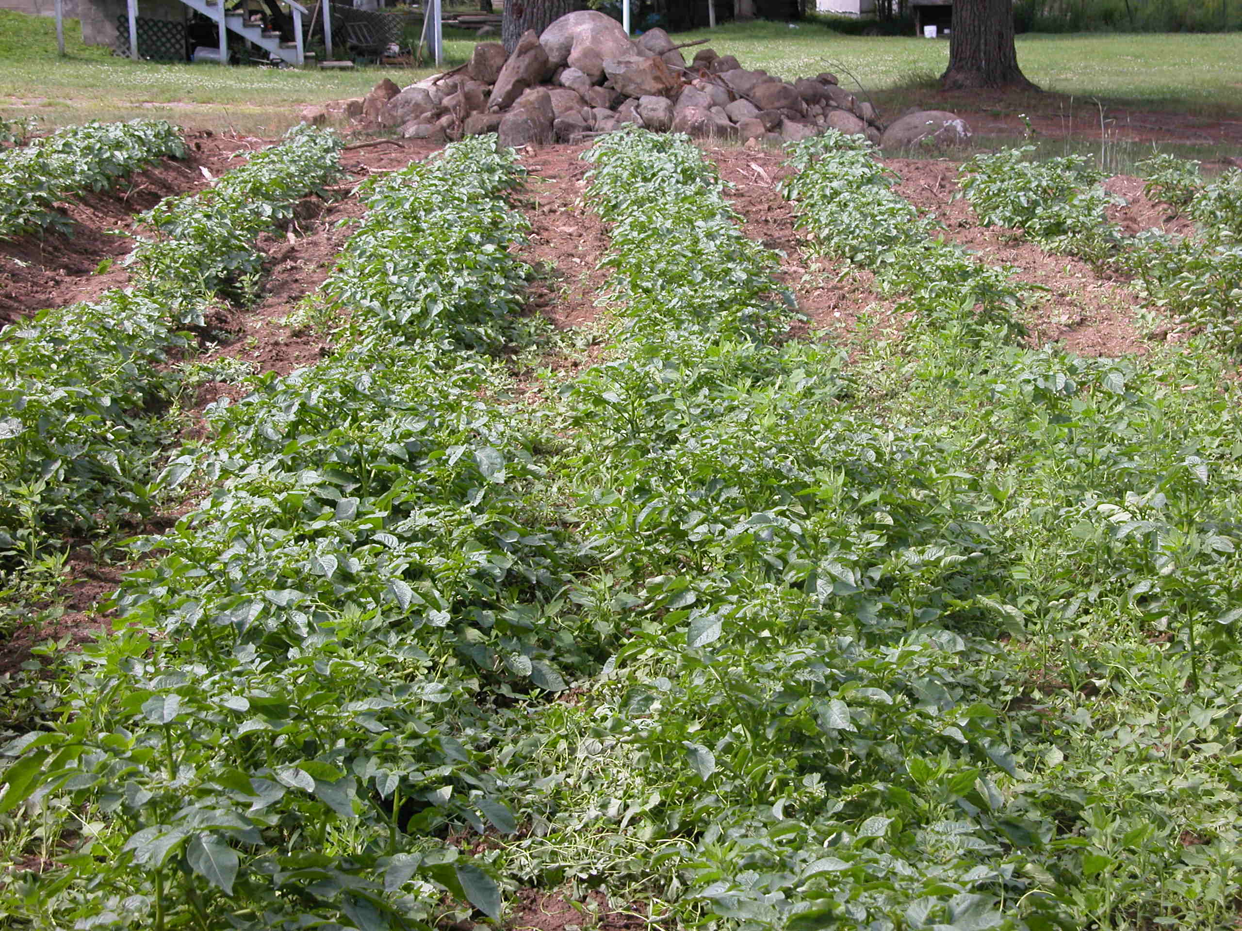

I have attached the only digital photo I have of plants/hills at about 7-8 weeks. The weedy rows in the foreground are the Red Norlands you have seen harvested. They are not hilled due to my busy schedule and carelessness, and they are weedy. In the upper left you can see clean and hilled rows of Superiors.
The vines are beginning to get into the row middles and will eventually completely cover them. The Norlands are worse in this regard than Superiors, which are more erect in form. Potato cultivars vary a lot in terms of growth habit and other physical features.

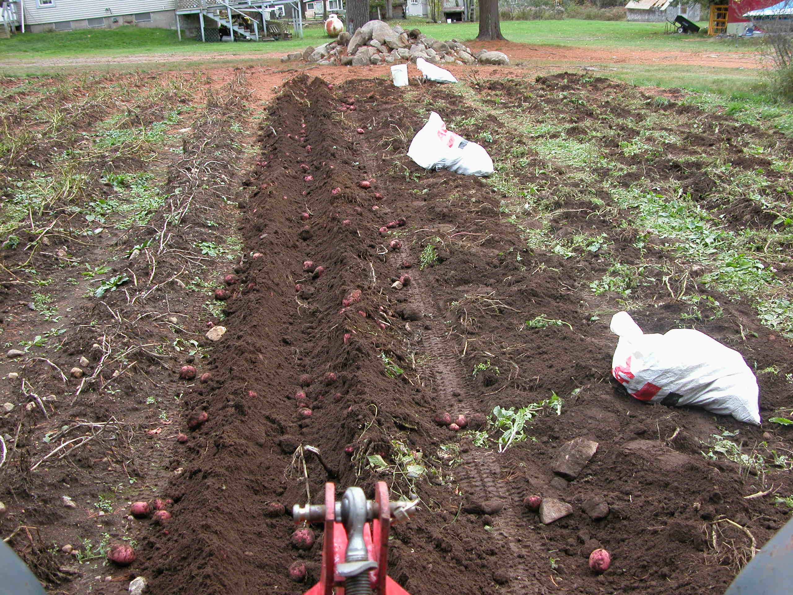

Nope, just dig them up and sack them and move them out of the field. I then disk and plant rye to protect the ground and grab any excess nitrogen.
The big growers move their stuff to market as fast as they can and put the remainder into atmospherically controlled storage.
The produce we grow is for the community, we feed the needy and elderly. We get sacks of potatoes to our customers who can use large quantities, i.e. families, at harvest time, eliminating the need to store. Then we have a fairly efficient method of distributed storage whereby the sacks go to volunteers who have either cold or warm cellars. The warm cellar potatoes get bagged into smaller bags and are taken around by volunteers with the objective of using them up by Christmas. The cold cellars can keep the remainder in good condition for distribution through spring.
