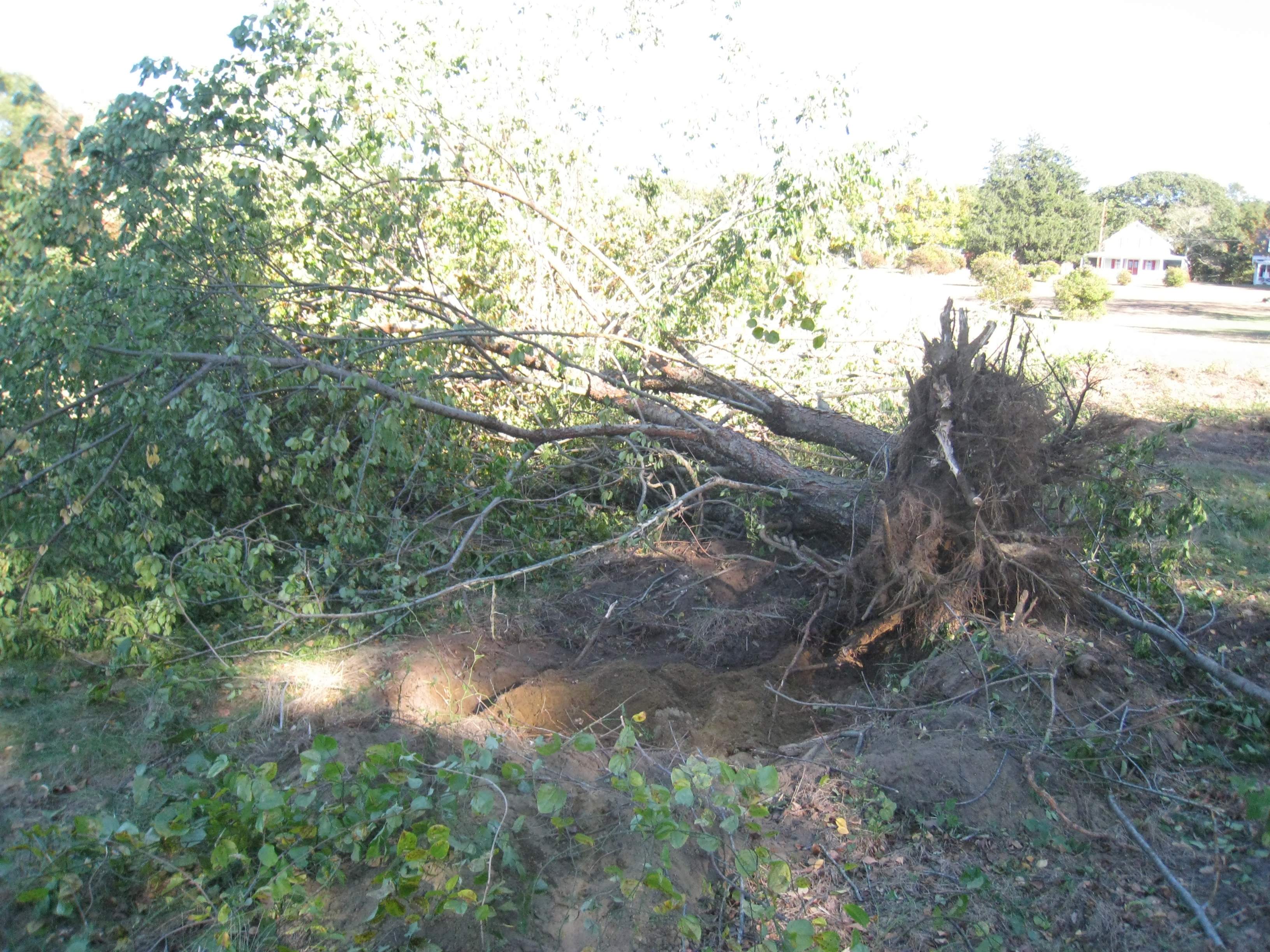

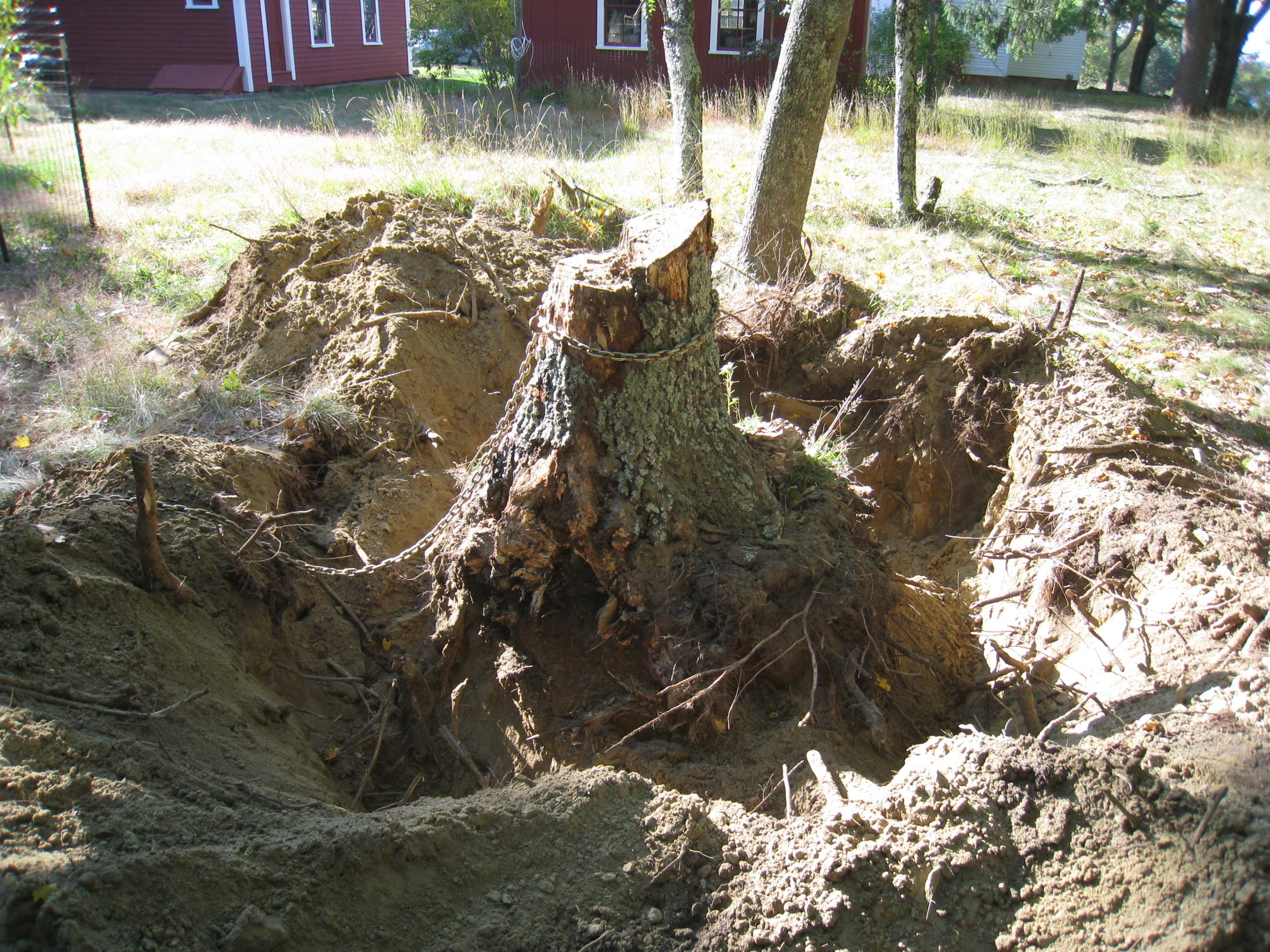

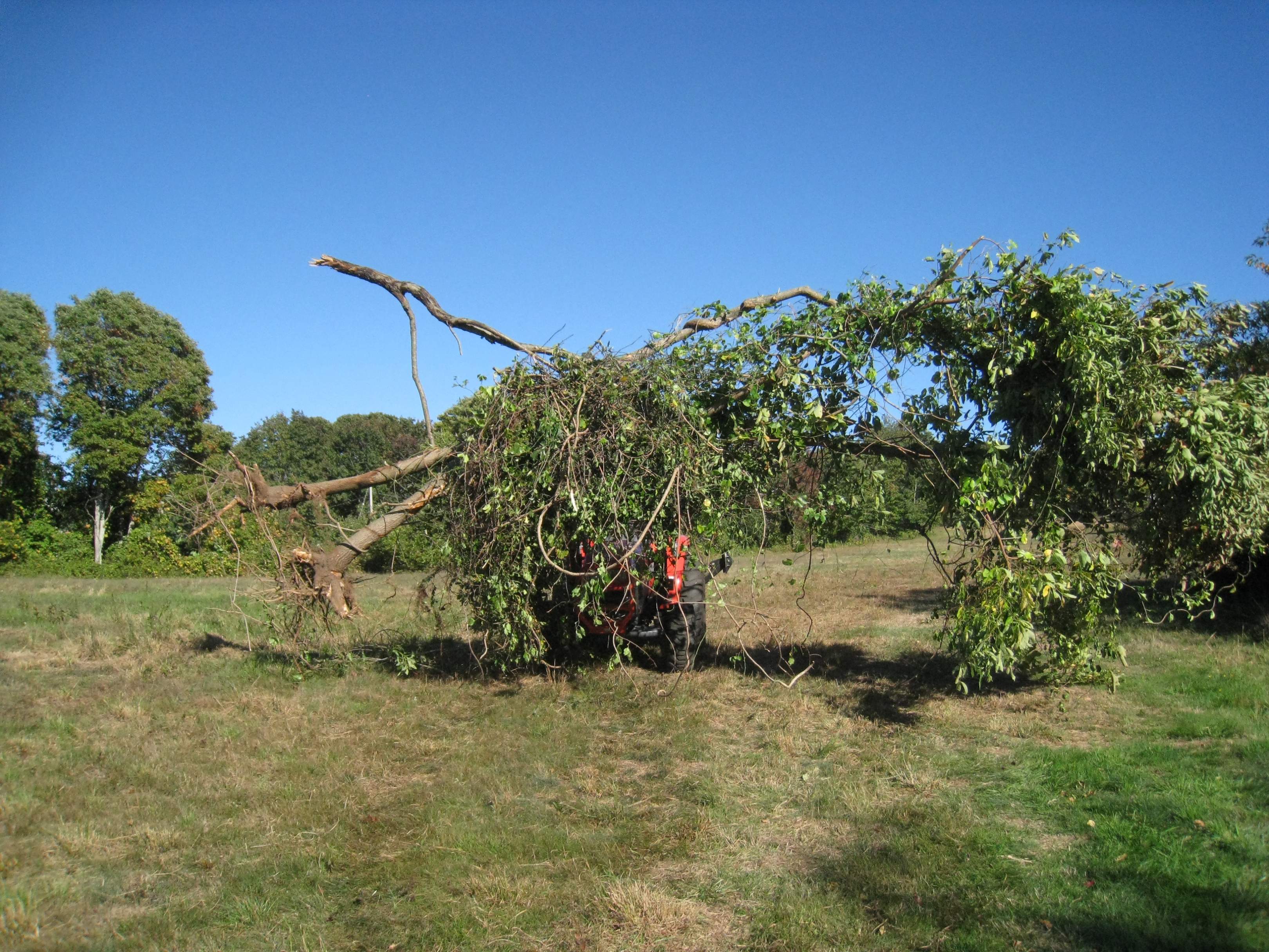

I don't disagree at all that a standard bucket can do the same job but it will take longer and leave a much bigger mess to clean up. This last point is important for me as I mount a grapple on the FEL to carry away the downed trees and that means I don't have a bucket to replace the displaced dirt in the stump hole. With the ripper technique the "hole" was really only a divot most of the time and could be ignored. Sometimes I'd just use the grapple to smooth over the area. See some of the photos I posted earlier to see the size of the hole after ripping out a tree.
I don't have a "standard" bucket. I use my bucket to carry away the tree and back fill the hole as well. 5" trees are child's play for my 45HP tractor. I recently did a job removing a 12" spruce stump. The land owner left a 3' stub for me. It took 20 minutes to get the stump out using only the bucket on my loader. I did however come back with my B7800 to do the final clean up because it is much quicker with the nimbleness and speed of the HST. Again I used "MY" bucket on this machine as well.

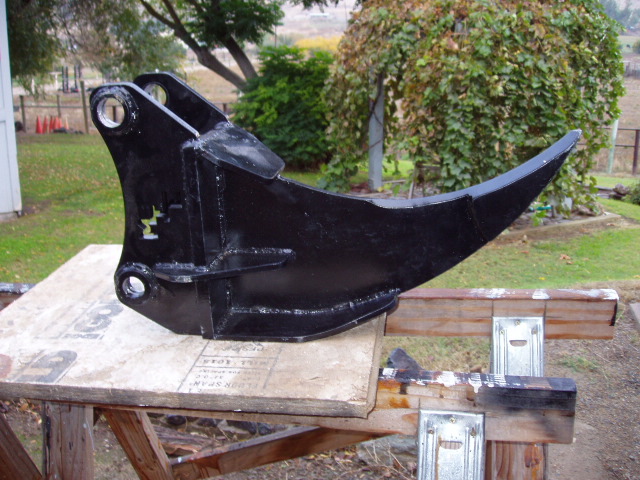

My MIE ripper tooth for the Woods BH90-X was purchased slightly altered from the original IslandTractor design in that I opted for a center cutout-free tooth. Other than that-all the same. Thank you IT for your initial design foresight, finding the right fabricator and pulling the trigger.
