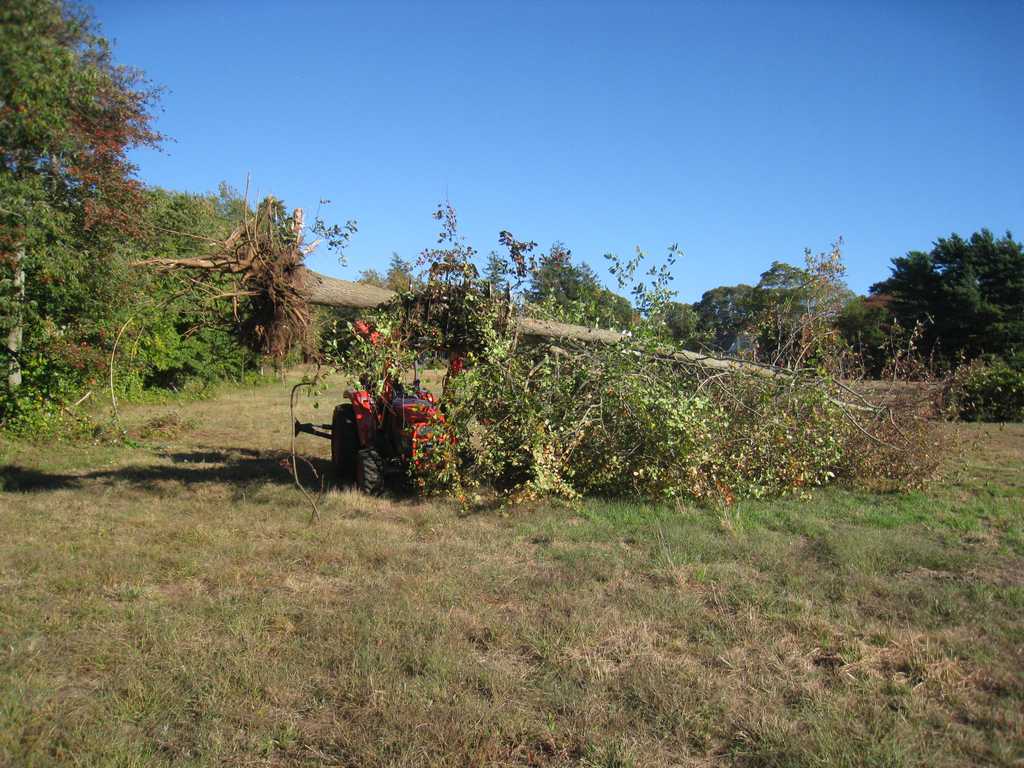

Removing trees is where the ripper excels. The ability to quickly rip the roots on all sides (repositioning the tractor once) and the to use the tractor with loader about eight feet high to push over the derooted tree is WAY faster than using a chainsaw to cut down the tree then use either standard BH bucket or ripper to remove the stump. The use of the tree's own weight to pop the stump out of the ground is where the time savings occur. I lost count but removed something over 50 trees from 4-15 inches in diameter last fall once I had the ripper. Before then I could have managed only about 5-10 in the same several day time period including stump removal.
The major limitation of this method is having 1) a BH strong enough to rip the major lateral surface roots easily and 2) having a tractor heavy enough to push over the derooted tree. Again, for up to about 15 inches I could do that with a heavy 40hp tractor and Woods 9 ft BH. While I did remove trees up to 15 inches, my tractor/BH/ripper combination was especially efficient at getting out 5-10 inch trees. Those can be popped out in just 15 minutes or so with a good amount of that time spent repositioning the tractor or hauling away the downed tree. Indeed, I got to the point that in a clump of such trees I would deroot several at once and then push them over in turn. That cut down on moving the tractor.
I don't disagree at all that a standard bucket can do the same job but it will take longer and leave a much bigger mess to clean up. This last point is important for me as I mount a grapple on the FEL to carry away the downed trees and that means I don't have a bucket to replace the displaced dirt in the stump hole. With the ripper technique the "hole" was really only a divot most of the time and could be ignored. Sometimes I'd just use the grapple to smooth over the area. See some of the photos I posted earlier to see the size of the hole after ripping out a tree.

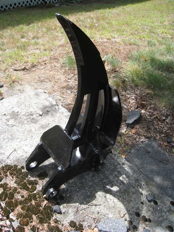

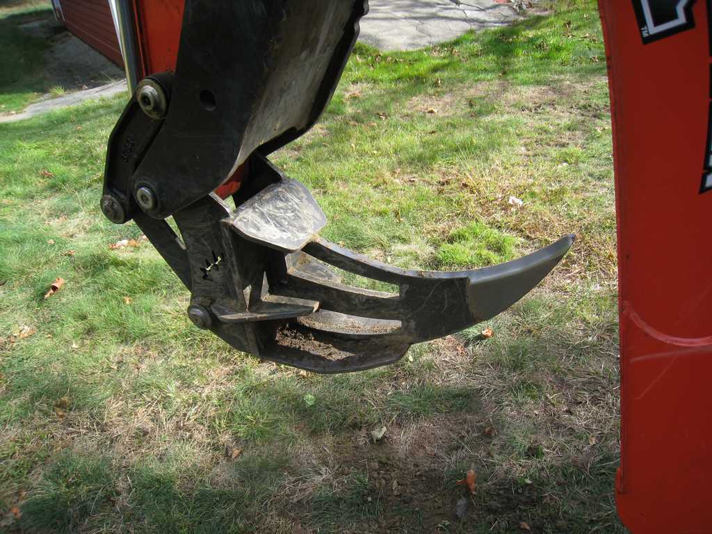

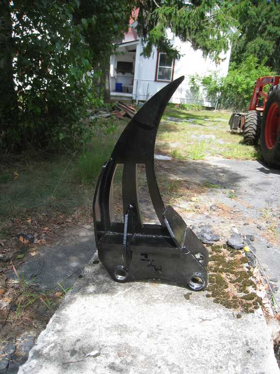

I don't think there is much doubt that the MIE ripper is heavier duty and with considerably more reinforcement than the Bro-Tek. That said, I am unaware of anyone complaining about bending or breaking a Bro-Tek so that is also a well engineered and made product. The Bro-Tek can be seen on their website. Here are a few shots of the MIE which show a considerably thicker root and much more lateral support. I don't think longevity of the MIE is a serious concern. On the other hand, I imagine it is easier to mount a Bro-Tek as it is considerably lighter. The MIE weighs about 80-90lbs and can be a handful to manipulate while trying to line up the pin holes with tight tolerances.

I like the back plate on the MIE ripper, when ripping thick roots it acts as a base to push from while curling the tooth.
My dad (pipeliner/steamfitter/welder) gave it a passing grade on quality. If it was crap he would have chopped it up and built one on his own for me.
As for mounting - it's 102 pounds - ouch - but sits in a perfect position for mounting. Easy on and off.
