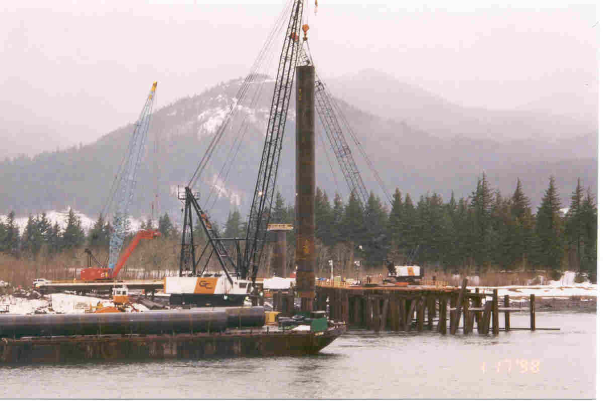

Oh I see it now, said the blind man.:D
I always liked dual shield, to me you have the best of both worlds. I was the supervisor on this project. I elected to go with dual shield to weld the 10-feet dia, 1-inch wall pipe hanging on the hook of the crane. 100% xray, I forget how many splices the guys had to make on that project.
