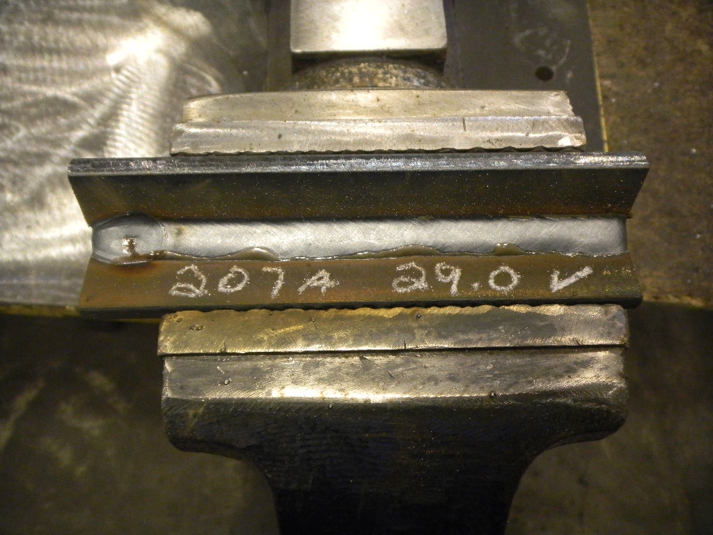

JB I'm really the last guy on the planet who should give advice on welding thin material. Even tho I worked in a sheet metal shop for 3-years, I never did much sheet metal welding. Same shop I welded up to 4-inch thick material. I feel more comfortable running hot and fast!:cool2:
This is my idea of a Mig weld, with .035" wire.;)

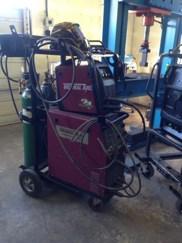

My "go to" migs are a Thermal Arc 210'(transformer) set up with .035 wire and a TA 181i (inverter) set up with .023 wire. Both have spool guns and work equally well on sheet metal. No pulse though. These types would work well for your budget, I think.
Terry

Shield Arc that is a very neat weld - I can barely make out the Cs. I never achieved that quality when I was using our tech school's MIGs. If I do a fillet weld using stick on a piece that thick, I really have to concentrate on wetting the edges and pushing up the puddle with the electrode otherwise my welding starts to splutter and I end up with weld dags and heaps of slag inclusions.
You can't make out the C's cause it's spray transfer...

You can't make out the C's cause it's spray transfer... Sent from my iPhone 5s 64Gb using TractorByNet
Love spray transfer! Wish it were possible with smaller welders. Makes you feel like a pro!!
Oh I C: D. I was wondering about the 29 volts chalked on the work. Thank you, I have heard of spray transfer but didn't know what is was about.
