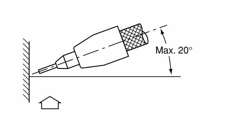

In my career I've run a significant amount more gas less flux core than Mig. Majority of that flux core wire was 5/64-inch. When running vertical up with 5/64-inch wire it is about the same as running vertical up with 5/32-inch 7018. I'm sure you will agree that is a lot of metal to push up hill. Lincoln has a technique for vertical up where you build a shelf at the bottom. You can either point the gun straight in, (90-degrees) or point it up just a little. Once the shelf is built, you pick the gun up and point it down just a touch. You lay the puddle on this shelf, once the desired puddle size is established you start traveling up hill continuing to hold that gun angle. But you have to be really careful if you are carrying a lot of iron that you work the back side of the puddle, or you will get lack of fusion at the heel of the weld! That is one thing I really like about the technique in that video, it really cuts in on the backside of the puddle. But still leaves a flat face to the weld. When running the root pass on a V-butt plate test the last thing you want is wagon tracks. Once the root, and hot pass are in generally you got it made, because you then have room to work, and you can carry a lot of iron by using Lincoln's technique.

Thanks Shield Arc, that brings up some good points to pay attention to. I may have to drag out the machine and grab some scrap pieces today. Unfortunately, yard work may get in the way. The grass is starting to grow here in Texas and it looks like time to use the John Deere.
