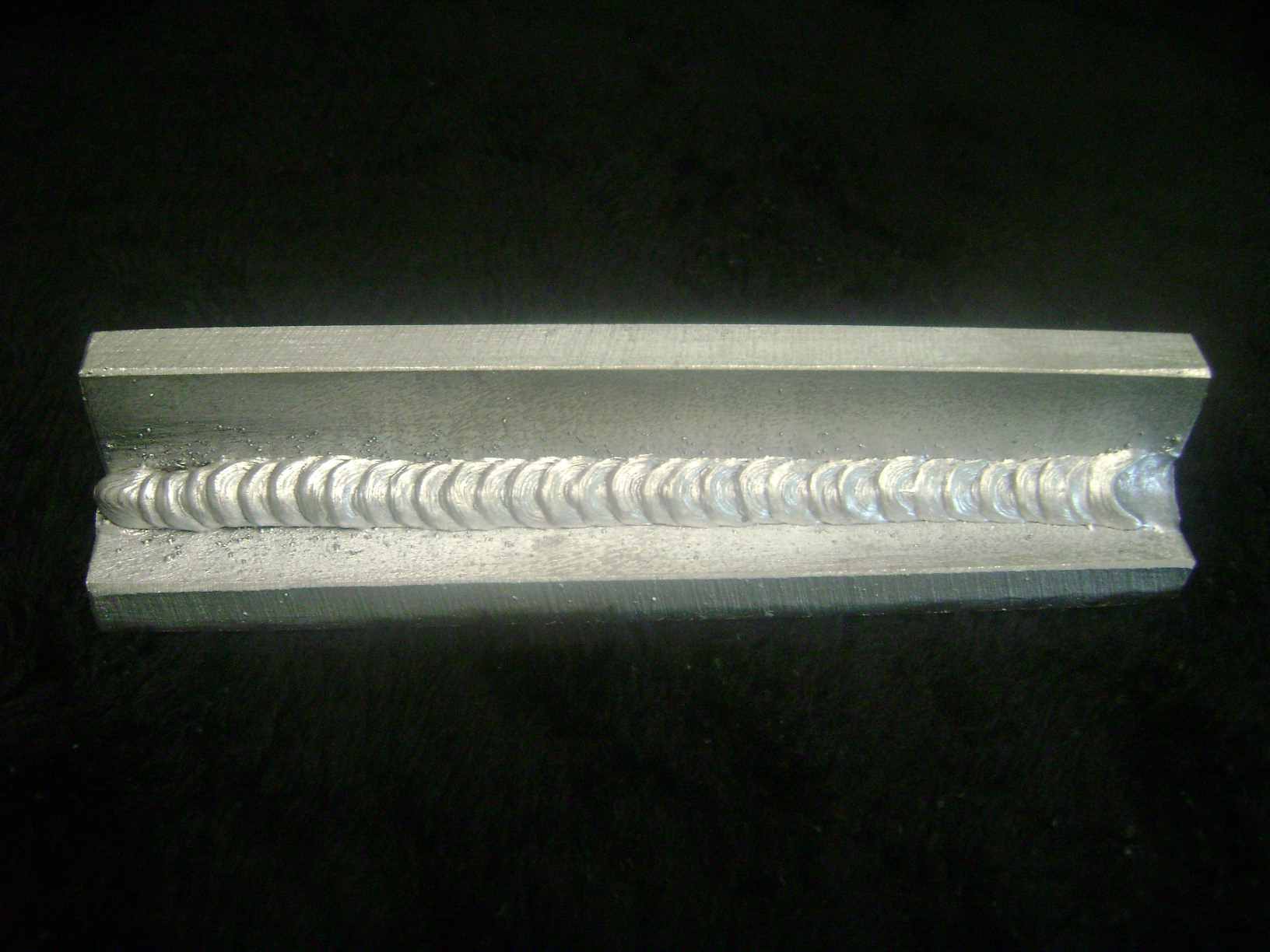

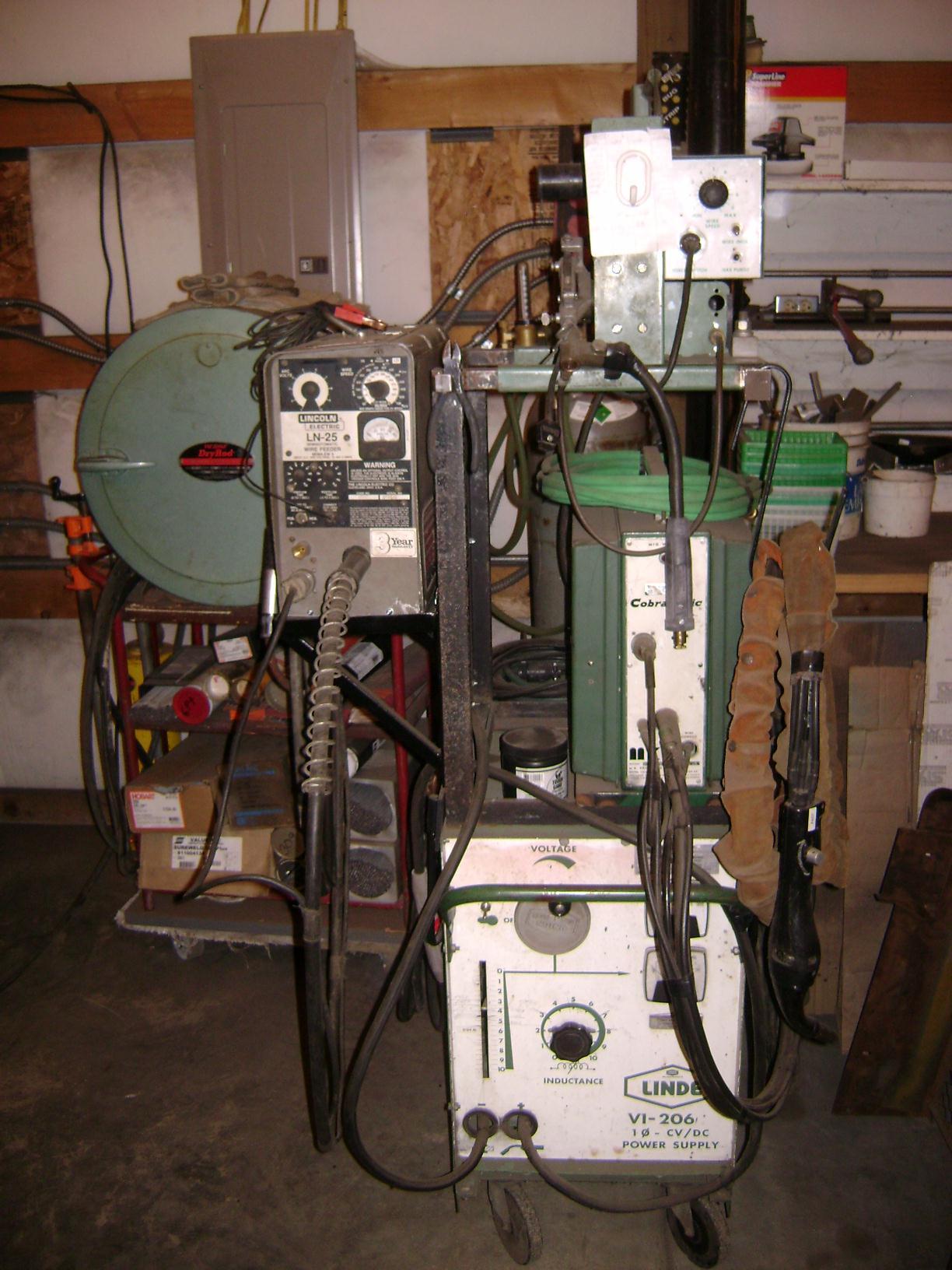

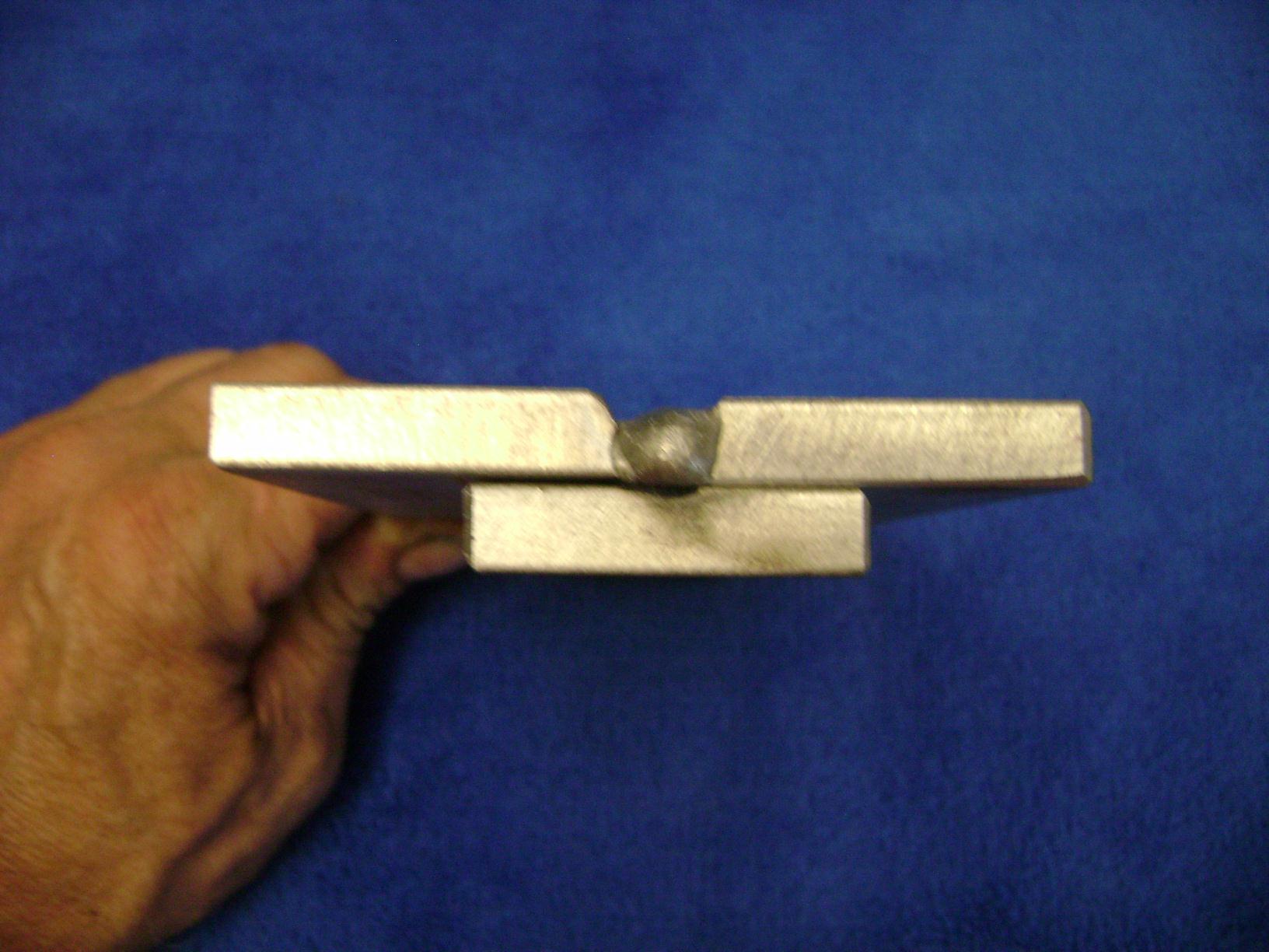

I bought a Cobramatic, (push pull) for $400.00 and run it off my $300.00 Mig machine. :D
