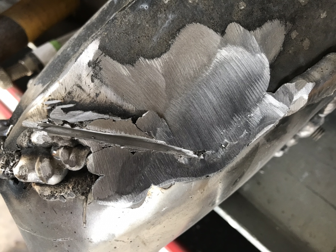

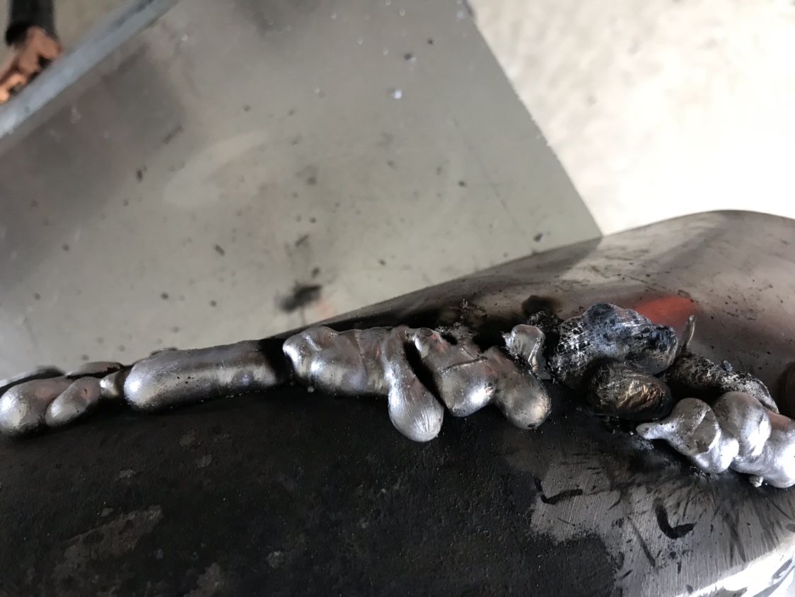

Well guys. Try 1 looks bad.
Here’s some pictures and if you can give me any tips, I’ll try again.
I was pushing with about a 15 degree slant.
I did preheat the cast with a propane torch after I sanded the paint off with flap disk.

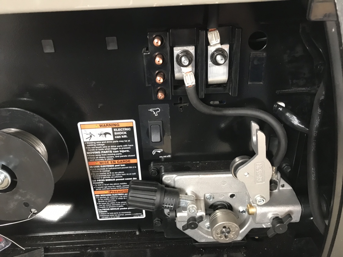

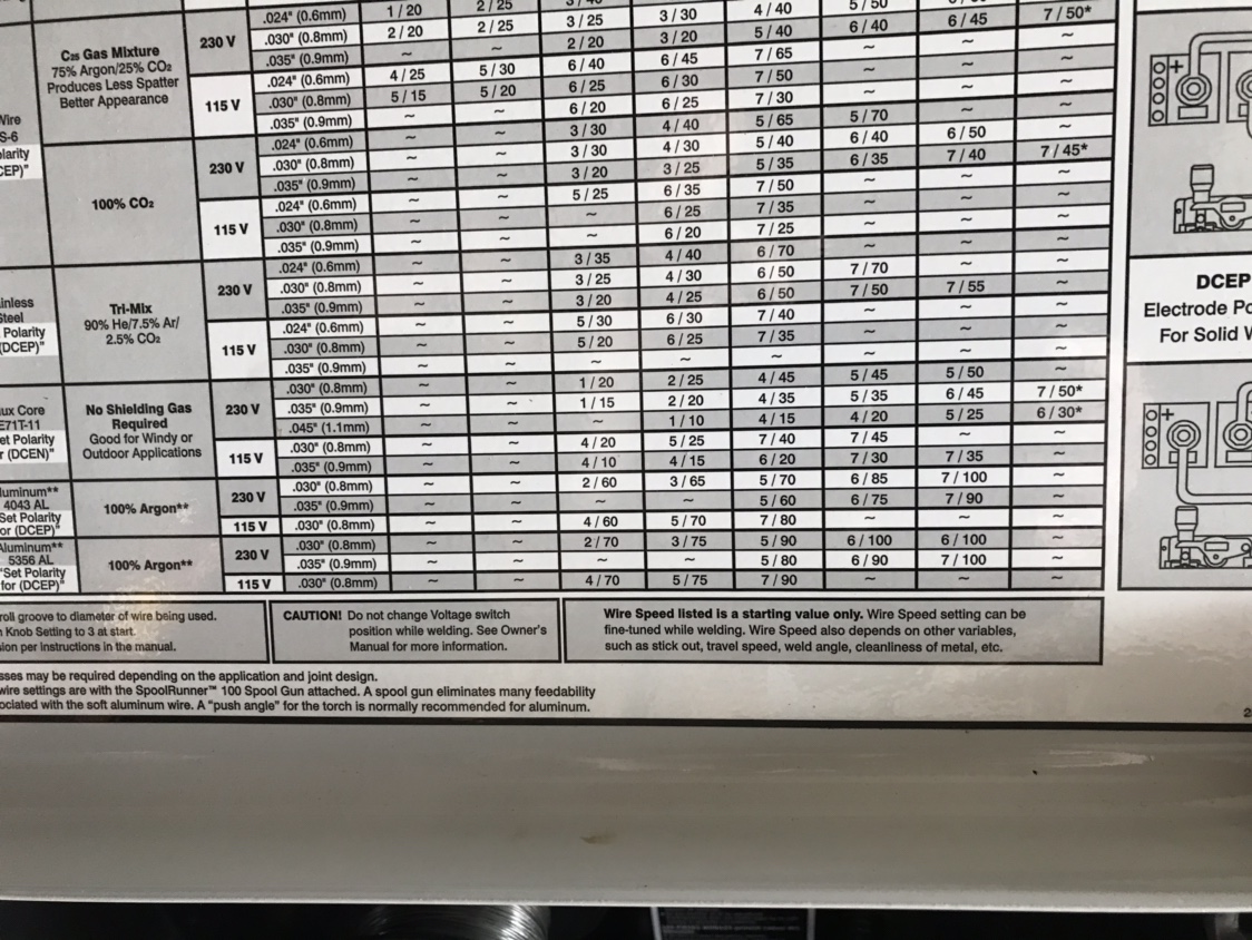

Here’s the settings I was using with .035 wire and 110v with the Spoolrunner 100. I did swap the polarity as instructed to positive.

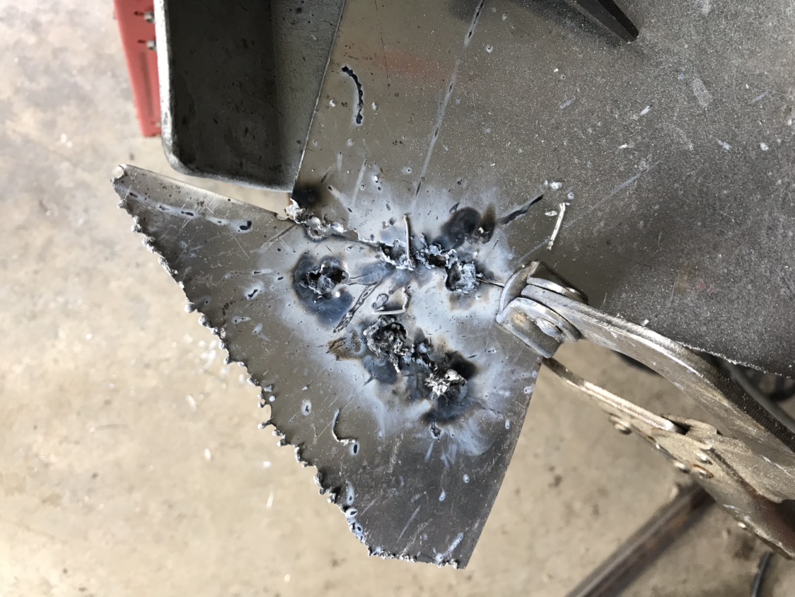

Then I thought that maybe it was the deck being cast may be the problem and without changing anything this is what happened when I tried to weld the sheet metal or even lay a bead on the surface.
Couldn’t control the speed before going right through the metal.
Under the two pieces of 16 gauge I attempted.
From one of the photos I ground down one of the blobs to see if it was cold and cut into the next one with a cutoff disk below the surface of the cast piece and it appears to have melded together. Just looks like terrible.

So did you get the Argon? If so did you get the spoolgun? If so does it have wire speed control or is it to be set on your panel? 1st thing you want to do is get a piece of 1/8" thick practice material and lay some beads. 16ga is going to be difficult for a beginner with a spoolgun. Your welds look like way too much wire.

I have the Hobart 210MVP which is dual voltage. According to the chart, 220 wouldn’t go low enough for 16 gauge so I used 110 which was on the chart for that.
Think if I switch to 220 on the lowest setting may be better?

Yes, I did get the spoolgun and the argon. It is set on the panel.

Keep the faith, You'll get it. Spoolgun Aluminum starts cold and finishes hot. Tough chore on thin material. That's why I mentioned earlier that sometimes you'll need to do a series of spots and then connect them then grind it down. Good Luck !!

You are trying to lay too much in a single pass. It is a very fast process on aluminum. Back off the wire speed by 40% and see what happens.
   / MiG welding Aluminum?? #20

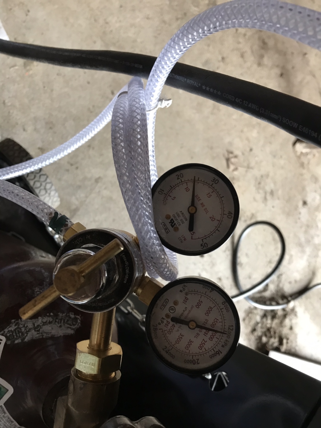

I'm no expert but your wire speed looks to be too fast, you're not close enough to the material and from the soot I'd guess your argon flow is way too low as well. Reduce wire speed and double the argon flow and see what happens.
