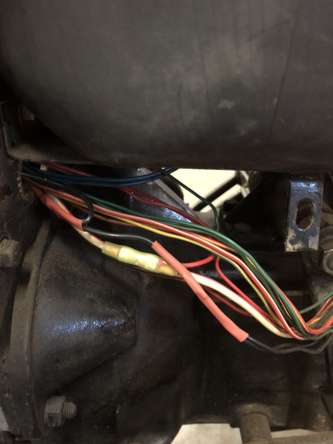

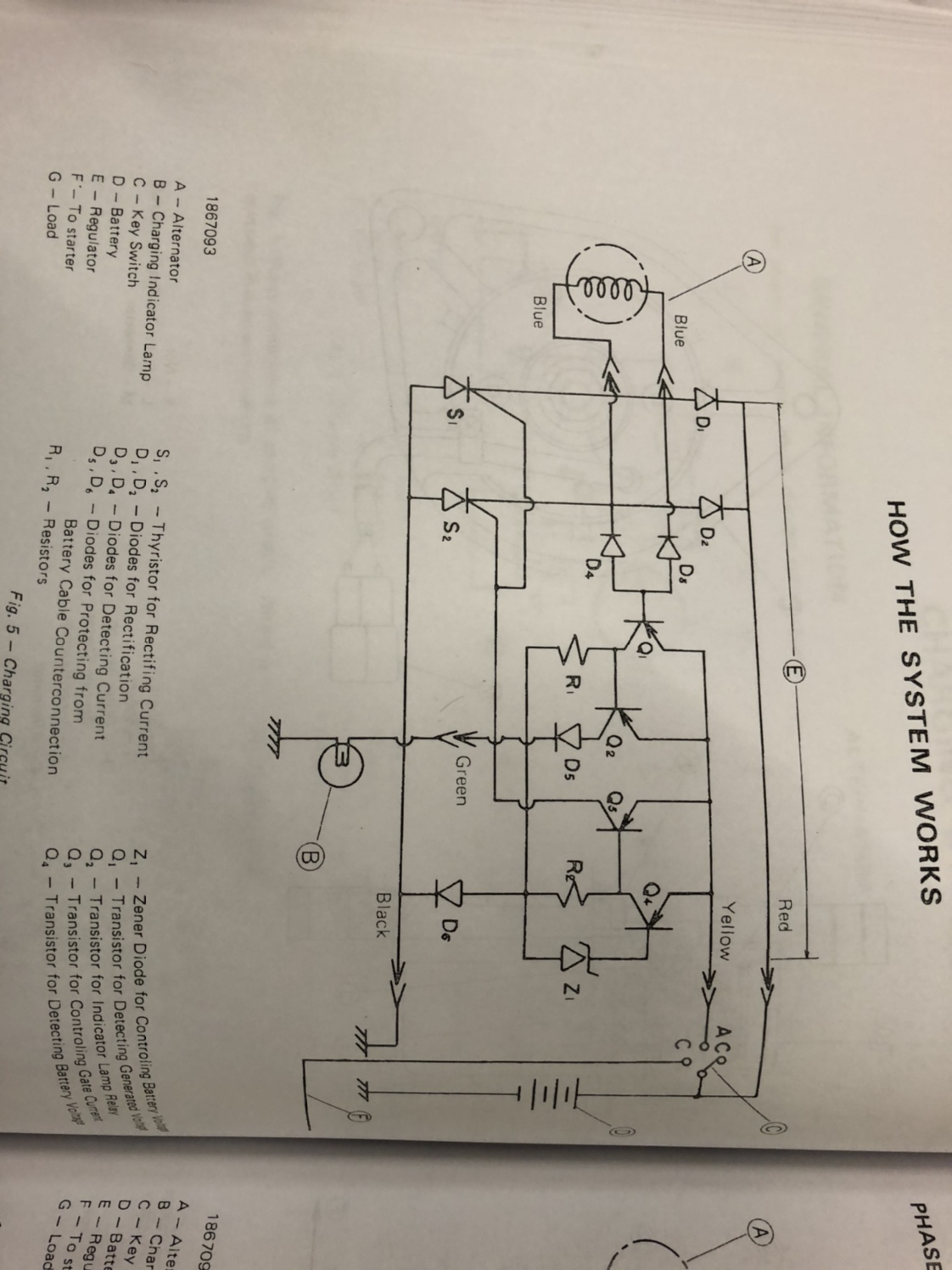

Had a chance to work on the 186D last night and ran into an issue. Installed a new generator and still have the battery light on. New voltage regulator too. Looks like I’ll be digging deeper into the wiring to figure out why this tractor won’t charge. I did notice that with the key on, engine off, the battery light doesn’t illuminate. It dimly illuminates at a low idle and gets brighter as you throttle up. I’ll have to look deeper into it to see if the new regulator is pinned correctly to the yanmar harness.
   / Might be getting back into a Yanmar #46
Hmmm...could it be a weak grounding issue?
   / Might be getting back into a Yanmar #47
Installed a new generator and still have the battery light on. New voltage regulator too.... key on, engine off, the battery light doesn’t illuminate. It dimly illuminates at a low idle and gets brighter as you throttle up.
There's some sort of circuit-test module (that didn't exist on the prior models) which does a lights test after the key is switched on. Maybe its powered from the wrong terminals on the ignition switch.
#48

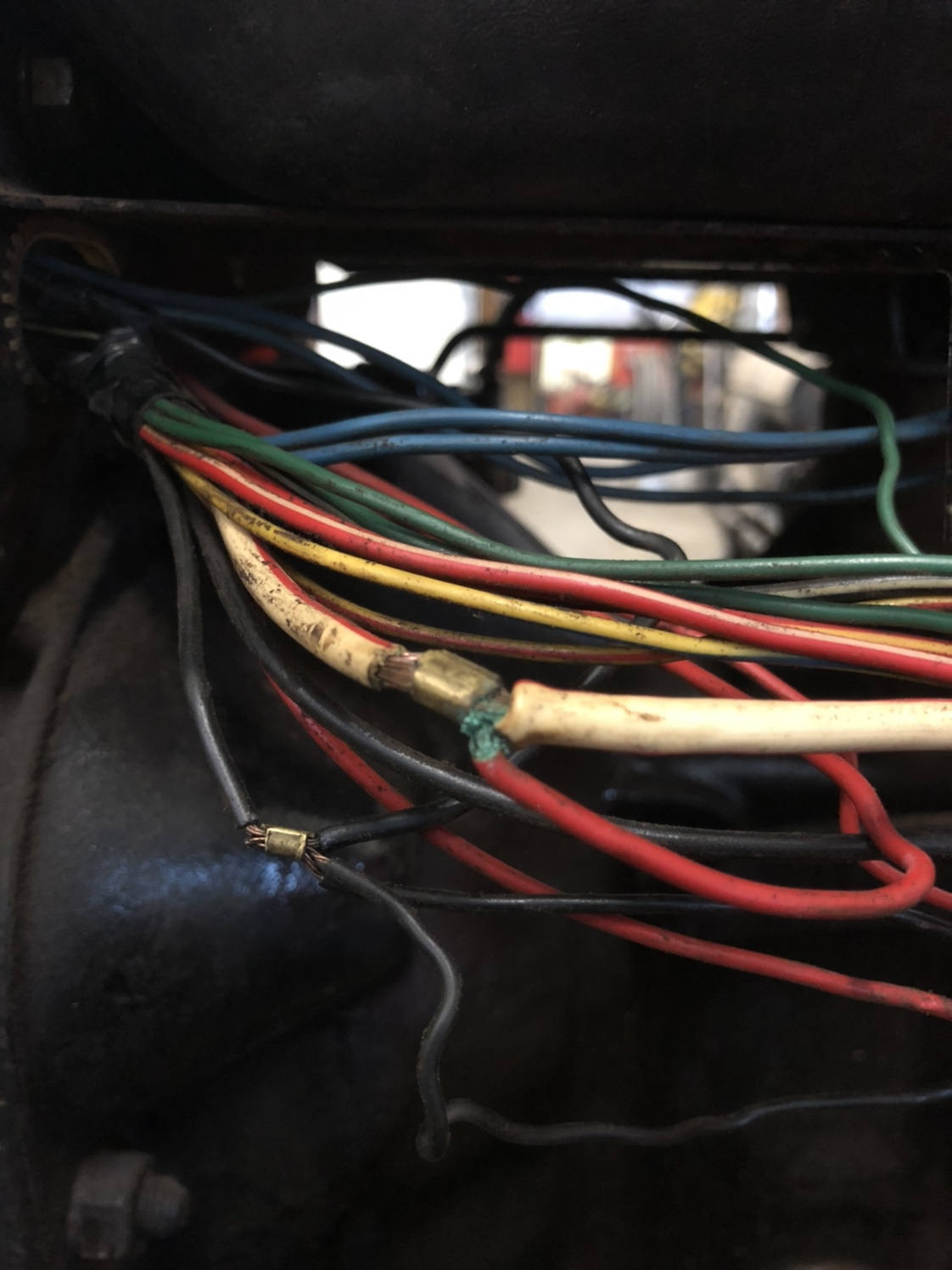

Had another chance today to work on the 186D. I had ordered a new ignition switch for the 226D and figured I’d try swapping that over. Same result, still wouldn’t charge. I traced out the wiring harness and found some bad connections. Fixed those and once again, wouldn’t charge. I tried the start run relay out of the 226D, still no change. I finally decided to try the voltage regulator from the 226D and finally, it charges! All along the new voltage regulator was bad out of the box. 🤦🏻‍♂️ Now to set aside some time to rebuild the front knuckles...
