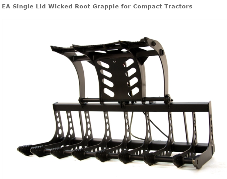

Might go do hurricane clean up...which Grapple for my DK40SE?

I found this from IslandTractor:
"A diverter valve is one of three options to run a grapple. Cheapest, if you have rear remotes, is just to use the rear remotes. I did that on my first tractor and was very happy with it. Costs only fittings and hose and a few zipties to set up and after measuring and procuring those items you can be grappling in about fifteen minutes. A diverter valve, which I have on my current tractor, is an intermediate solution. I obviously use one and it works but I'm not in love with it. Benefits are that it is a bit less $ than a third function valve and that you can feather the grapple jaw closing. Downside for me is that when I get busy I not infrequently hit the button at the wrong time and dump my grapple load. That is clearly not a major complaint but rather an annoyance. More important to me is that I don't see any particular advantage over the simple rear remote control (so long as the controller is easily reached like the stick shift in 4 on the floor). A third option is the electric over hydraulic (true third function). That will cost $600-900 and offers independent control of the grapple jaw via an on off switch. Benefit is that it is a separate control (compared to diverter) and downside is that you cannot feather the valve (on or off). My advice, if you already have a rear remote, is to simply use it. All the hoses and fittings can be repurposed later as part of a diverter or third function set up if you don't like the rear remote control. And, if you don't already have at least one (preferably at least 2) rear remotes then this is a good time to consider spending that budget on rear remotes that will have multiple uses beyond just grapple control."
Looks like I just need a pair of long hoses....thanks IT!
I put couplers in the middle near the joystick control valve so that I could take the loader off without undoing all the zipties. No big deal, but something to consider.

JD, not sure about a flat bottom since all of the stuff I will be licking up is foliage....I think.......
I have had both styles and prefer the flat bottom. This will lick up everything! :D

I bought a Wicked single lid grapple last year and am very happy with it. Good quality construction and the geometry is super for dealing with brush. The longer bottom tines get under stuff much better than a clam shell style. You can run the thing on long hoses and a rear remote but if you are going to use it a lot it is handy to have a button on the joystick. I got a diverter style from Michigan Iron and Equipment and it was a very nice kit.
   / Might go do hurricane clean up...which Grapple for my DK40SE? #18
I have a DK45SE HST Equipped with a 66" single lid EA grapple controlled with a WR Long true third function. Spent the last year and a half helping a friend clear up about 500 acres of Texas Hill Country ranch land. He shears with a Bobcat. I grapple and stack with my Kioti. Put about 700 hrs on the setup.Make sure you have a good grill guard. A three or four inch branch through your battery will screw up your day.
