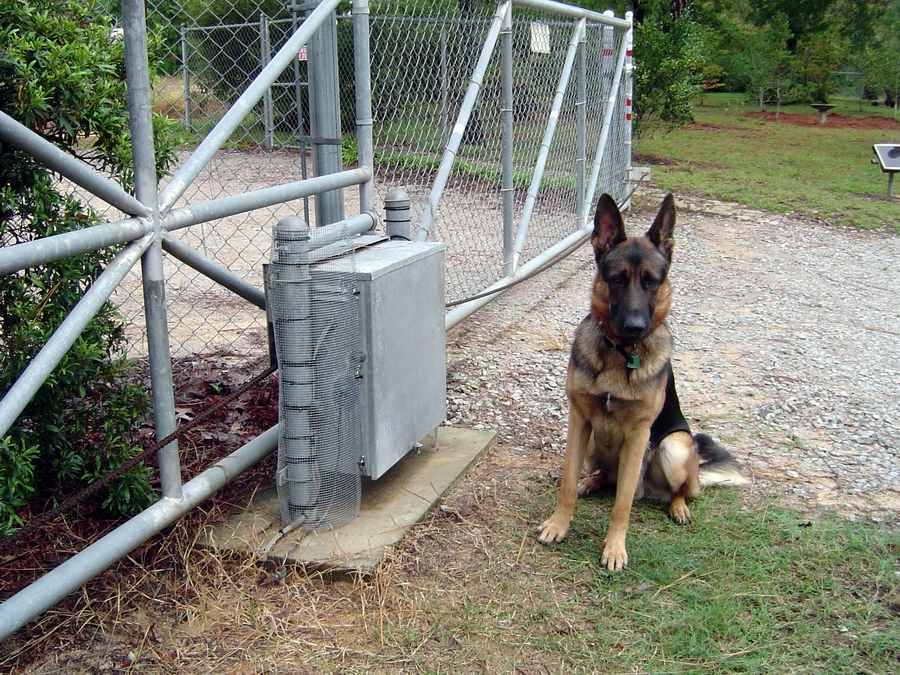

I have a couple 5 watt solar panels, each placed apart for better sunshine use around the bushes. Nothing fancy. We go out of our place sometimes several times a day and no problems. I would guess the gate weighs around 250 or 300 pounds, on rollers. I keep the rollers greased every 6 months or so, and occasionally swap out a battery. It's good to rotate batteries anyway and use them. Just letting a battery sit is not good. I just get a battery now and again...about every 4 or 5 years from Wally World. I think around 720 amps, deep cycle. I use them in my boats, too.
It ain't purdy...but it works! After having a gate...I cannot see ever living without one. The idea of security really goes up. We don't want to be bothered, (in the compound)...except by friends.
Any questions...just ask away. The folks on this forum have more collective knowledge than you can imagine.
