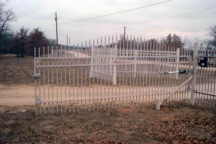

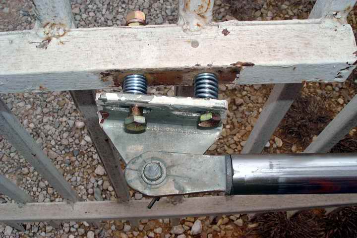

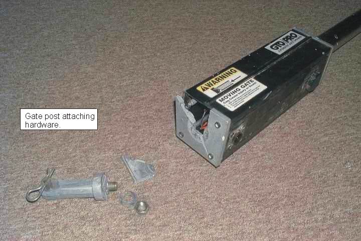

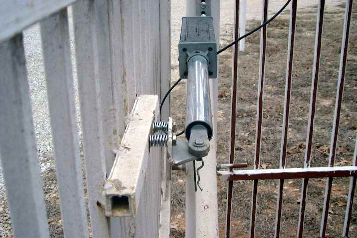

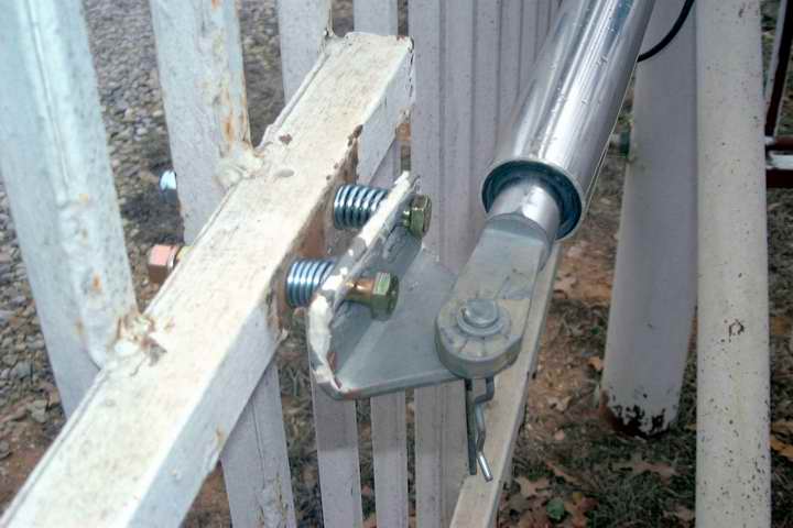

Actually, the opener belonged to my wife. It was installed on a gate at her previous address before we were married. I don't ever recall doing anything but turning the opener on/off and replacing a blown fuse. As I think about it, I think "reset" may have been turning the system off and back on. The opener was a much older model when they were called GTO Pro, before they started calling them Mighty Mule. I believe the obstruction sensor would shut the system down rather than reverse the gate, and if the obstruction sensor was set too high, the fuse would blow and you'd have to replace it. I replaced lots of broken parts on the actuator while we were dating, but I never had to replace anything but the battery inside the control box. I do know that a low battery can cause the gate to operate erratically. I found a battery online for around $24 once and it made everything work much better.
I'm including photos of the gate and how the actuator would self-destruct due to not having shock mounts when operating a very heavy gate. My fix with springs behind the gate bracket worked very well with no failures in 5 years.

We had a GTO Pro opener that's the same as a MM. The end that attaches to the gatepost disentegrated from repeated shock loading on an overweight gate. I think these little openers take a lot of abuse. I was able to rebuild the opener with just $50 of repair parts as I remember.

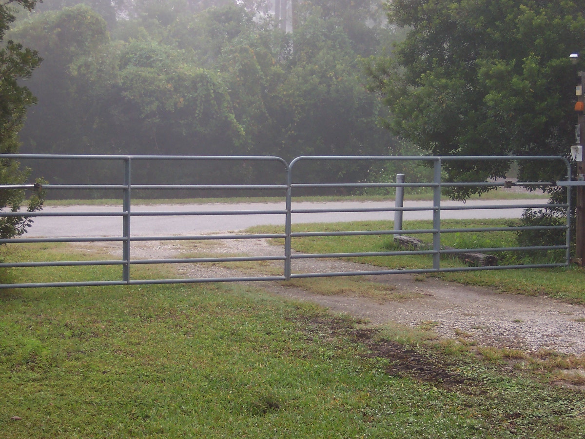

I have a double gate opener from Harbor Freight that cost a little over $300. It has been working great for over 5 years. My only problem was not the openers fault. I had problems with the remote and kept pushing the buttons and screwed up the codes. I found out from a friend that because Jacksonville had the STUPID BOWL (super bowl) that the feds were jamming radio signals during the game time.
The gate instructions are loosely translated from Italian (where the opener is made) and I am not 12 years old so I can't figure out the programing. I use the key to open when coming or going and have a push button in the house next to my kitchen window so I can see if someone is at the gate.
I have two 12' cattle gates on the opener and it is only rated for 8' solid gates. It will stop if it meets resistance, can be set up so one opens in and one opens out, has a flashing light when operating and has a lot of other features that I don't use.
