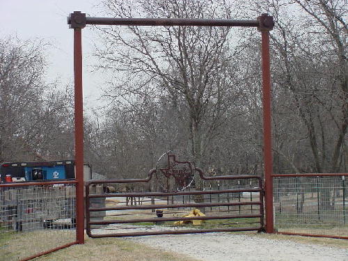

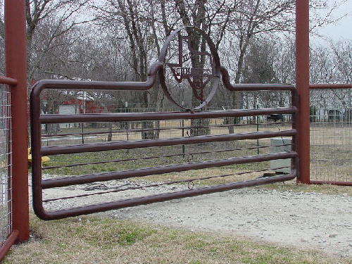

Well......, maybe, if it's collared right.
Let me explain: some years ago I had a client call asking me to check out the operator because when him and his wife got home in the evenings the dogs, great dane and large german shepard, would be out and waiting at the gate to get back in.
Just on the off chance I changed out the free exit coil but that was all I could figure to do. There seemed to be no way the dogs could get out except through an open gate and it was controlled by an operator.
The free exit coil is in a piece of pvc with coax running back to the operator control box. It's buried level in some pea gravel with a couple of inches of top soil over it so the grass can recover.
After about an hour or so of serious head scratching and phone calling back to Eric at AGS I started to leave, tail tucked firmly between my legs. I stopped outside the gate and was on the phone when I noticed the dane walk over to where the free exit was buried. He laid down right on top of it.
The gate opened and the two dogs joined me outside the gate looking back in.
It was the perfect storm you might say. I'd adjusted the free exit so the homeowner could activate it with his four wheeler. And the dane had a chain collar with about a pound of tags I swear on it. So when the dog passed it's collar over the free exit coil there was enough metal to activate the gate.
The solution was that night the dog got a nylon strap collar.
True story.
