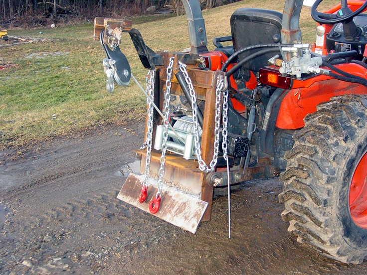

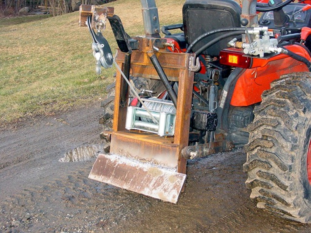

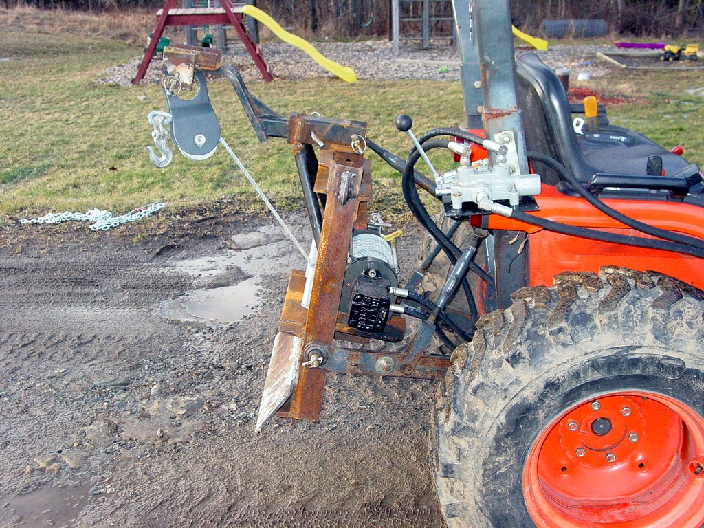

I finally finished my winch mount. Still waiting for winter to set into Maine. There is not much frost in the ground and we have had enough rain to make the ground to soft for the land owner to let me on to start cutting. I did hook it up and pulled my pickup around a little. It is going to work great.
As far as the hydraulic pressures are concerned. I have found that the winch works fine and when it loads up to a stall, the relief valve will open and I definately know when that happens. Engine speed does affect the speed of the winch. The winch is a two speed winch as well.
I feel this is a good alternative for a small tractor compared to a logging winch at $2500plus. I have a B7500 Kubota(21hp@engine,17hp@PTO). I have about $1100 into this project and that does include the new winch. I would have had some more if I had to buy all the steel, but I cleaned out some of my scrap pile for this.
The only thing different I would do is to use square stock instead of the channel iron.
A good sand blasting and paint will happen this coming sommer as I do not have a heated garage and wifey would shoot me if I did it in the cellar and stink up the house.
Can't wait to really try it.

You have a good idea going there but a few other things to consider are that you will probably hook the choker back a foot or so on the log. Will this allow the log to hit the winch. Also if you can find a way to mount the Fairlead about 10" from the winch it will act almost like a level wind. Also if you bought your winch from winchsplus.com you probably talked to Dave, a very knowledge man.

I planned this to put as little weight onto the 3ph as possilbe as to maximize the lift at the log instead of on equipment. I am estimating the weight of what I built at 125lbs and if I remember the spec numbers on my 3ph, that is about 1/7th of the lift.
I do not plan on using the winch cable for skidding, just to pull the logs to the tractor. then I will rehitch the chains to grab hooks on the receiver the I welded there. and use the low part as a butt plate. I am thinking of adding a 'D' ring or something like that so that I can rig a 2 point pull on the bigger logs. I have alot of red maple to haul.

I am not all that experienced in dragging logs but you aren't going to actually use the snatch block as mounted are you? I mean it would surely pull the tractor over backwards. I assume it is a convenient way to haul it.
I couldn't be sure from the pix but isn't the entry point for the cable (in the middle of the fairlead rollers) above the center of the rear axle? So if you ran the cable (without the snatch block) to a log and took up a good strain wouldn't it try to pull the front wheels up off the ground and rotate the tractor around its rear axle and dump you upside down if you didn't shut down? I'm sure you would shut down before disaster struck but why not mount the winch lower?
I'd be concerned that I would lose positive steering control while dragging a heavy log.
