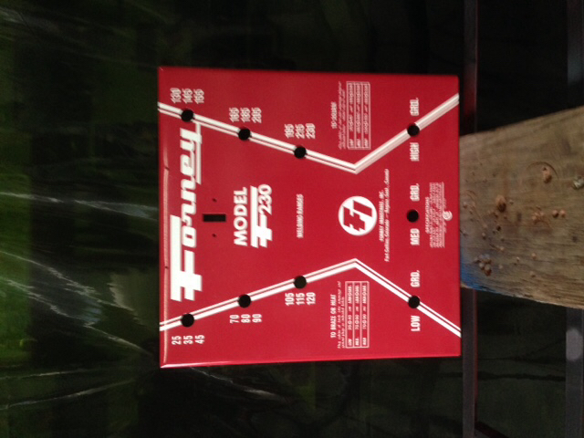

Yes it is. I bought it and the Victor torch beside it, at a garage sale in the early 90's. I couldn't guess how old they are but they are pretty tuff because they have always been in an unheated shed.
My dad bought a Forney welder from the Snap On truck in the mid 1960's for the farm.
Just finished a restoration on it. Redoing the faceplate alone cost more than the original purchase price of the welder. :D
