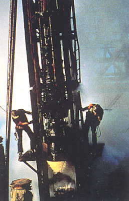

Oh I'm a big believer in the hammer! Driving piling all my life, I love to smack things with a hammer!:laughing:
Blowing out the liner of a Mig gun is some good maintenance also.;)
