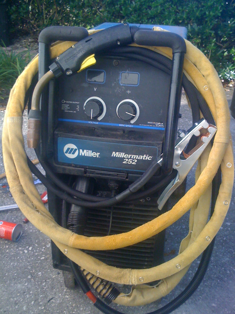

I just wanted to post a picture of it all cleaned up and (almost) ready to weld. They ended up giving me an actual benard gun for the same price of the aftermarket one they have quoted. (they did say it was a better gun, but that parts would cost a little more...I guess I am ok with that) I also included a picture of the guts of the unit (for those that have never had the cover off), I like the 'coincidence' that the capacitors appear to be miller blue. miller1.JPGmiller2.JPG
   / miller 252 for 700$ ?!? What do I need to check before I buy?? #22
Looks good!
Thanks for showing the interior pics.
