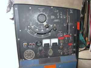

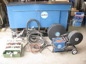

I never had that kind of Trailblazer. I had a Trailblazer 55D with an S32S feeder if I remember correctly. When running wire I always left the engine in high RPM.;)

I've heard of a couple TB 325's that had a problem with the boards or something in them. It should be covered on warranty. I had a TB 55 like Shield Arcs and ran an S-54 feeder of it. It didn't have auto idle like the newer models but if I recall , even on the newer models like Shield Arcs, you didn't use the auto idle when using CV and a wire feeder. Do you have the excel power option on your TB 325? Try it at full throttle and see if works properly.
