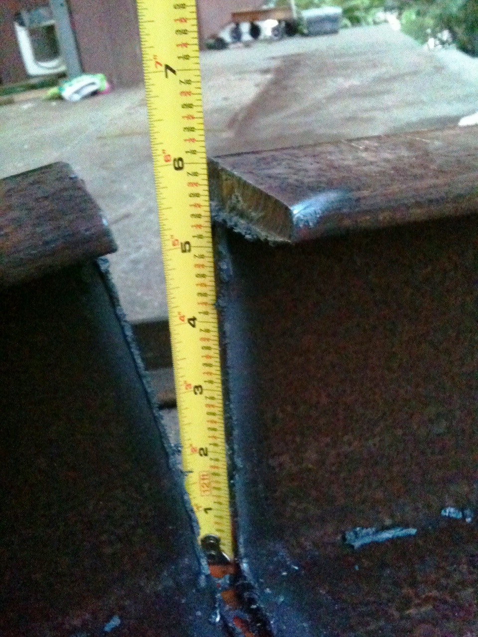

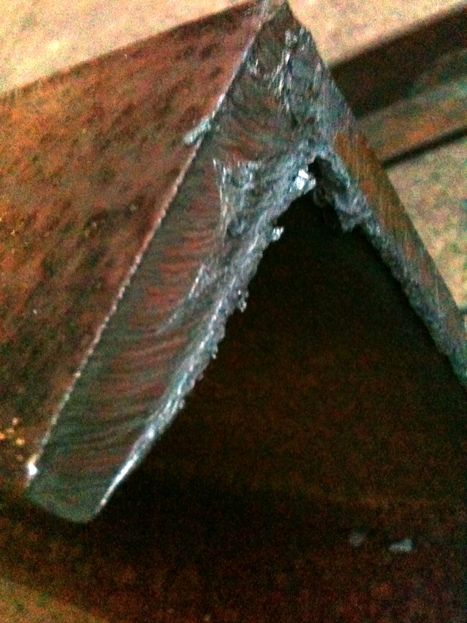

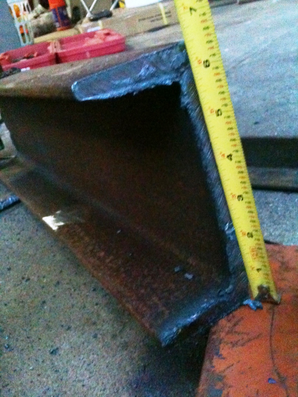

Congrats! I think you'll be pleased with the HyperTherm. I have a miller welder but got the same advice others mentioned when shopping for a plasma at my LWS - go with hypertherm.
I went with the powermax 30 because of the dual voltage capabilities and have been very pleased.

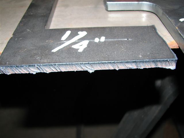

These are cuts I made the day I got it on some channel. Cuts were made on a 115V 20A circuit and I was very impressed!! Sory for the crappy cell phone pics... This was WAY outside the rating of this machine but it got the job done!
Was that 3/8 or thicker?
   / Miller Plasma Cutters #15
The sides at the base were a little over 1/2". It was slow going and there was a lot more slag left on the cut than normal but it did sever it pretty well I thought.

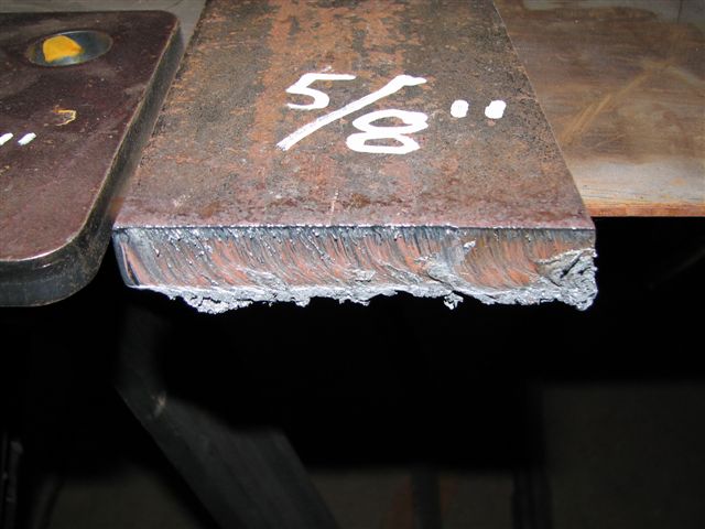

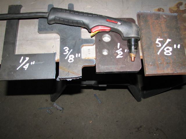

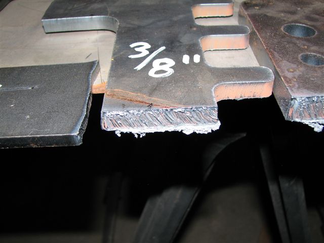

The Powermax30 is rated for maximum cutting on 3/8" and "severance" cutting on 1/2". Here is a pic of some cuts.....up to 5/8" with my Powermax30.....which is Hypertherms smallest plasma. You can count on Hypertherms machines to outperform the specs on their own brochure! The other cuts you see in the pics on the same plates were done with my Powermax45 on a cnc machine.
